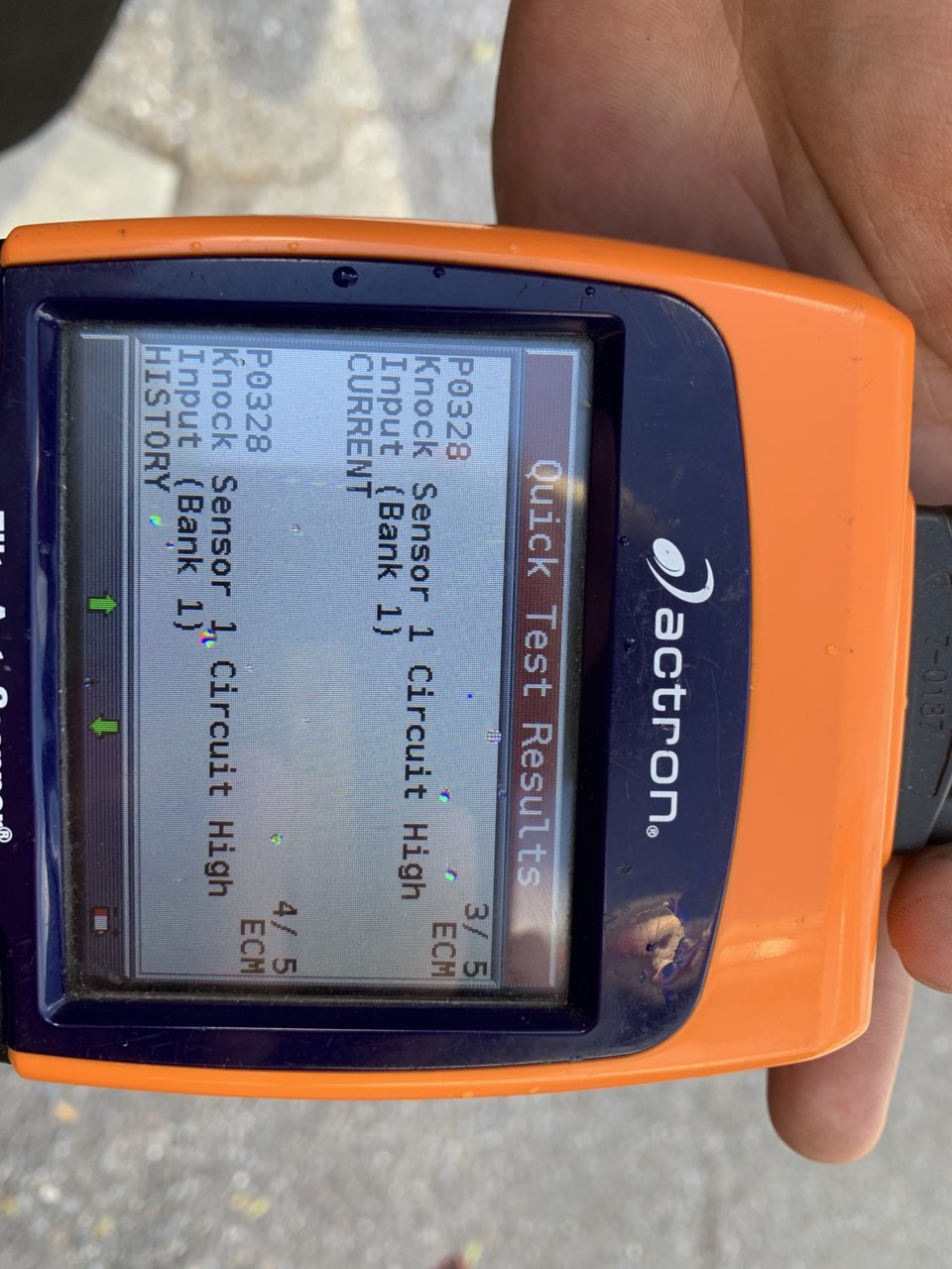

    Got a check engine light pop up on my truck today. got it read and had multiple codes:
    P0328 (Knock sensor 1 circuit High Input Bank 1)

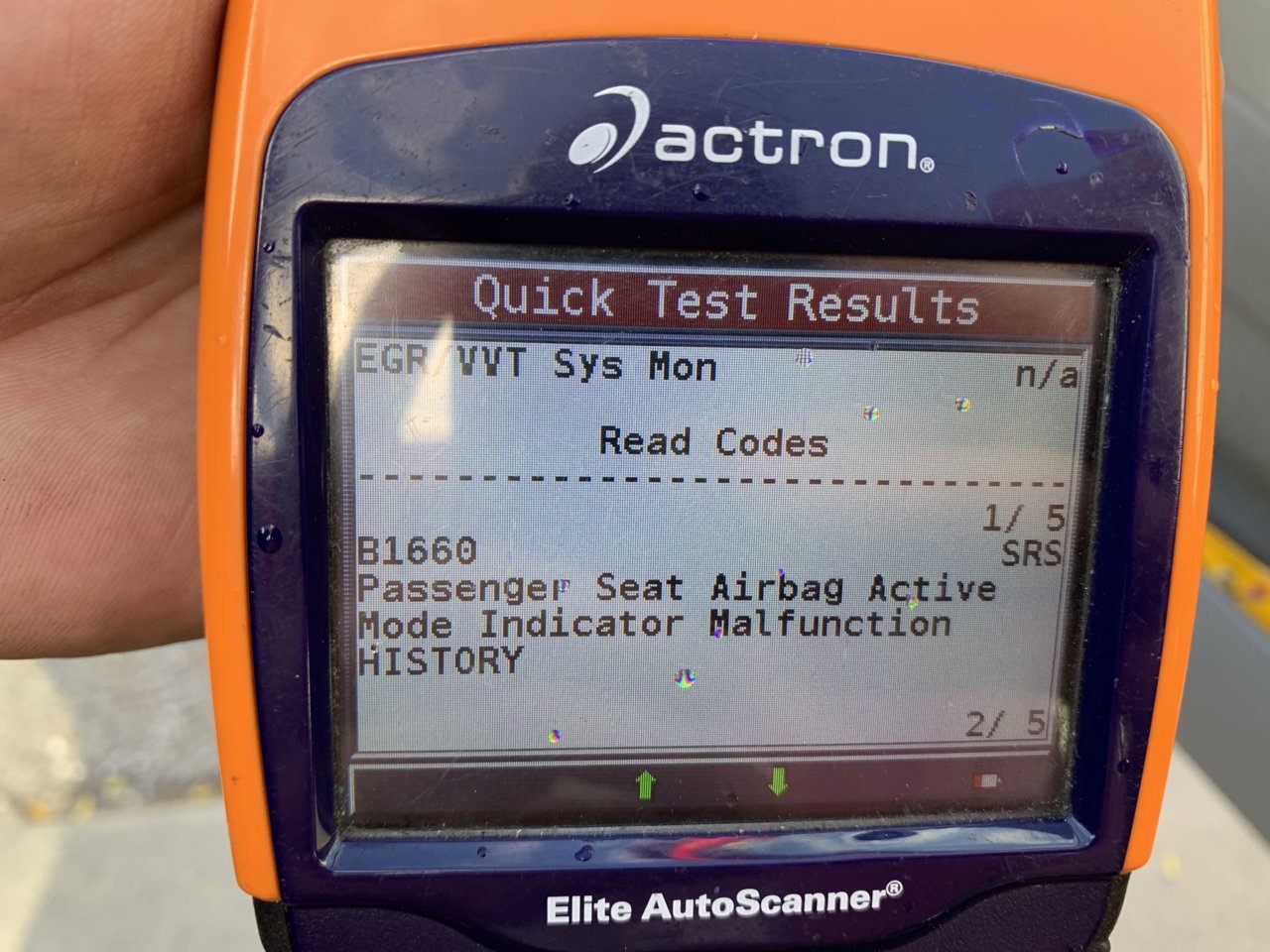

    B1660 (Passenger seat airbag active mode indicator malfunction)
    The knock sensor i have been suspicious of for over a year now. occasionally would make some knocking on cold starts but never threw a code and i couldnt figure out what was up. I tried higher octane gas and nothing changed. Im not sure what "high input" means though. wouldnt that mean that the unit sending power (ecu) is malfunctioning?
    The airbag i had no idea about, but the light does stay on for a second after i start the truck. Not sure what the code means though.

    The high input means that your ECU is detecting a higher than normal voltage coming from the knock sensor. I would check and make sure the wires insulation are good. Take the connector off and make sure the pins are not corroded. Clean them if there corrosion on them. If you can’t clean the corrosion the only option is to replace the connector. It can be a bad sensor and last would be a bad ecu.

    The p0328 is for an open knock sensor circuit on bank 1.
    It's very common for critters to chew the wires off the knock sensors, unfortunately they are a pain to get at as they are in the valley of the engine under the lower intake and water outlet pipe that is sandwiched under the cylinder head intake ports. Some members have fixed them without removing the coolant pipe assembly but it can be removed if the brackets that hold them together are cut.

    The B1660 is a problem in the passenger airbag on/off light circuit, most likely a broken/corroded wire or cracked solder joint in the warning light assembly.

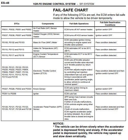

    thanks guys. i assume if i pull that water pipe off i will need to drain the cooling system? probably would be good to flush it anyways...
    sucks this happens as soon as i have 0 access to a shop and very limited hand tools at school.
    will i damage anything if i continue to drive for a couple weeks until thanksgiving break when i can bring it back into my shop?

    Yes you will have to drain the cooling system, no you shouldn't damage anything although the ECM will retard ignition timing and thus reduce power and fuel economy with that code present.
