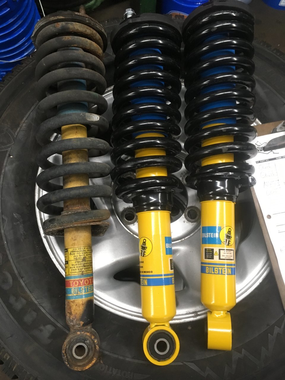

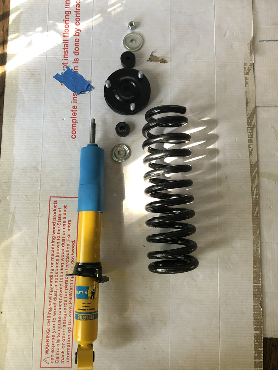

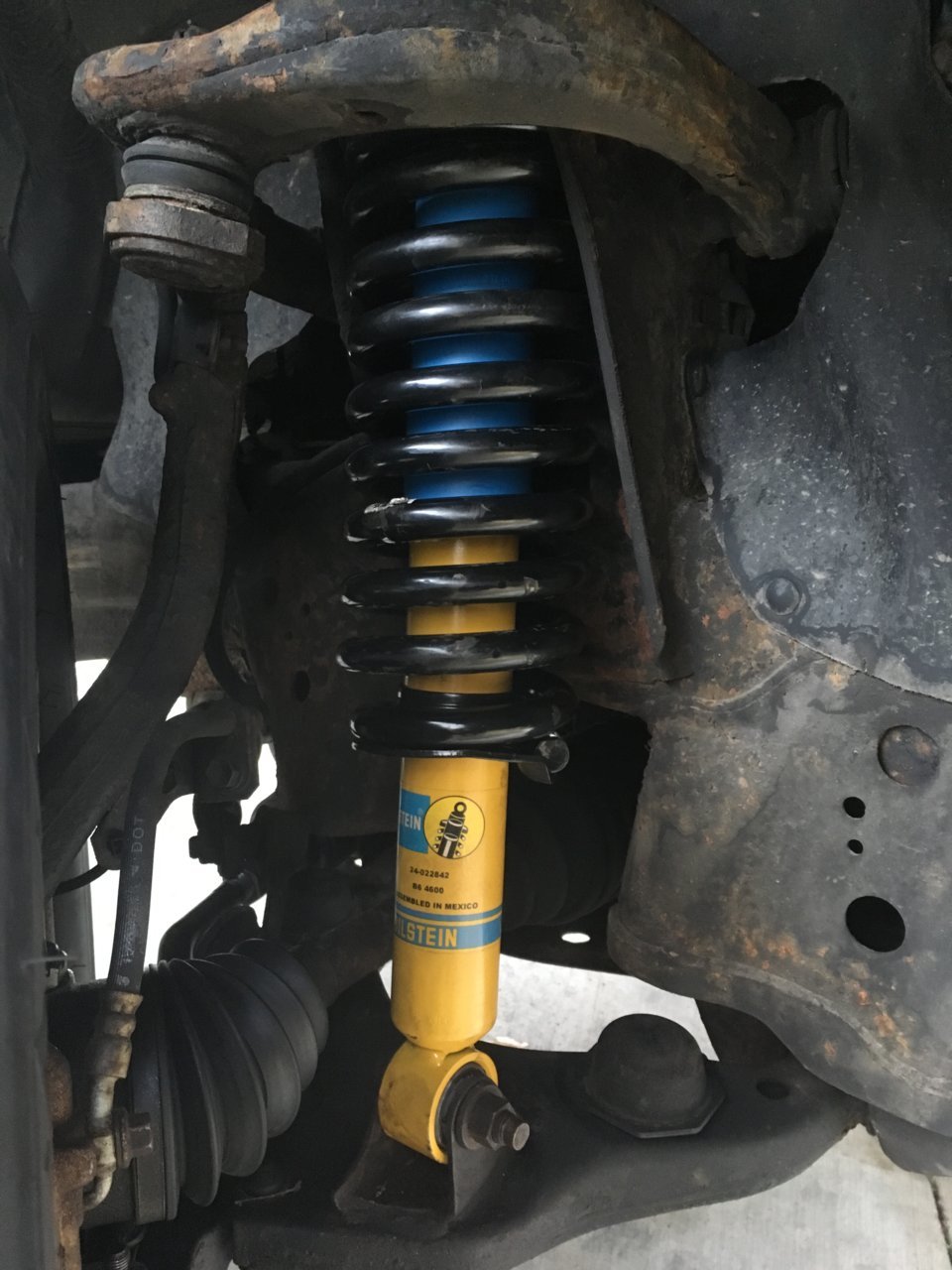

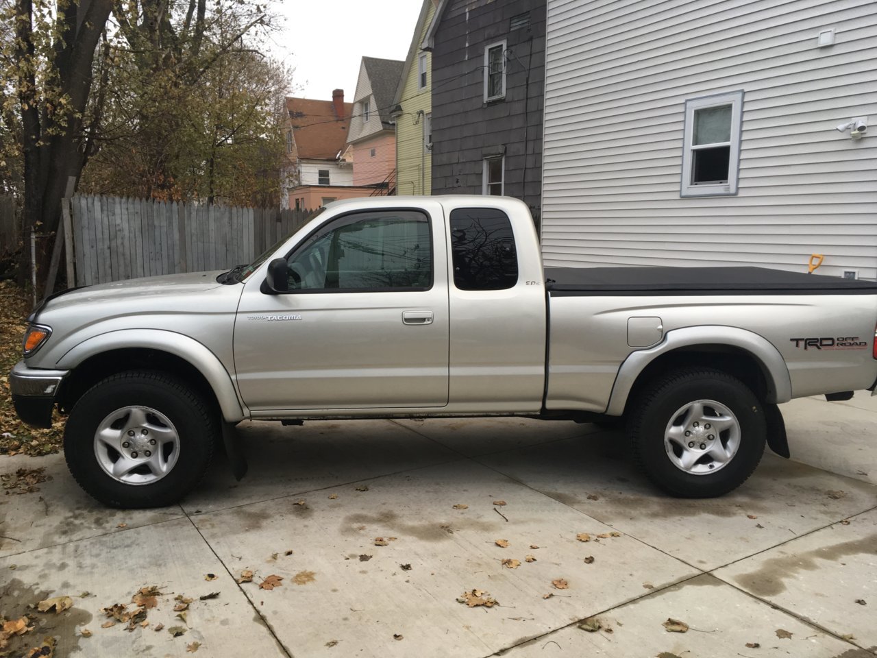

    Just installed new Moog 81104 coils with Bilstein 4600s. Assembled with new Moog tophats and Wheeler's bushing set. Reused the the lower bolts. Attached pics of old and new.
    Can I expect the front coils to settle? I wasn't expecting much if any lift with the Moogs.
    I have yet to install the new rears, so I anticipate some leveling out, but I'm surprised at how much higher the front sits.
    Also hearing some squeaks (starting to subside), but can I expect this to linger on for awhile?

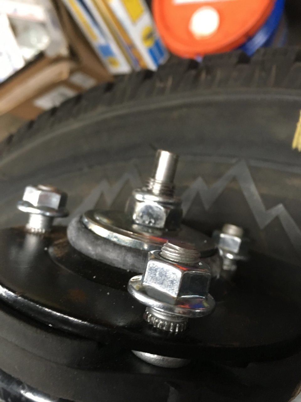

    Pretty sure your spring perches are up-side-down...

    omg.
    thanks.

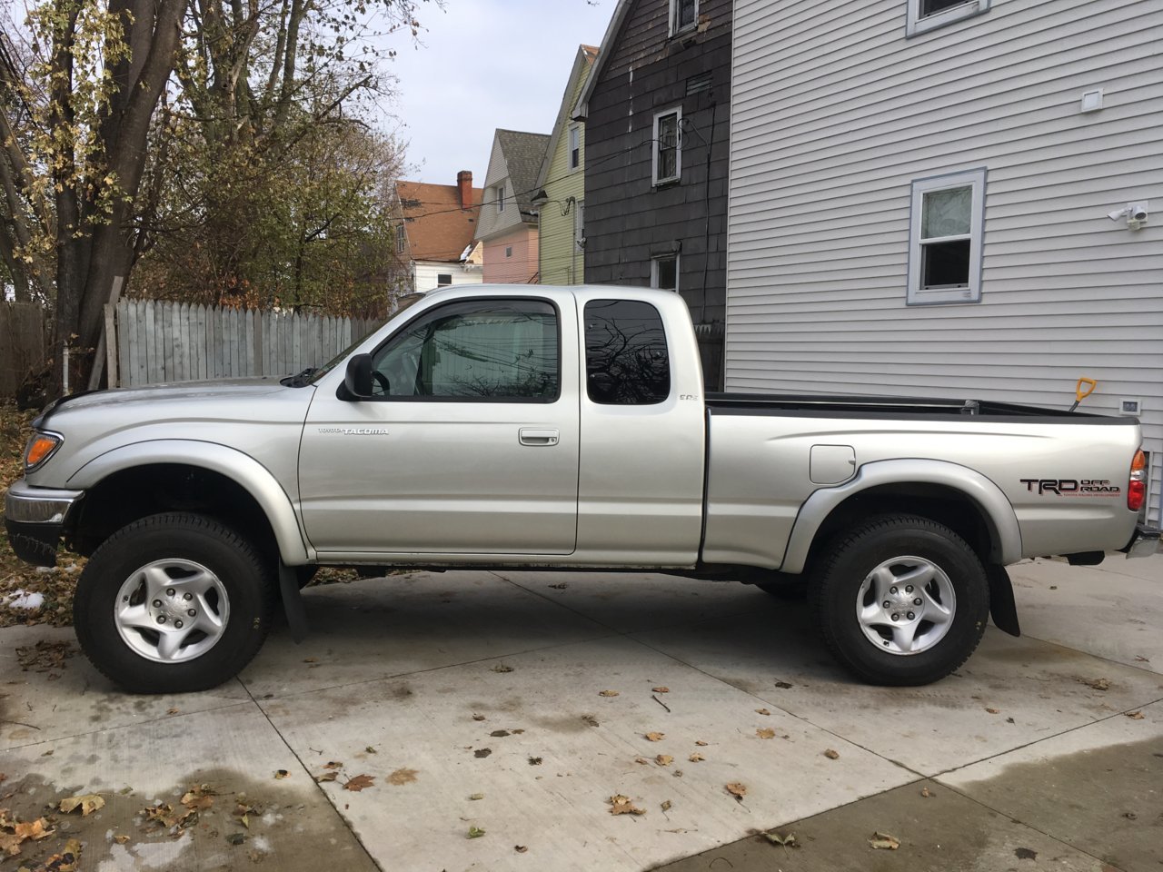

    All better.
    Thx jbrandt for the assist!

    Hey guys, I'm installing the same set up, 4600's, Moog top hats and Wheeler bushing set, one question though, is there a third bushing that goes into the Moog topcoat? on the parts blowout it looks like I'm still missing the part numbered 48510C, is that also something I need to order? Can't seem to find anyone mention it in their threads. Thanks for any information! Screen Shot 2022-10-08 at 12.04.42 PM.jpgIMG_8465.jpg
  18. Oct 8, 2022 at 9:34 AM
    #18
    Bishop84
    Bishop84 Well-Known Member
    Dec 17, 2015
    #172494
    11,897
    That's a line up washer, it's not critical and the bottom cushion will center it self.
    Take a look at how the cushion seats inside the bottom of the top hat and see if it would cause any issues to skip the one washer.
    I've skipped it on my own trucks before, simply due to offmake vs oem issues.
    Not ideal, but sometimes you just wanna get stuff done.
