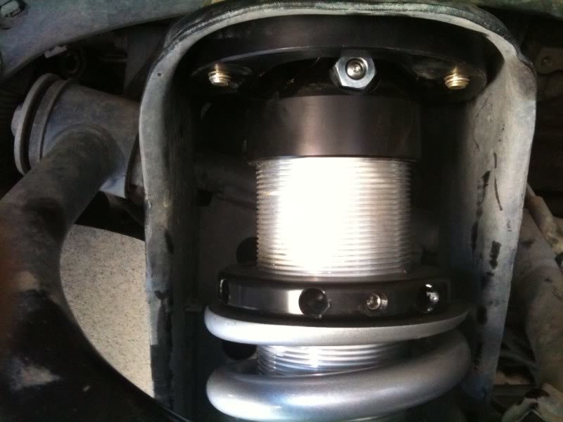

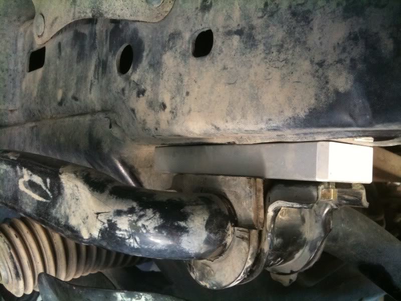

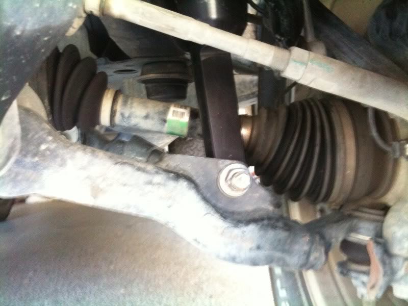

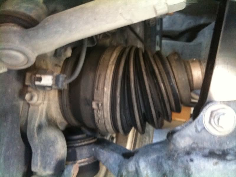

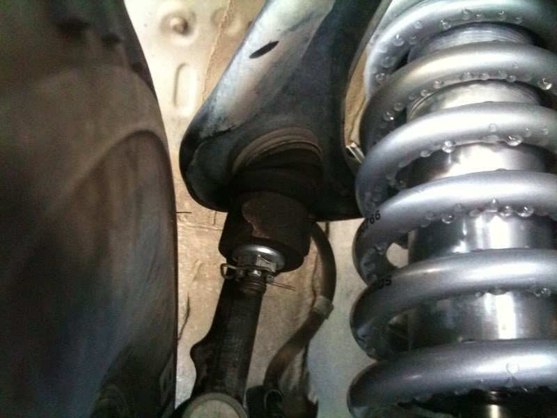

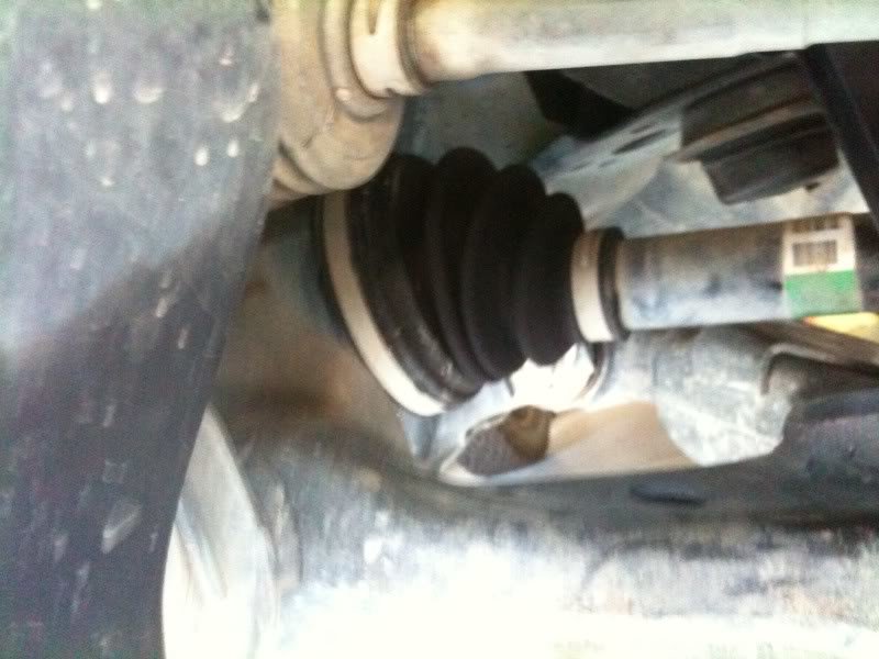

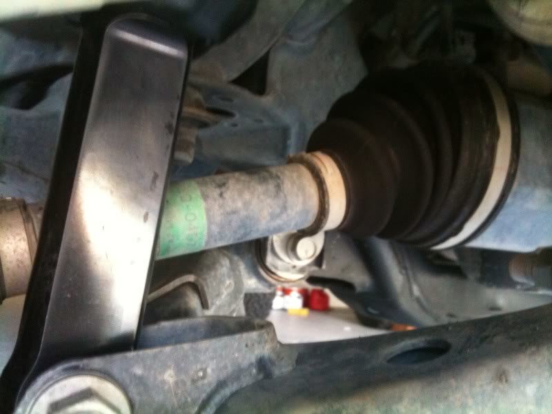

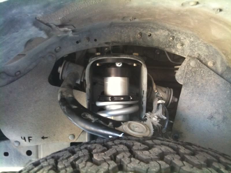

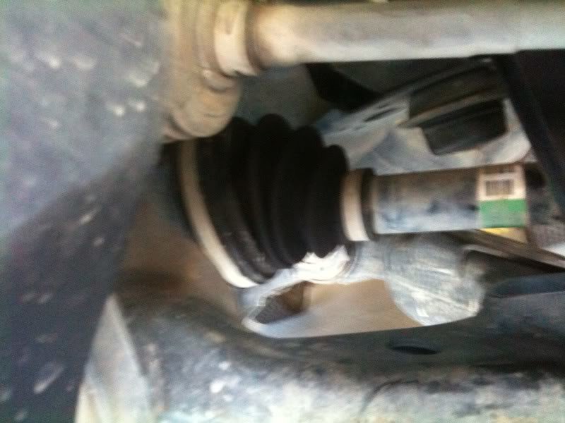

    I installed new coilovers and am getting multiple popping noises when starting to move from a stop. I re-torqued the following:
    Lower Shock Bolt, Sway Bar end link.
    I can't re-torque the following due to space constraints so I just tightened as much as possible:
    3 top bolts
    I didn't torque the castle nut for the ball joint because Chris4x4's write up didn't list a torque setting, so I just tightened it.
    My measurments are:
    Front Drivers: 24.25
    Front Pass: 24.5
    Rear Drivers: 24.5
    Rear Pass: 24.5
    Here are some pictures of the front coilovers installed, CV's, and UCA's:
    Also a possibility that their cranked to high so I don't know if that's causing it.
    Any ideas?

    Can we get photos of the COs and the CV boots??

    If you have them cranked too high, when you accelerate the front comes up and not having any downtravel left means the front pulls up at the end of the c/os cycle = pop?

    OK, I added pics....any ideas? I'm getting the spanner wrench on Tuesday and will lower the front about an inch

    You have them way to high. The leepers come adjusted wrong. You need to adjust them to where there is about 7/8" thread showing (for 3" lift, less for a 4x4).

    The ball joint gets torqued to 81 ft-lbs.

    Sounds like you have them cranked up to high bro. My buddy had the same problem when he put his SAW's on. He cranked the hell outta them for lift. But didnt account for the downward travel. Bring them down about an inch ( dont know what size tires your running) and you should be alright. If for some chance it doesnt go away, have someone drive your truck slowly up onto a curb or some type of bump, walk along side your truck and see if anything is binding, especially around your swaybar... Hope it helps out.

    If you didnt adjust the Leepers down to about 1" thread above the adjuster, You are over 3" lift. FWIW, 4x4's need to stay about 2.5" lift.

    4x4s arent really supposed to go much past 2.5" b/c of CVs.
    also, you should always torque down all bolts. when i installed my spindles i didnt have a torque wrench handy so i just cranked down the lower ball joint holder. started to get poping noised at full lock...yep, they were still loose enough to barely move. torqued them down and the noise went away!
    oh and ...got downtravel?!! that upper ball joint is screaming for mercy!!

    OK. I took new measurments after dropping down:
    Old:
    1.75" of thread showing =
    FL - 24.25
    FR - 24.5
    ^^^Center of hub to bottom of fender
    New:
    1" of thread showing:
    FL - 22.75
    FR - 22.75
    The noise seems to be gone now but will know for sure tomorrow morning when I usually hear it.

    Oh, and how do you touque that castle nut down? I mean there is a hole that needs to line up for the wire pin to go through...I doubt it will line up exactly at the correct torque...

    I either torque it to the correct setting, and back it off to the hole for the cotter oin, or, if its close enough, I turn it to the next hole.
