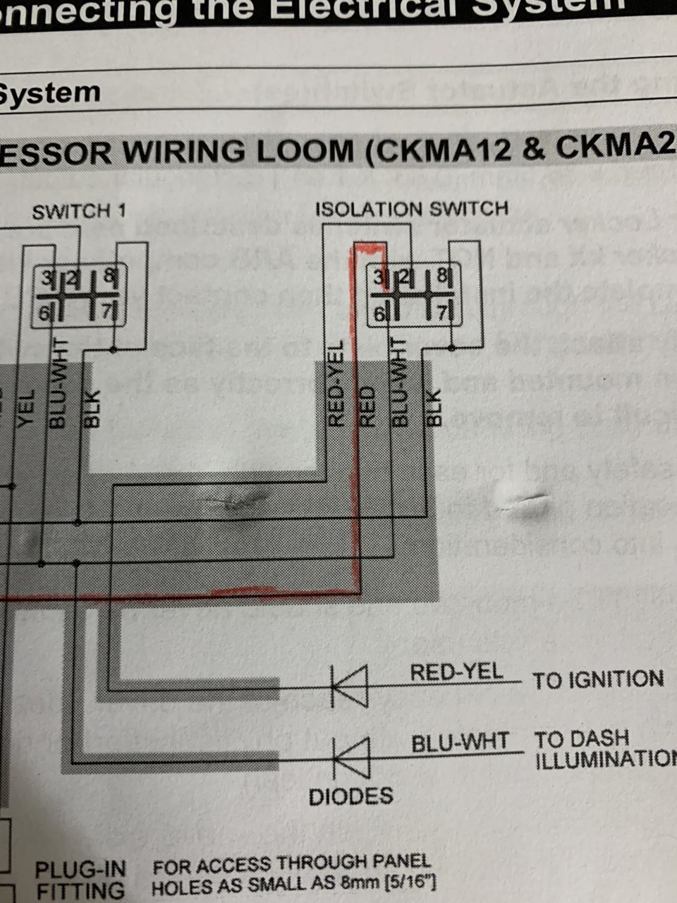

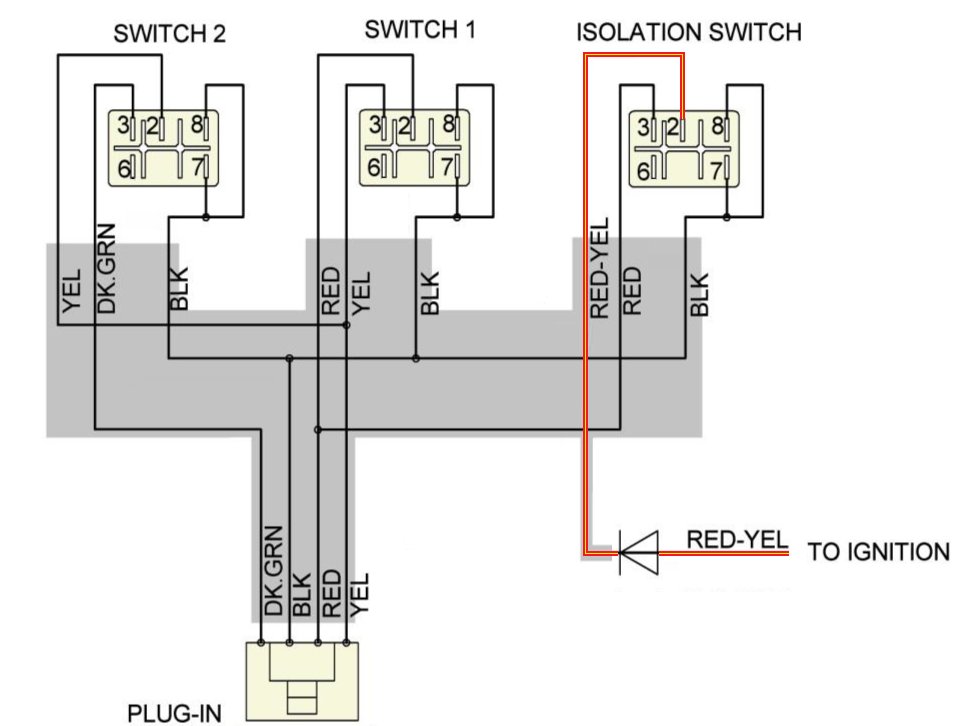

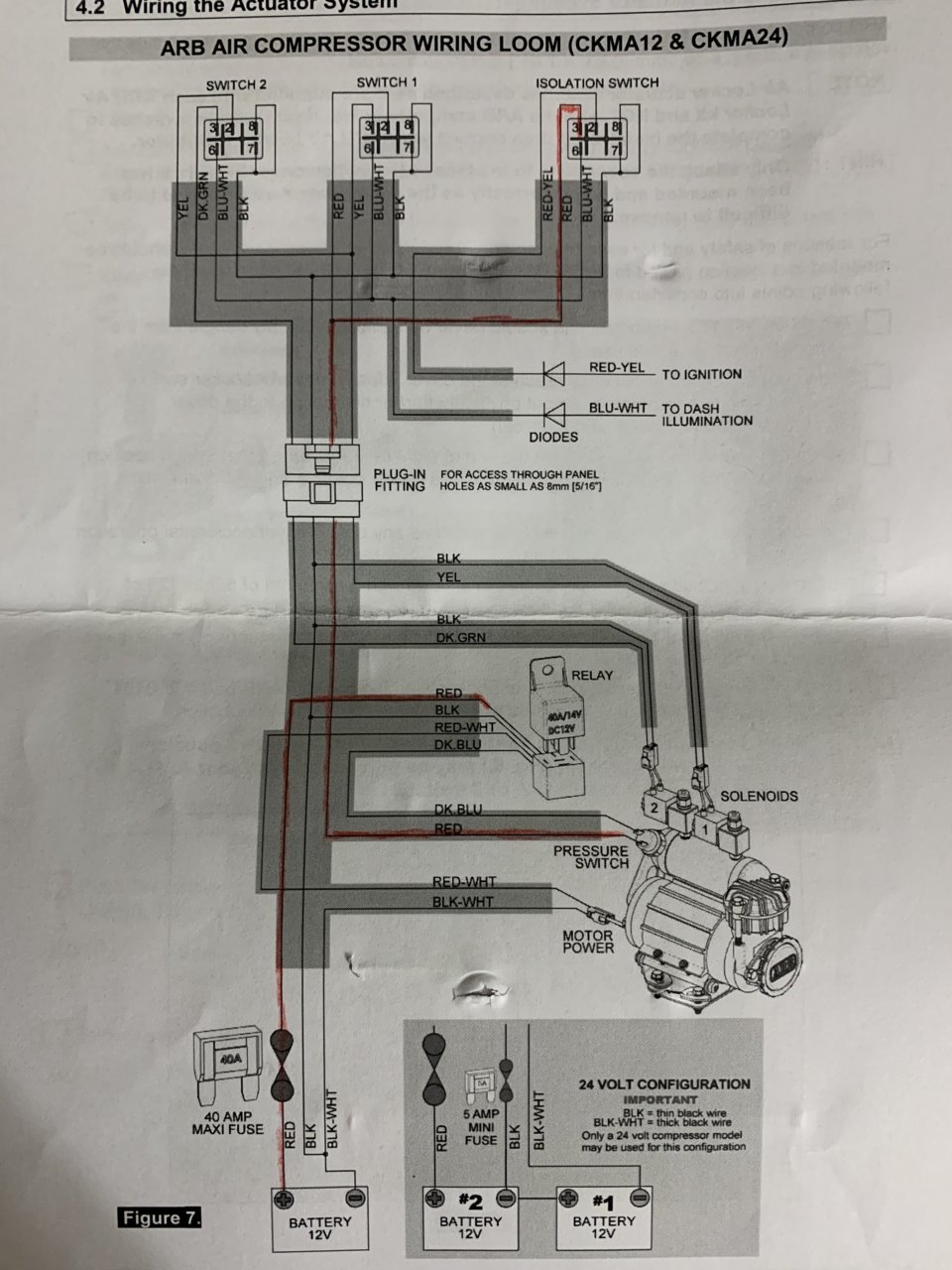

    Check the air compressor switch and pins 6 and 2.
    F8467F82-53B2-42AB-880D-CA3478D96FEB.jpg 7028AD76-5FC2-4D63-A84F-23C65DF68F4D.jpg
    theesotericone and TnShooter like this.

    There is this.
  9. Jan 31, 2020 at 6:15 PM
    dubmai
    dubmai [OP] Member
    May 11, 2013
    #103978
    11
    Utah
    08 Taco SR5
    Yeah, this kind of worries me now

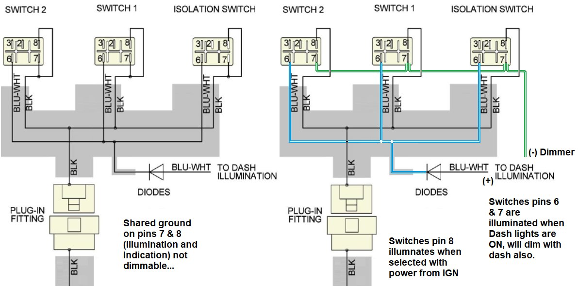

    OP, it's the red with yellow wire that needs attention...
    Illumination tap wires removed for clarity...

    OP, if you feel like modding it yourself...do this:
    The shared grounds indicates (to me) that the lights inside the switches do not have an internal ground share, if they did there'd be only one ground for both lights on the switch.
    So, by removing the ground wire on pin 7 (of each switch) and linking them, then tapping them into the dash illumination ground wire (green with white runner) they'll behave as all the dash lamps do.
    So, daytime, dash illumination off, locker not selected, all switch lights OFF
    Daytime, dash illumination off, lockers selected, one light ON.
    Nighttime, dash illumination ON, lockers not selected, one light ON.
    Nighttime, dash illumination ON, lockers selected, both lights ON, one dimmable.
