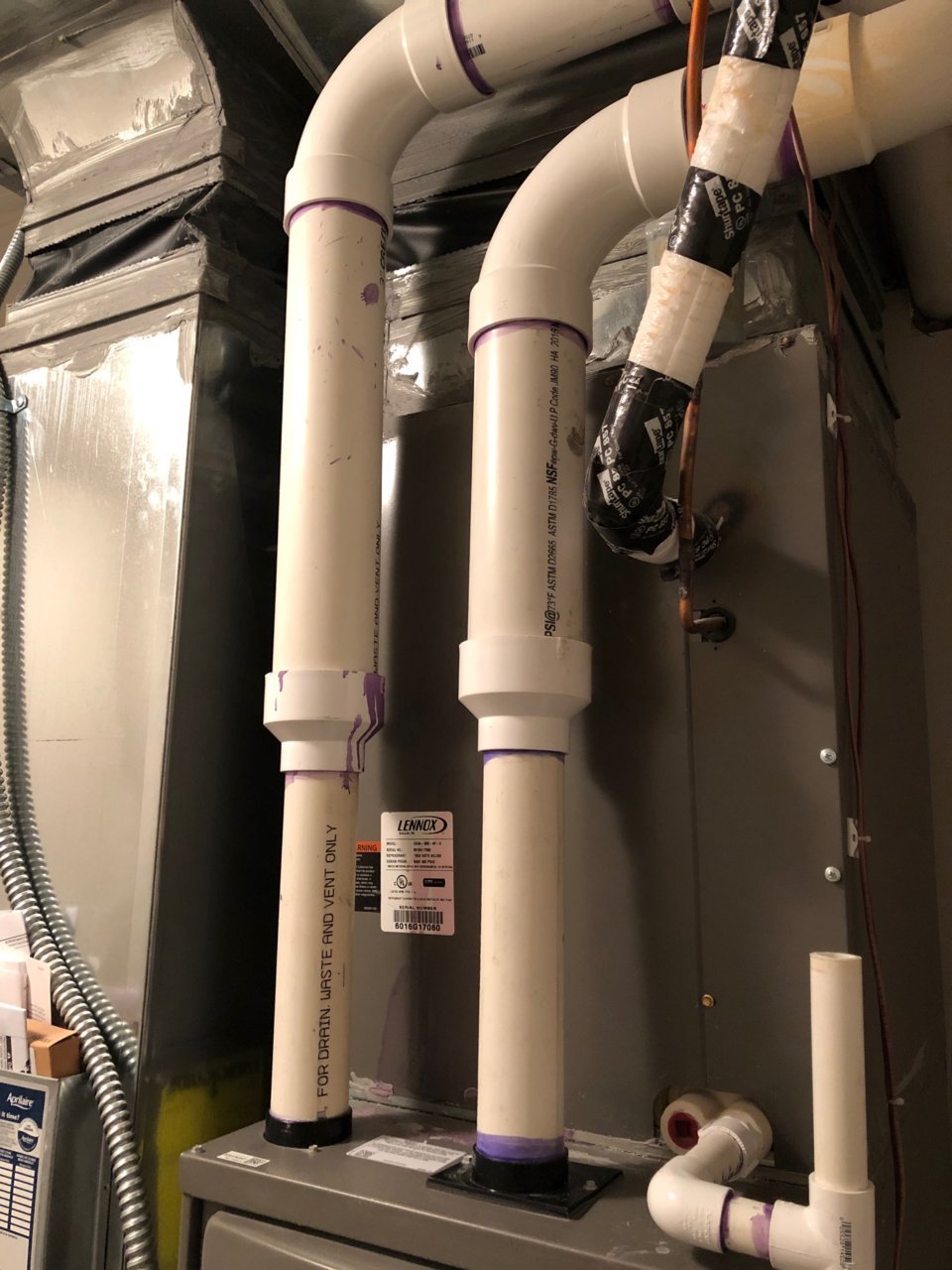

    I was curious about putting the HVAC system in the garage, apparently it's not allowed anymore. Unless this was just a suggestion:
    https://basc.pnnl.gov/resource-guides/no-ducts-or-air-handlers-located-garage

    Now we have to remember that different areas of the country and Canada build differently. I am not really familiar with HVAC units in the attic of residential buildings, so I won't make suggestions. I can tell you that in the Mountain states our hi-efficiency furnaces have two 3" or 4" PVC (depends on length of run) pipes that run from the furnace to the exterior. One of the runs is the fresh air intake and the other run is the exhaust. I am weak on my HVAC skills and this may not be the case for the southern US.
    3" PVC Intake and Exhaust and 3/4 inch PVC condensate drainline

    That's what the furnace does in this unit also. It's called a sealed combustion system, which is unlike atmospheric systems in the days of old. I am not entire sure if this system will draw in "fresh" air into the home this way or if this air is only used for the heating portion of the HVAC. I don't know enough these mechanics of HVAC systems.

    I do agree that the newer hi-efficiency systems are a sealed combustion unit, nothing like the old systems that took their combustion air from inside the house.

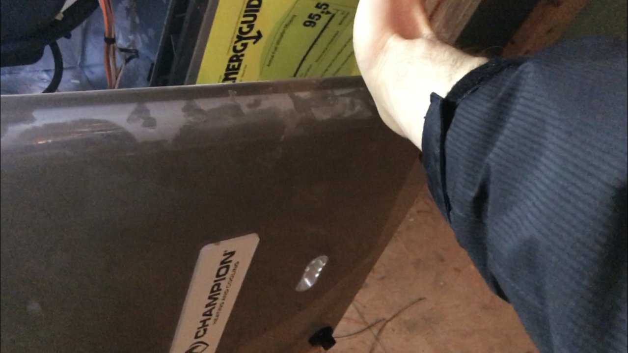

    The furnace pictured above is a 95% efficient unit described as "The higher-efficiency models are called “condensing gas furnaces.” They run exhaust gases through a second heat exchanger to extract and use available heat that’s otherwise exhausted. These models pull out nearly all of the heat, sending cool exhaust out and leaving behind condensed water. This condensate, 5 to 6 gallons per day, is drained or pumped away by a condensate pump connected to the appliance." Hence the need for the 3/4 inch PVC drain.
    I believe that the furnace pictured only draws in enough fresh air for combustion, not enough for a complete air exchange for the house. I'm wondering if you may have to look into an air exchanger to provide whole house air exchanges.
    Curious as to what you find out as far as whole house air exchange

    This one is 95.5. So I guess it's a condensing gas furnace

    I used to work in HVAC. When it's got really cold out I live in north ga so only a little warmer and just as humid as Nashville. Those high efficiency furnaces the exhaust pipe would freeze up with condensate.
    They suck in air in the intake for combustion and it goes out the exhaust or flue pipe.
