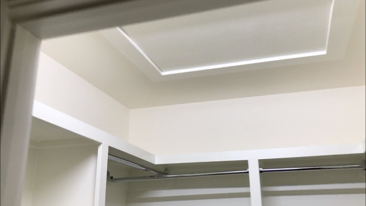

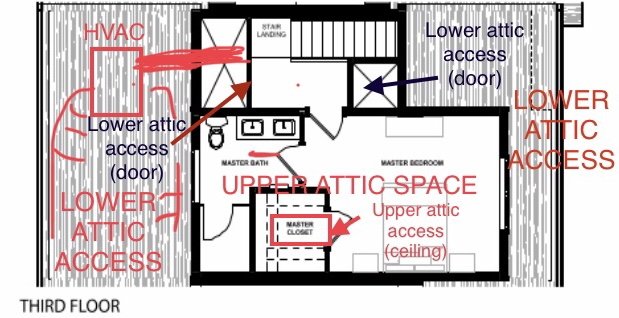

    That would be a good idea, I think the space is fairly limited up there though. The attic is basically in three separate sections. It might be an option to only seal and condition the section where the HVAC is in?
    Here's a really shitty explanation using my phone haha. The master bedroom ceiling is vaulted, but the closet and bathroom ceilings are normal.

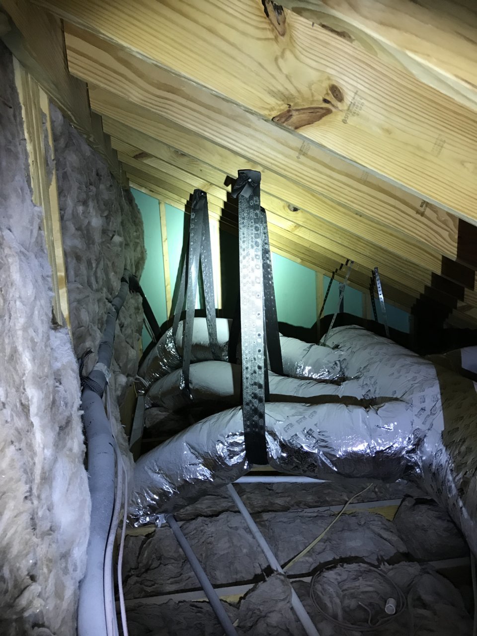

    Still waiting to get a spec sheet. I can tell by looking at it that it's the eco kind that doesn't get fiberglass all in your arms. It's kinda brown. I remember working with that vs regular fiberglass and not feeling itchy after. Here it is shown in a pic. That wall on the left is an interior wall, hence the insulation there

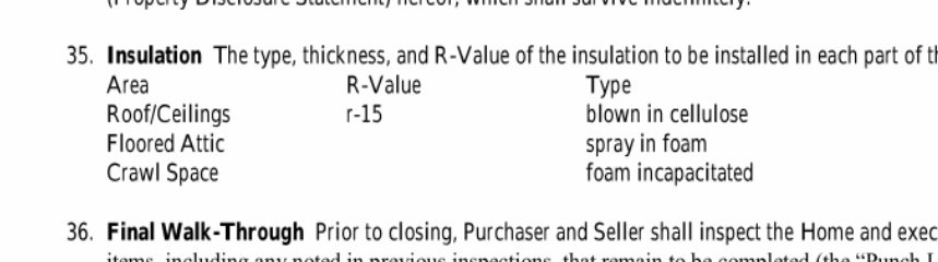

    Here's what the purchase agreement contract shows. As you can see, the "lower attic" spaces I'm talking about are technically floored. So they should be "spray foam", but they are not with current builds. At least if they waited this long to add it, they will have to really crawl around to get it everywhere it needs to be.
    I love how it says the "roof" gets blown in cellulose. I don't think it works that way unless they use some sort of sheeting to hold it in place. I'm also pretty sure they meant "encapsulated". Which is funny because none of these townhomes have crawl spaces. They sit on a concrete slab.

    R-15 roof ?

    What are those 1" ish PVC looking pipes or conduits ?

    No idea. Next time I'm over there, I'll try to trace them
