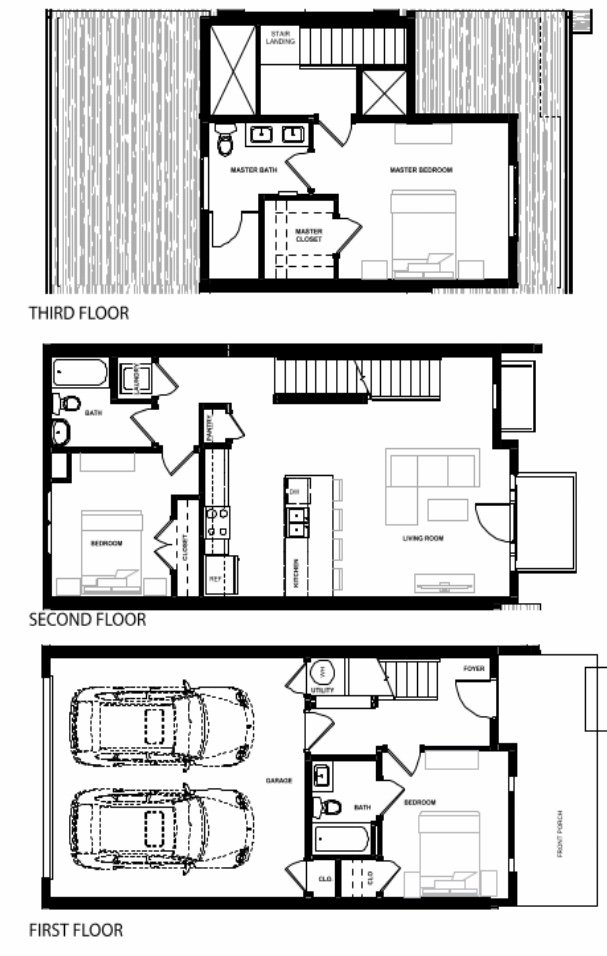

    What are your thoughts on the placement of the thermostat? It is on the 3rd floor of the townhome. I feel as if the tstat should be on the 2nd floor. The listing agent says the HVAC guys said "this is not adviseable". Why? I don't see what difference it would make, other than the fact that the living room would be the control center. There are no doors separating air flow from the bottom all the way to the top floor so naturally all of the cold air will settle to the bottom floor and the hot air to the top floor.

    Every two story Ive been in had a thermostat on every level. Not sure about homes with a 3rd story. One thermostat controlling the temp on multiple levels doesnt sound right to me.
    What state is the house located in and whats your square footage?

    TN. 1550sqft

    @ThunderOne I had to step back and take another look at your situation and questions from another perspective. My situation is different than yours and may not even be relevant. For background, I am located in Colorado on the east side of the Rocky Mountains. Our climate is dry with an average of 16" or rain a year, so we have low humidity. Our temperature can swing from -20 degrees to +105 degrees in a year; so a swing of 125 degrees from winter extreme to summer extreme. With our climate, as a general rule we would not think of having any of our Heating or W/H units located outside of a "conditioned" environment. So I don't think your quest for a conditioned environment for your heating equipment is out of line.
    Your question about thermostat placement is good. In our part of the country, thermostats are located on the first floor of 2 story homes (remember we have basements). Looking at your floorplan, I don't think there is an ideal placement. I do think the second floor is the best option, remember thermostats are usually located away from stairwells, outside walls, kitchens, etc.. (areas that can be "artificially" heated by solar gain, cooking, drafts, etc.) You might also investigate the use of two thermostats.
    @OZ-T had a great solution for you as far as design of the conditioned space. I would talk to your builder and see what the upcharge is for building a "conditioned" space in your attic. You may find that the charge is too high and the pay back time is not worth the cost. On the other hand, you may find that the builder can not honor your request. This is usually the case when some type of production builder (whether national or local) is constructing the unit. Their hands are often tied by set of "allowable options". I would also give your local building inspector a call and discuss you concerns and questions.

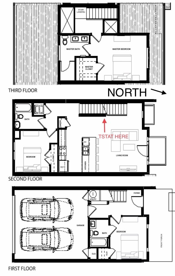

    Here's where I was thinking. Interior wall, no window sun heat, away from supply vents, kitchen, bathroom, washer and dryer.

    I did read many things about this, but I think it would installing a "non-standard" HVAC system, no? It may be difficult to negotiate in this sort of a request.
    I did receive word today that if they cannot install the thermostat on the second floor, they would use a Nest instead so I could use my phone to adjust. I'll take that as a win-win..

    I think if that T-Stat is on the 1st floor th rest of the house is going to starve for cool or heated air.....

    It'll be on the middle floor (at least that's where i want it, currently they want to put it at the top floor at the stairs on the wall by the HVAC handler. There's 3 floors. See post 86

    It's a 1550 square foot three level townhome, so each level is just over 500 square feet, I can kinda understand the concept of having one thermostat based off of that.
