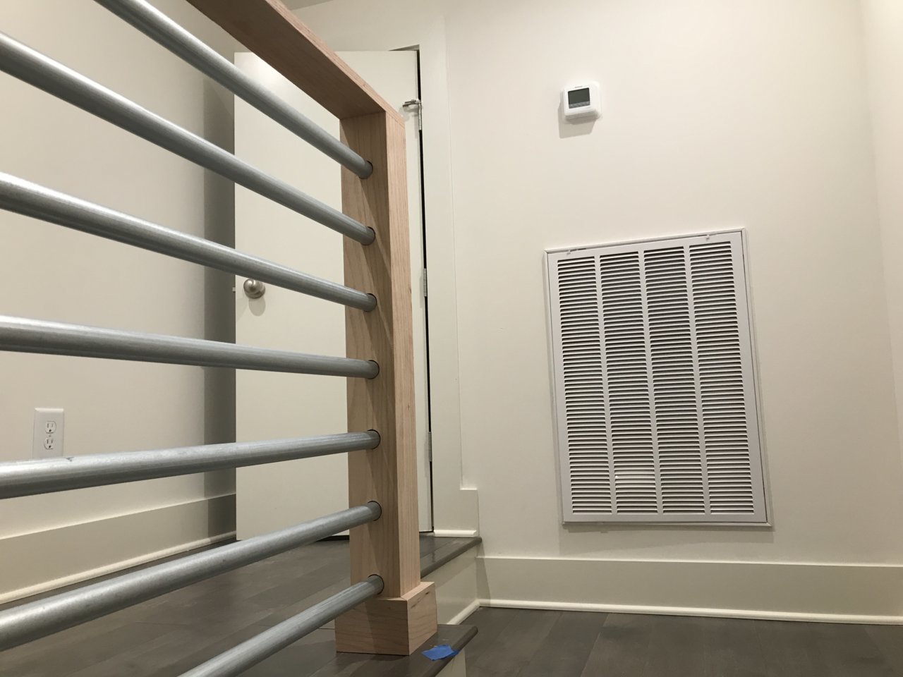

  13. Apr 28, 2019 at 11:13 AM
    #113
    ThunderOne
    ThunderOne [OP] Well-Known Member
    May 20, 2009
    #17473
    10,043
    Mitchell
    Nashville
    1ST GEN OR GTFO
    Toyota NERD
    No, there's only one return at the top floor by the stairs. This puts it close to the HVAC. It is a 20x30

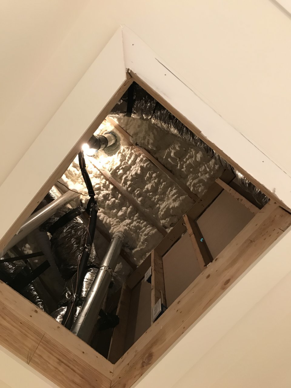

  19. May 20, 2019 at 6:55 PM
    #119
    ThunderOne
    May 20, 2009
    #17473
    10,043
    Mitchell
    Nashville
    1ST GEN OR GTFO
    Toyota NERD
    Looks like the next row of townhomes was sprayed. This is looking through to the attic of a 2BR.

    From the first post, pic#3, I see that your attic insulation is going bad due to moister. This happens in the summer, when the air conditioning is running. A vapor barrier must be exposed to the warm side of a wall (ie, when hanging wall, the silver/paper side should always be on the inside, because water forms on the warm side and the foil/paper stops water from penetrating the insulation. Only water can destroy insulation, and it does a very good job at it.
    Here, with your attic HVAC, the ductwork wrapped in insulation has the vapor barrier facing outward. This is good in the winter, but not in the summer. In the summertime, your duct sweats, it destroys the duct insulation, and it drips onto the attic insulation, destroying that too. Without any insulating value, all that mildew stained insulation has to be thrown out and replaced. To stop it going forward, I would cover the new insulation with plastic wrap, knowing that sweat will still occur, but the plastic will hold the water until it evaporates.
    I completely agree with you that attic HVAC systems should be protected in an enclosed floor. All HVAC systems, btw, are 'closed systems', in that air is returned to the furnace from inside the house, then heated or cooled, and re-fed back to the house. The trend of placing HVAC in the attic started in the early/mid '90's (from what I remember in this area of the country), and it was to reduce cooling costs. However, insulated covered ductwork is always a problem unless both sides of the insulation have a vapor barrier. Also, when using AC, you must always keep an eye on the condensate drain, and be prepared to replace the pump (a small, rectangular $100 part) should it ever go out. So, it's good to keep an extra one on hand, just in case.
    BTW: Pic #1 looks good.
