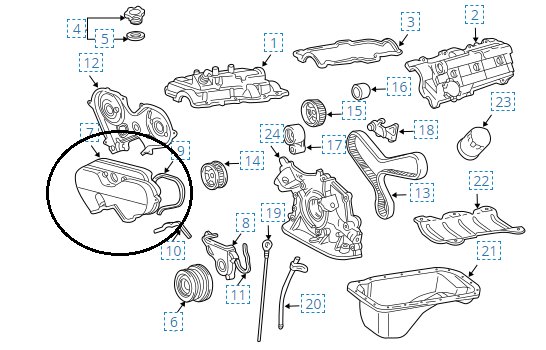

    Another question - when I was investigating the water pump leak, and removing the timing belt cover, 2 of the 3 small clips on the top of the cover that hold what look like vacuum lines were broken. Not a huge deal, but I'd like to replace those, if anyone can steer me towards a part number. I did a fair amount of searching the Camelback parts site, but I cannot seem to locate the correct diagram to find those 3 clips. They go on top of this:

    There is a vacuum line diagram also, can you find that?

    I might be able to find something on ALLDATA. Let me check

    This is what I got. Hope this helps

    I appreciate the effort, thank you. However, I am looking for 3 small clips that go on that cover, not the cover itself. It looks like a trip to the dealer is in my future. I need the clips circled below:

    Those are clips for your spark plug wires. Maybe that will help you find them.

    Loom clips, you should be able to find something that works at any decent auto part store.

    HereIMG_20220304_074233569[1].jpg ya go.

    You, sir, are Stan the man! Thank you! I'd sure like to know how you found that part number, but I am thankful regardless. :thumbsup:
