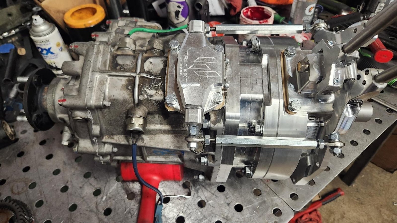

    Interesting, I’m considering doing the same with my stock electric case behind it. Any more info on your shift boot? Looks cleaner than most I’ve seen.

    Shift boot is a FJC manual boot, they had J-shift cases. The beauty boot is my stock boot, with a piece of another grey boot slipped on after I slit my stock boot. I need to get someone with a sewing machine to sew it up.

    Okay that makes sense that you made the beauty boot yourself instead of purchasing one with two sections. Thanks! And the fj boot fits underneath no issues. Thanks!

    I just extended the wires in my stock case, that way I could have a really clean install with a FJ shift boot.

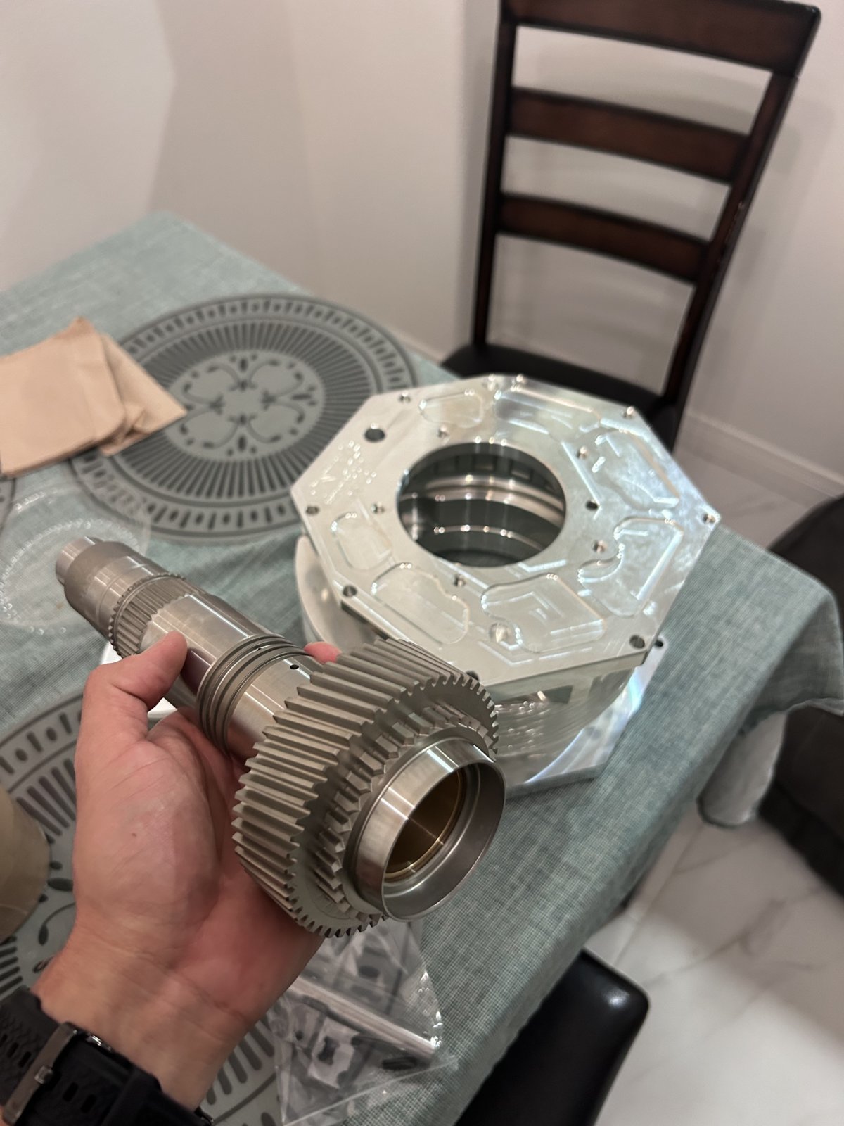

    Package secured. Placed order late march.

    Thank you brother, I will have some busy weekends so prob gonna knock it out until ‘merica’s birthday weekend to fuck shit up. Gotta buy some pullers from HF to remove the shift collar alignment.
