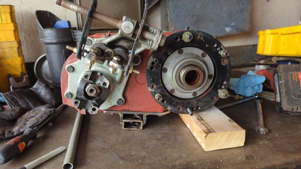

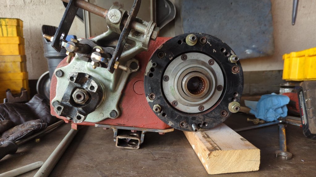

    I have a question for those who might know. Do you think the way these shifters are will interfere with the Eco crawler hooked up to this? Dana 300. Thanks ahead of your time for the input.

    You're in uncharted territory with the dana 300 behind the eco crawler. I haven't seen anyone else do it.
    That said, all of the shift linkage sits center over the the eco crawler on the input/output shafts. Since your linkage looks like it's over the front driveshaft output, I don't think it would interfere. Is that custom shift linkage? I know nothing about the dana 300.

    Custom is one way to put it. I hobbled something together to just see what it's going to look like.
    Mine came from a jeep CJ. It's cast iron gear no chain and can be run pass. Or driver's side.
    The Dana 300 gives you 2hi- 4hi- 4lo- 2lo rear and just front wheel drive low.
    I can't find one pic of an eco crawler and Dana 300 on the internet the only reason I'm going to it is because of the front diff is pass. Side.
    Thanks for the reassurance about the shifter.

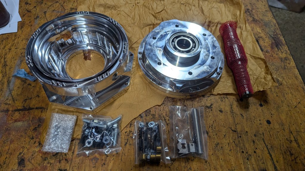

    So I got.this in the mail. No Dana 300 instructions though. But I think I figured the Dana 300 part out but since I don't have another 3k I'm going to wait on nwf for some instructions.

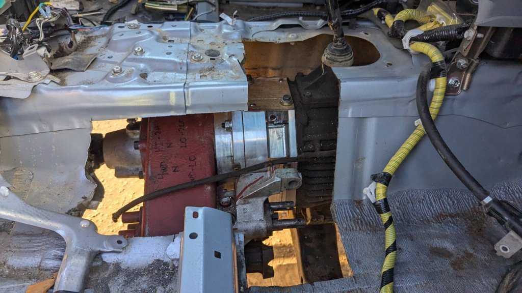

    its all figured out. thanks. I'm not going to say it was a mistake to go passanger side t case but its a hard road.. and since I'm in the process I rally don't know if it will work with the truck I have 2014 tacoma and the front diff I have 1990 dodge w250 dana 60. I'm waiting to see if it will work, I'm trying...

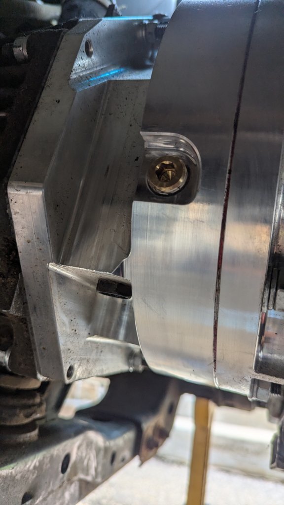

    Just an update pic.
