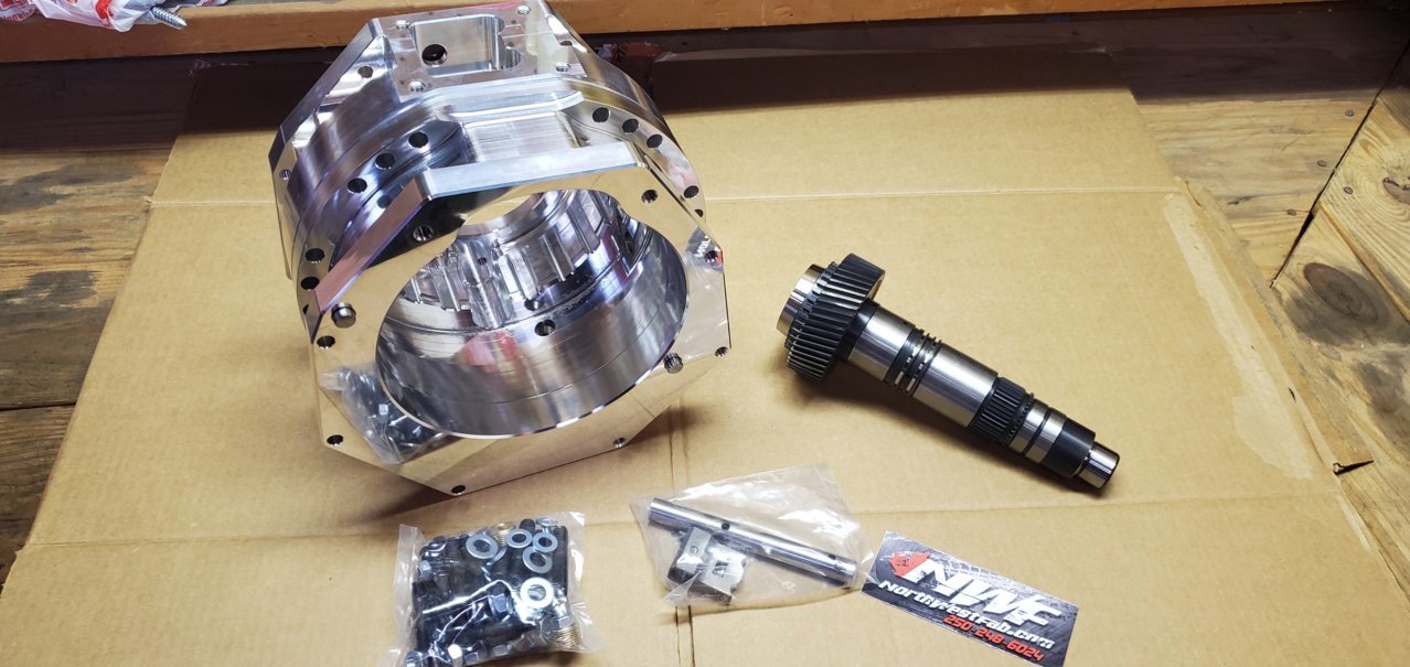

    It's so beautiful, the machining is just awesome!

    How long was the wait for yours?

    I think I did the pre-order around 10/2 and it was delivered 12/8.

    Indeed, it looks like a part from the Terminator metal skeleton

    Making some progress.
    Have to grind material away at the back of the transmission for shift rod clearance. The shift rod when in high range protrudes about 0.980" from the face of the Eco Crawler.
