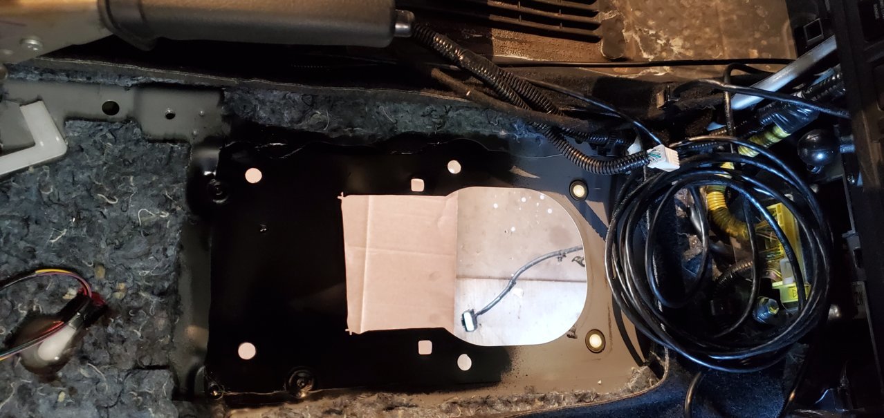

    I cut the hole in the floor today and will I'll be using the shift boot from an MT FJ Cruiser to seal it up. I'll get pics when I get that done. I plan on having the new shift lever come up on the right of the manual trans shifter, that's still on the to do list. Hoping to have it all wrapped up next weekend.

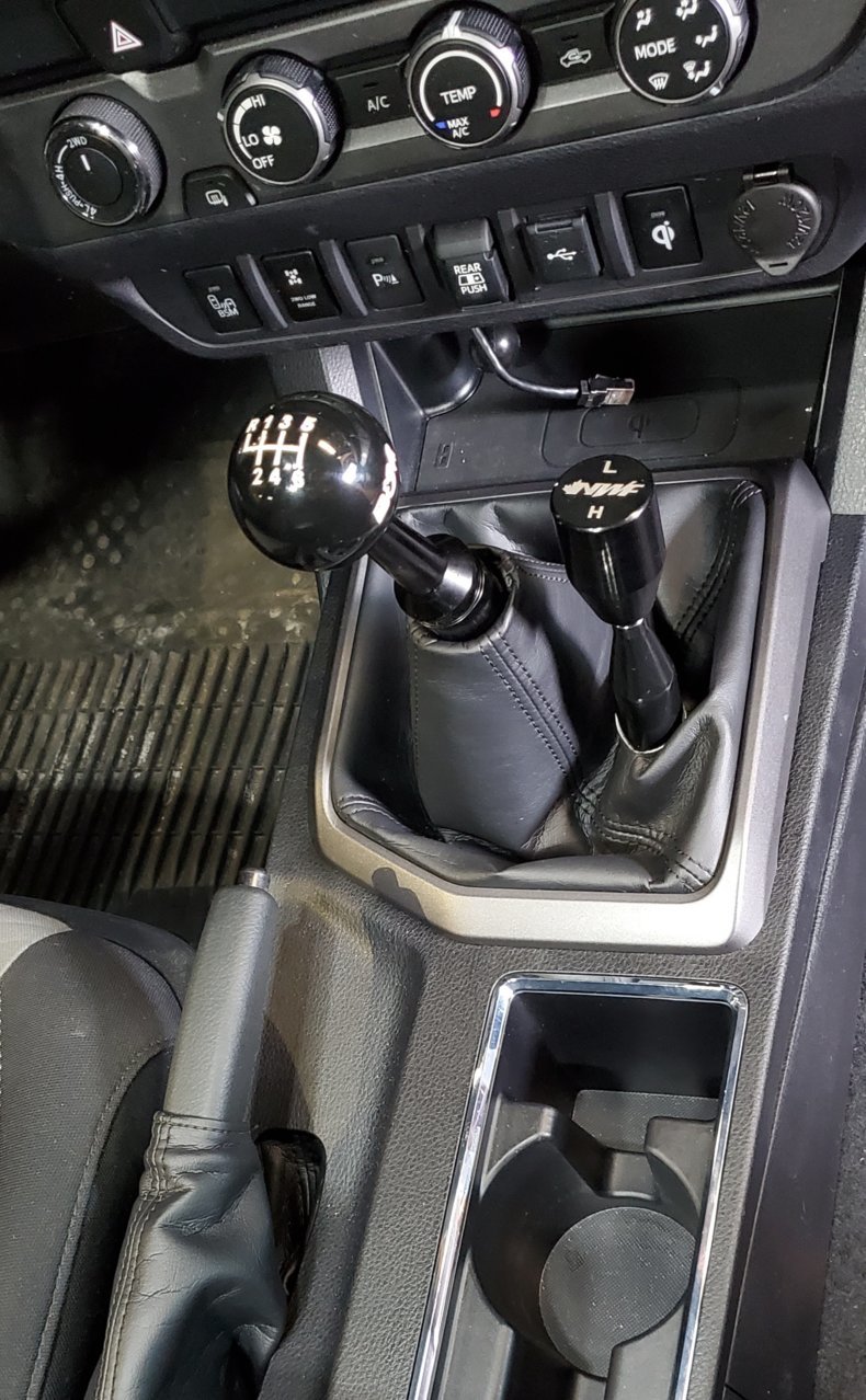

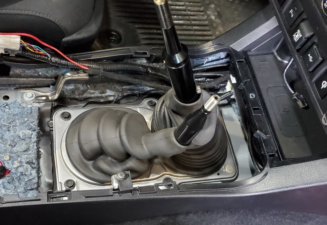

    Got the install wrapped up today. Shifter modified, Foor seal installed, and interior put back together. Just cut a hole in the shift boot for the second stick to go through. At some point I'll get with an upholstery place to make a proper boot.
    Also took a test drive and everything functions. The double low is going to be so nice, also easier on the clutch.

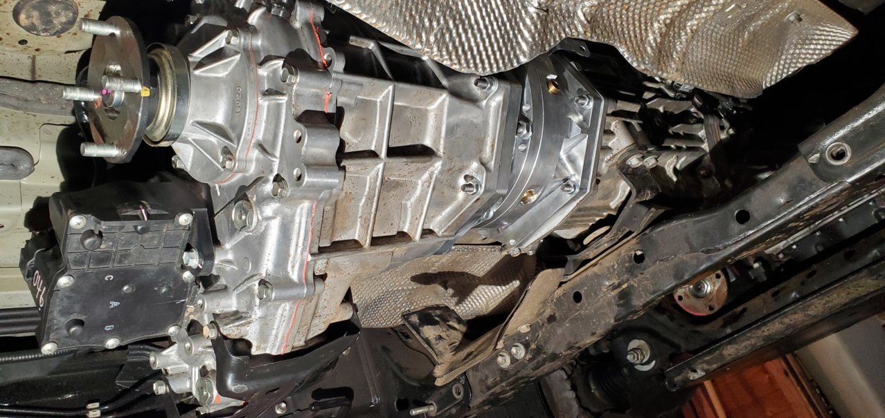

    Edit - for future reference I had the front driveshaft lengthened 6.5 inches and the rear driveshart shortened 6.5 inches. For the rear shaft only the short section in front of the carrier bearing needs to be modified.

    appears you kept stock case for the rear case. What did the donor case come out of. did you have to lengthen the wiring for the factory transfer case to reach the new position 6.5 inches back? how did this effect when the factory locker can be used? I am assuming you can still only engage the locker when the original case is in 4low.

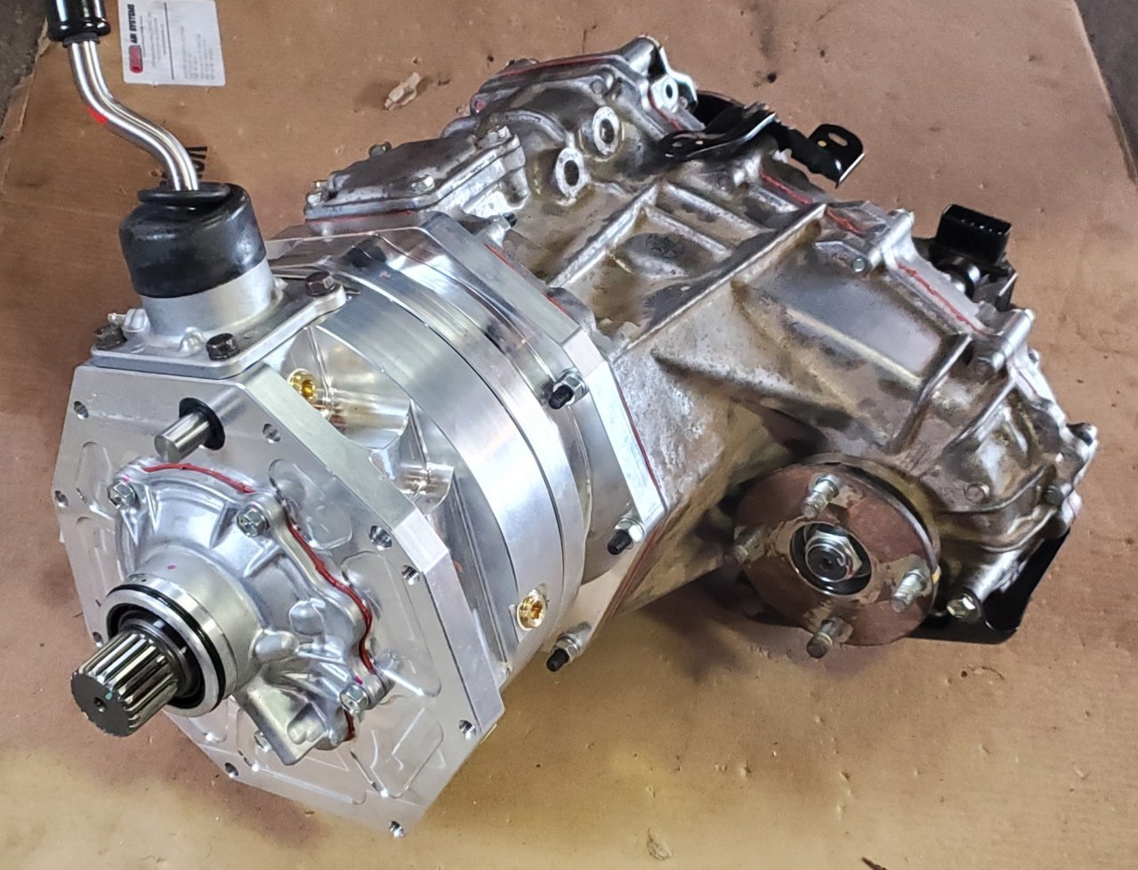

    Donor case was out of a 2004 Tacoma 3.4L AT with 120,000 miles
    Yes, I kept the stock transfer case. I cut and extended the wire harness to the transfer case actuator 11" ( thought it would have been 6.5" but it would have been too short maintaining the stock routing).
    Yes, stock case has to be in 4 low via selector for the locker and traction aids. It Operates like stock.

    Donor case was out of a 2004 Tacoma 3.4L AT, but one from an auto FJ cruiser or even a 4runner with manual shift part time 4wd would work. @NorthwestFabworks has a good compatibility list on their site.
