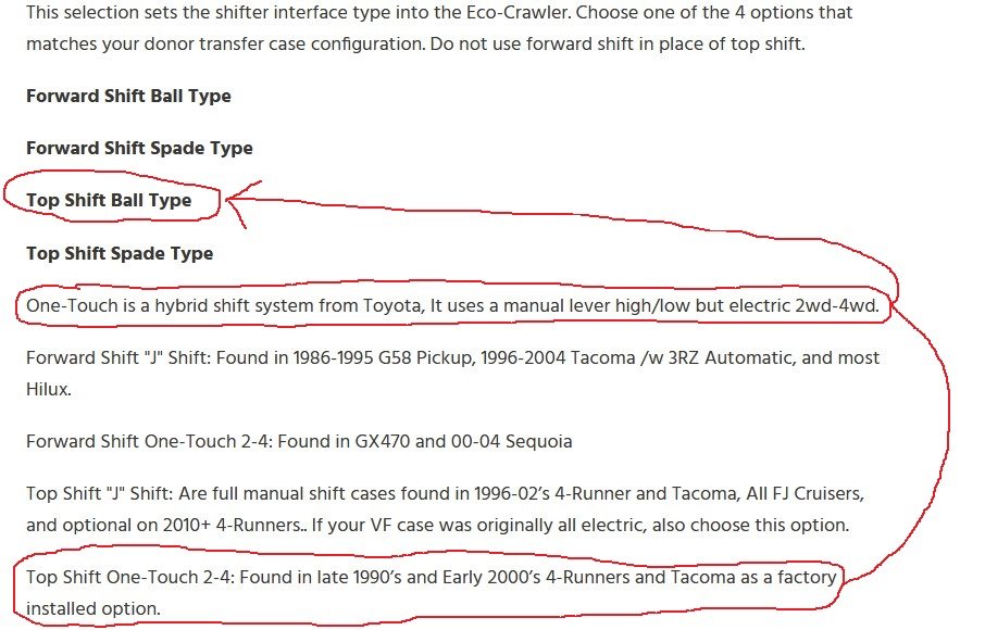

    @jstemp for the shift interface is it Top Shift Ball Type, Top Shift Spade Type ?

    It depends on what shifter you're going to use on the Eco Crawler it's self (not the transfer case bolting to it). J-Shift pattern transfer cases will be spade type.
    I used a shifter from a Auto FJ curiser and that is a top shift spade. Top shift ball was used in some models that had manual shift hi/low but electric 2/4wd selector (see picture).
    -EDIT
    This is off NWF web site. Circled would be top shift ball.
    @NorthwestFabworks Maybe the shifter types should be clarified a little more on the site.

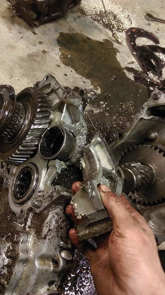

    In between the other mating surfaces, yes my stuff leaks. And it is a lot of weight when theres torque and wheeling forces applied, especially with a manual where you can really shock and hyperspin the drivetrain. Pictured below is an older topshift tcase from back in my crawler days (doubted with bigger tires than most newer Tacoma people have, albeit ~2,000 less lbs). When you input twice the torque to the rear case, inputs, outputs, and low range gears see those and in the end the cast aluminum housing flexs/shifts which leads to things breaking and joints leaking. I just know that when I do this doubler, I'm making a mount while I'm there since I'm hard on stuff.

    This is normal for the Marlin/TG stuff. The adapter plates between the crawlbox and trans have an opening that allow the trans tail housing to fill with oil from the crawlbox, so the spot that normally is dry is a source of leaks for many of us. Hence the reason I was asking about how the NWF box seals up and if it's leaking. Looks like it should not be a problem for your setup, at least between the trans and eco crawler since it's a solid plate that seals using the factory flange.

    I know the issues of the marlin and TG sealing, but he was refering to it leaking in stock configuration. That's why I'm saying there's bigger issues there.
    The whole game here is break parts repair it better then break the next weakest link, and repeat..... I think we all know what we're signing up for lol.
