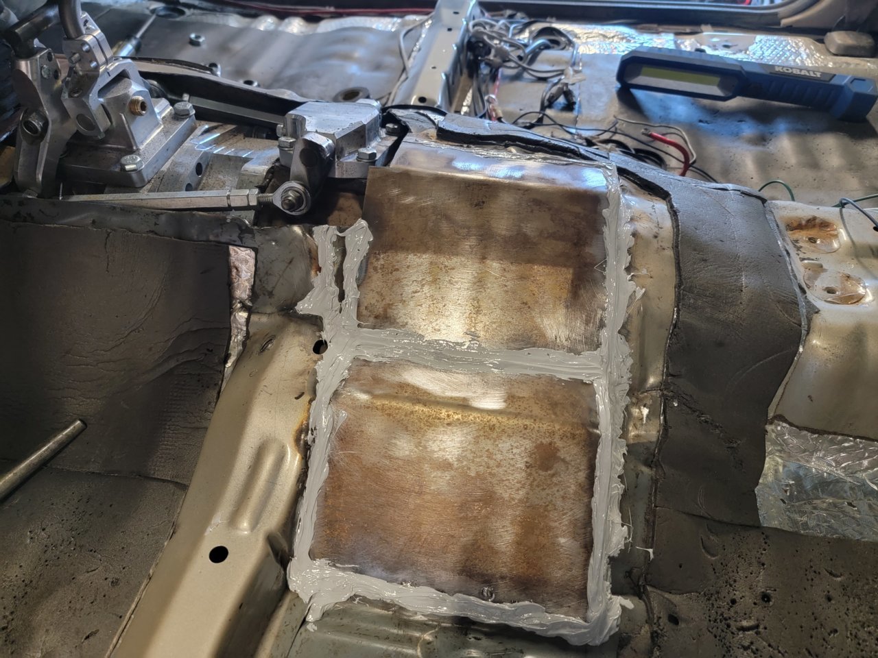

    Well, rear case clocked as much as possible required lots of cutting in my 1st gen with no body lift. Did a half-ass job finishing sealing everything before a trip, if anyone figures out a shifter boot setup that works well with their triple sticks let me know! Otherwise everything is working well. :thumbsup:

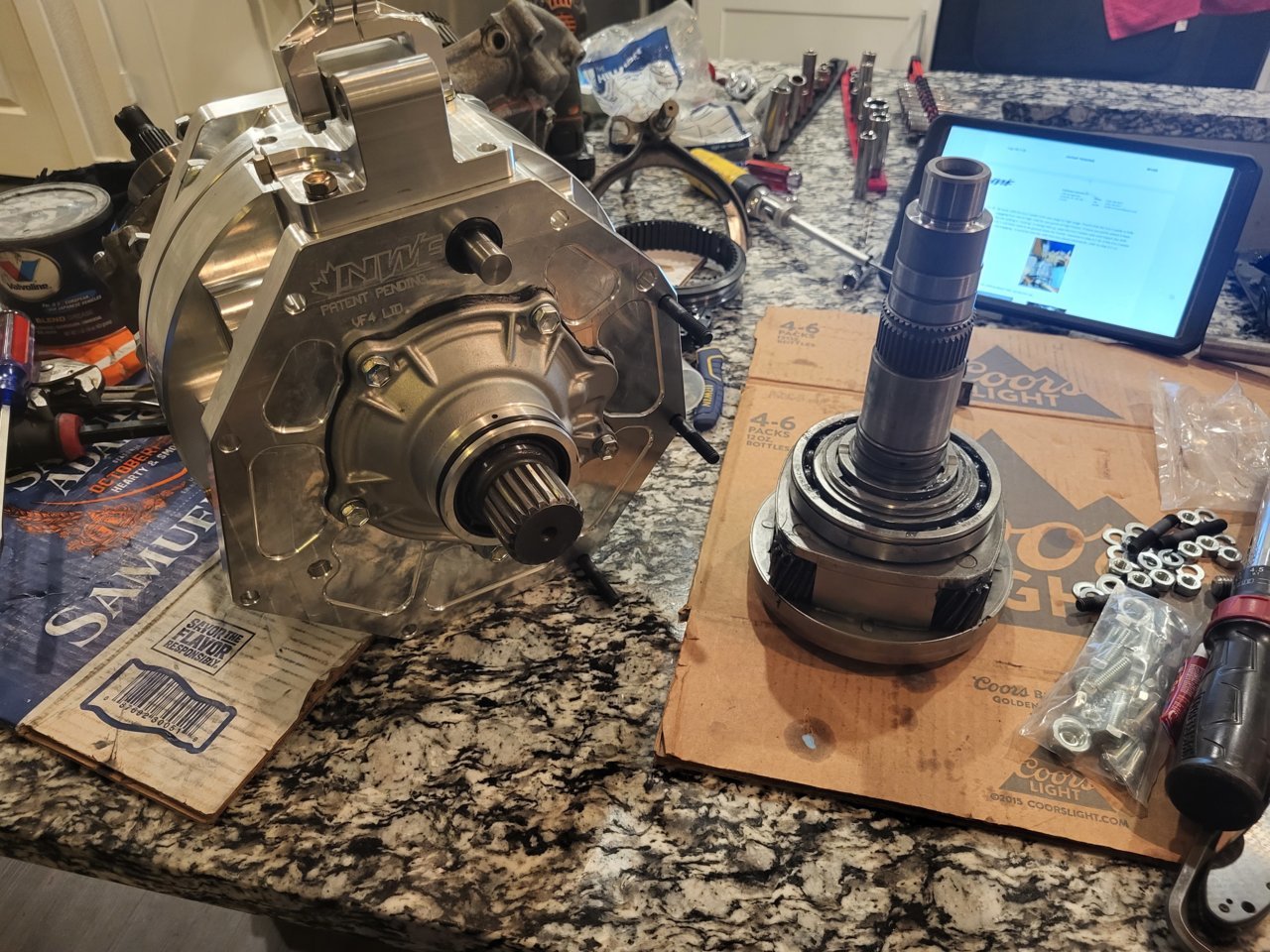

    I highly recommend reading the install guide. Should answer most questions. It looks like they recently updated it since I did my install, but I haven't read over the changes in detail yet.
    https://northwestfab.com/pages/installation-manuals

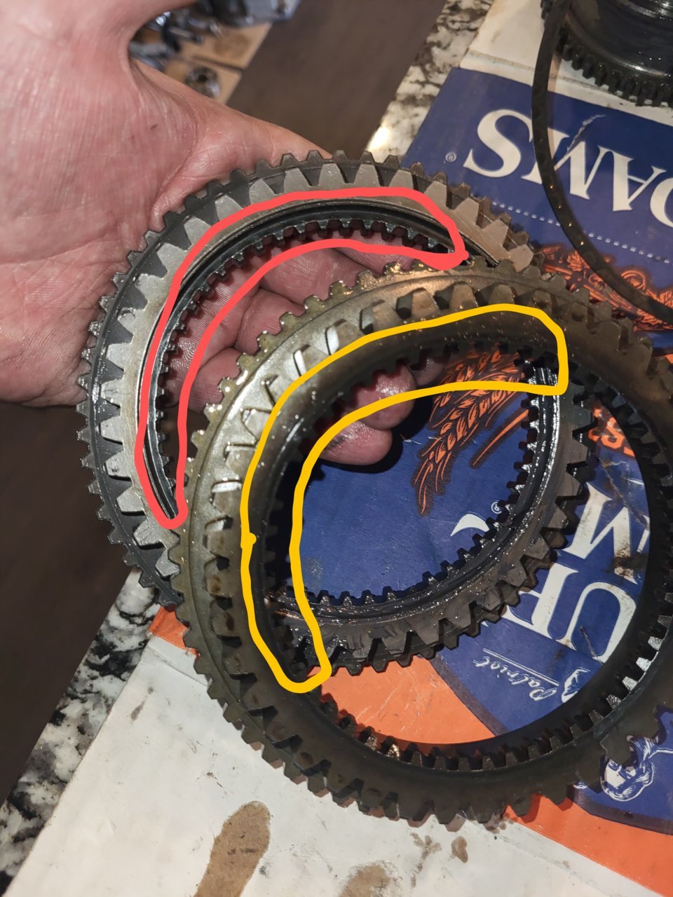

    You are correct on option 1: the 22 spline planetaries that you swapped into the FJ case need to come out of of the FJ case and go into the ecocrawler with the o-ring flange that came from your original tcase. Hopefully you kept the old 23 spline FJ planetaries? You will swap the input shaft on that for the one supplied by NWF, and install back in the FJ case.
    Did you have to swap over the lower plantary gear spline (toyota part #36284-35021) for the FJ swap? I think you would have had to, but I am not 100% sure. Shown below:
    You would need to source another one of those to put back on the 23 planetaries that came out of the FJ case, after you swap the shaft from the 23 spline to the NWF shaft. In addition you'll need a shift collar and some other odds and ends...all listed in the first few pages of the instructions.
    Your option 2 is buy a complete FJ case as a donor, not a Tacoma case. The only useful thing in the stock tacoma case for your application is the 22 spline input for the manual trans, which you already have. Just pull it from your current FJ case and find all the other parts you need in another donor FJ case. This is what I did.
    Edit: This is the more expensive route. The additonal parts you'd need are cheaper ordered individually. I only went with 2 donor cases because I had a cracked FJ case laying in my garage as well as my old taco case available.
    Either way, your existing case has to come out and be taken apart to swap the input shafts.

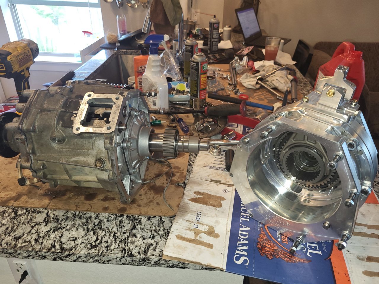

    Heres the NWF box assembled with my tacoma 22 spline planetaries next to the FJ planetaries swapped onto the NWF input shaft.
    Hope this helps.

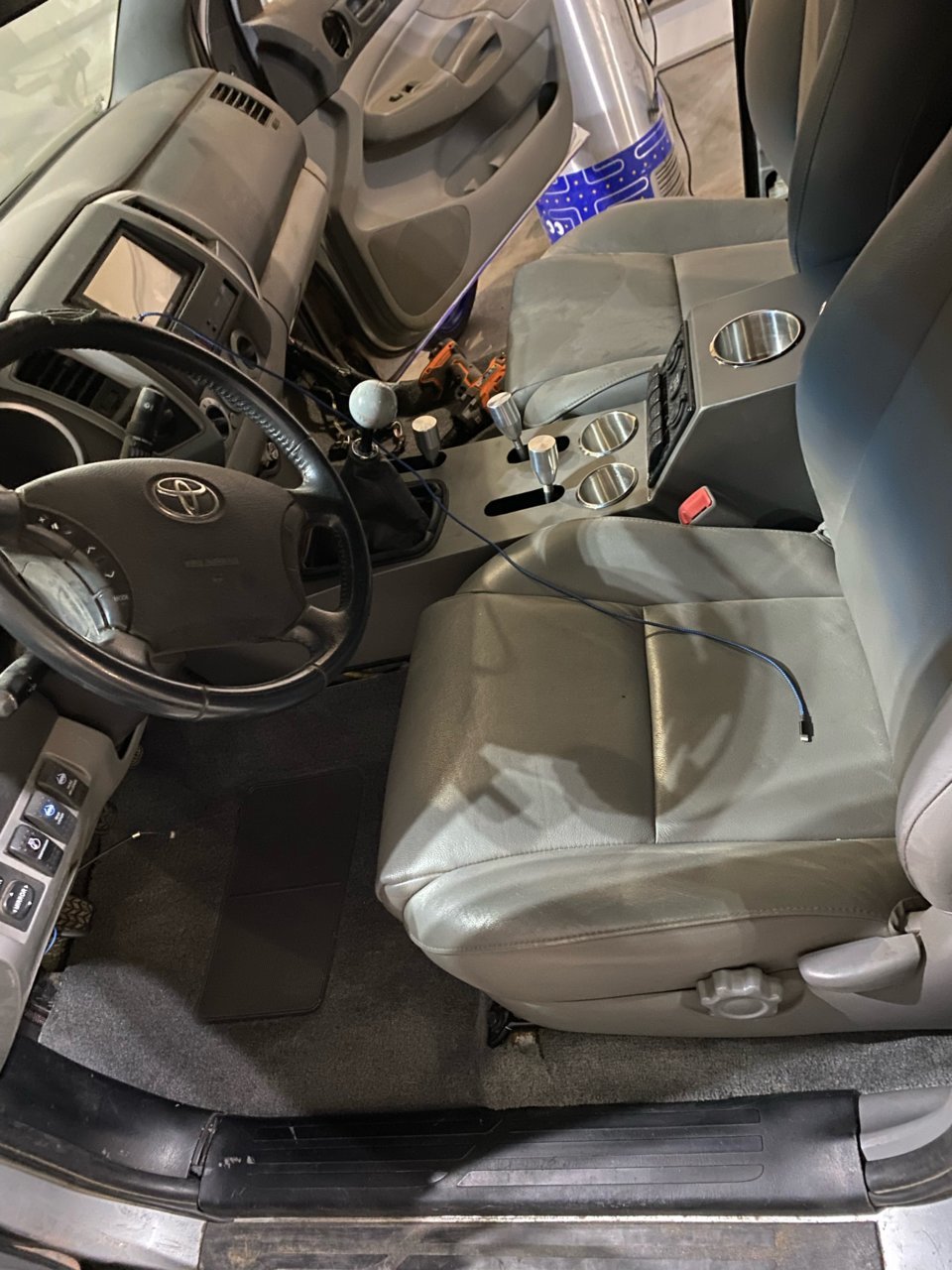

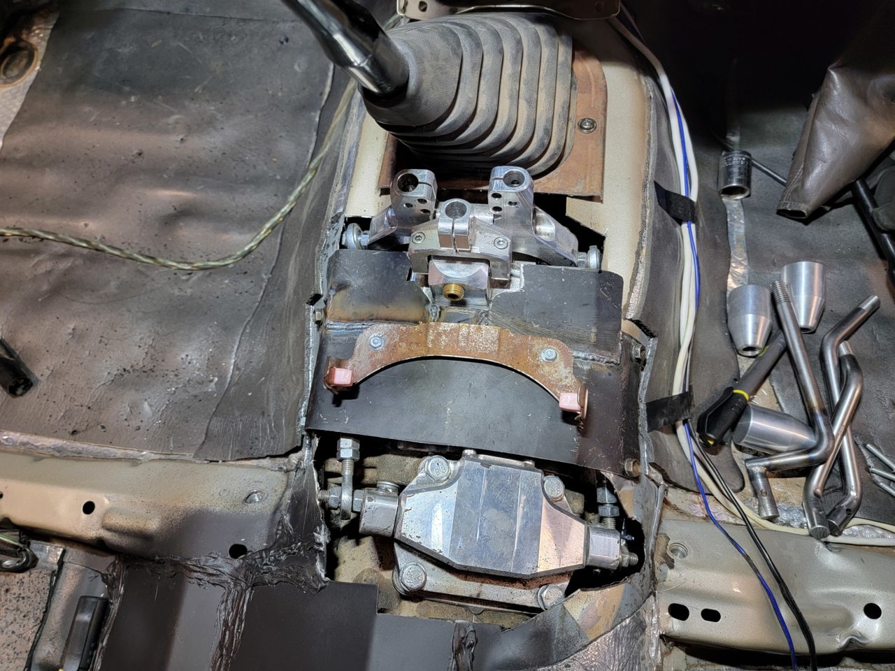

    Wrapped up an install last week on a customer's truck. Ended up building a new center console to clean up all the shifters and added a switch panel.

    That is clean as hell. Nice work!

    Amazing work! Did you guys swap to an fj case as well?

    Yes. There was already a FJ case in the truck.
