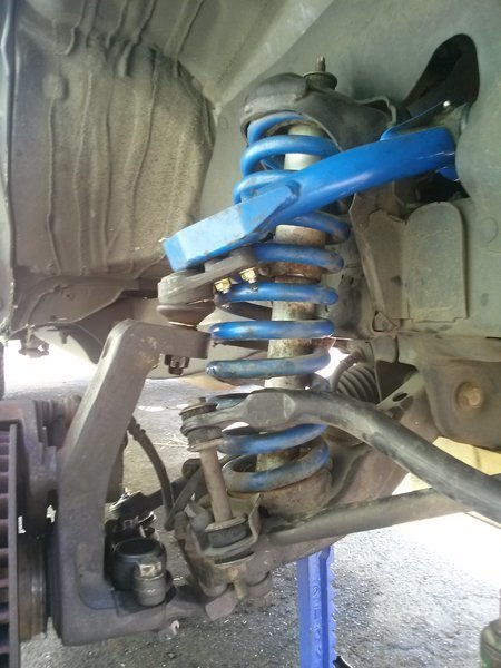

    drop bracket lift. Is that what the fab tech lifts are called? I’m guessing it had 3 ish before I added the spacer, there’s a couple inches of body lift too, that’s why it looks so high.

    yeah a body lift won't effect your CV angles, but a 3" suspension lift is pushing it and when you added the spacers it went way beyond the limit.
    A drop bracket lift retains the stock height for the front drivetrain, so your front diff and cv axles don't get effected at all. The downside to them though is that they aren't great for offroading - because the front diff stays at stock height you don't gain any actual clearance there. But otherwise it's a much better option for lifting above 3" that won't compromise the front drivetrain.
    Another downside to drop brackets is that they are considered non-reversible since you have to cut and weld to install it. Technically you can reverse that but it won't be as easy as say removing a spacer or swapping springs.

    With that upside-down spring perch, I bet you have more than 3". But hard to know with not knowing what that blue coil spring is. If that was a lift spring (similar to the OME springs I mentioned earlier), then you easily had 4 or so. Remember, because of the IFS geometry, the wheel moves roughly 2x what teh shock does
    Yep. Fab tech (and Rough Country) are drop bracket style lifts. Just about anything over 3", and all 6" lifts are drop brackets. Even the fabtech, though, isn't that great. It still uses a block lift and add-a-leafs in the back.
    You said earlier it has blocks, are you talking about the body lift, or does the rear have a block lift on the leaf springs?
    This is getting confusing, lol. Which is kinda why I suggest going back and starting over. Revert to "stock" and start over.

    Looks like the spring is an old 5lug Tacoma Fabtech 3" lift spring.

    It used to have blocks under broken leafs with upside down shocks. I “removed” the blocks, replaced the leafs with OME and flipped the shocks the right way. The OMEs haven’t sagged much in a few months so I tried adding extra 1 1/4 spacers in the front but that didn’t work so I left it parked and they’re getting removed when I get off work.
