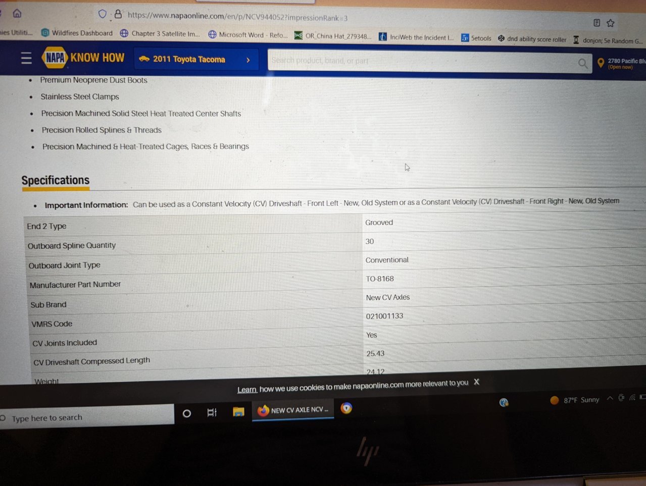

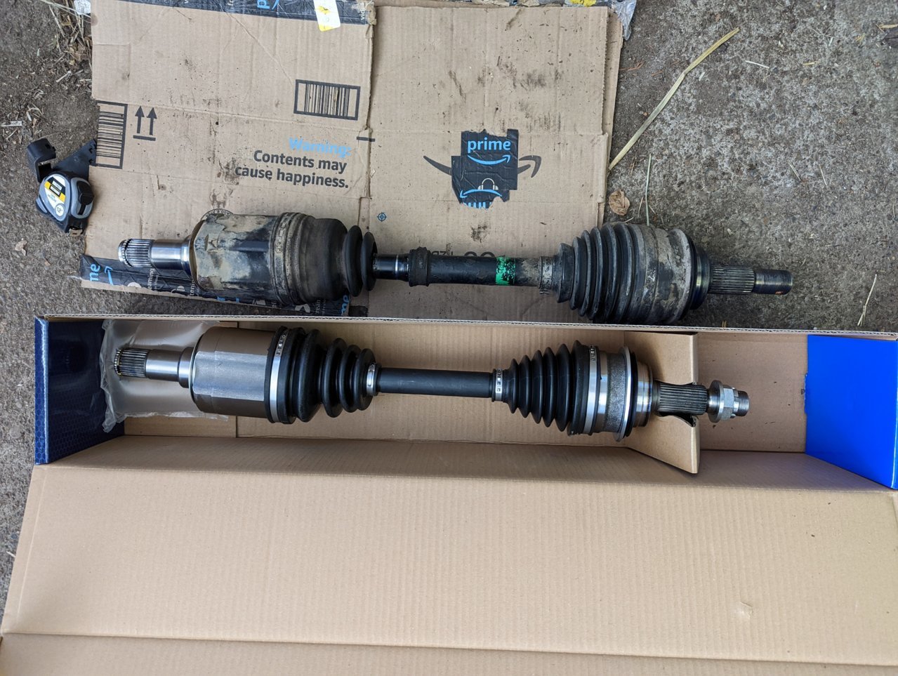

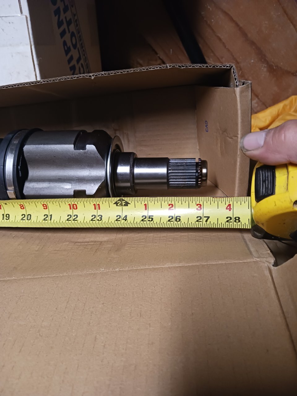

    Hey all, sorry if there's already a thread that addresses this. Poked around for awhile, didn't see much of a consensus on it.
    Replacing passenger CV axle, got one from Napa because cheap and in store. It's the NAPA Premium CV, Part # NCV 944052. I've got it all torn apart, the old one is aprox. 29.25", and the new one is aprox. 27" (measured end to end). Old one appears to be compressed, I can stretch it about a half inch. New one can be stretched about an inch, and also compressed probably about that much. It may stretch more, didn't want to try too hard though.
    From what I've seen, it looks like that play allows for not having an exact fit, but 2ish inches seems like a big difference, so looking for advice on if it'll work or not.
    I don't recall how much lift is on the truck, maybe 2 inches, not sure if that's enough to cause the issue or not.
    I appreciate any feedback. Also, let me know if more info is needed. Thanks y'all

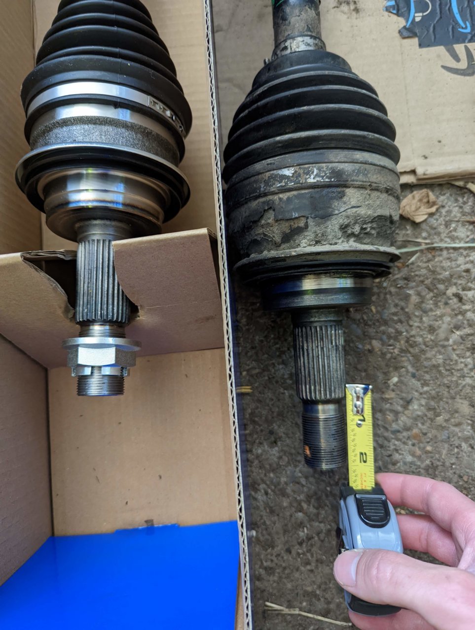

    The CVs have some play to extend and compress. Looking at the first photo, the inner boot is torn so it leads me to believe the axle may be extended a bit so you’ll have a false measurement. I’d compress the old axle and remeasure before returning the new one.
    You can also see where the boot clip groove is on the axle and how the inner boot is bulging. Both things that tell me your old axle is hyper-extended.

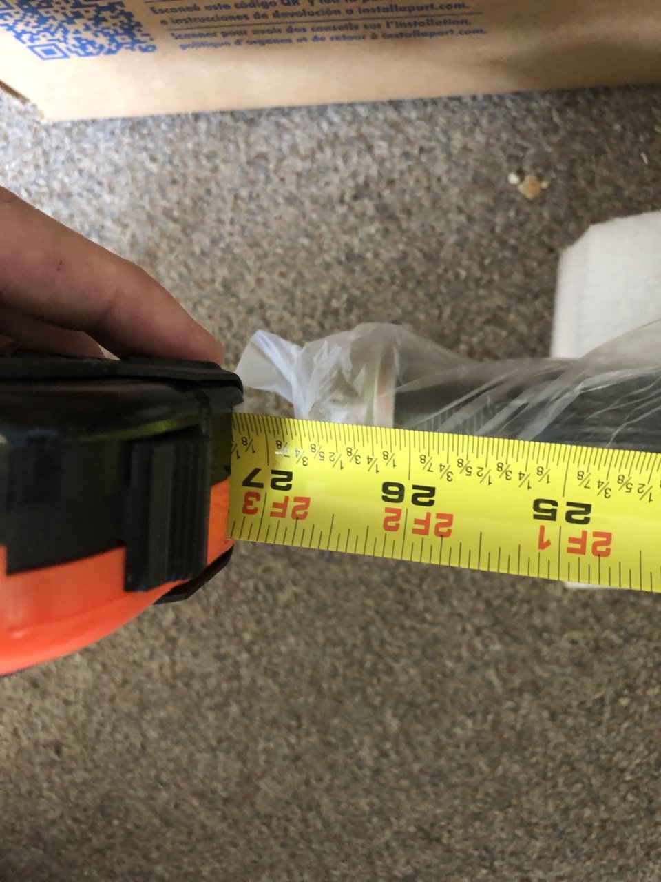

    I measured the other one and it is 27"

    That pic is with it fully compressed as far as I can tell. I hear a clunk when I force it together. I can stretch it to around 30.5" or 31"
    @AllTacosFloat Ahh, so that's what the other part is on the site. Welp, back to Napa I guess, thanks for the info!
    *edit. That box I got has the part # 94-4052, so it looks like the correct part

    @rnish the old one is completely compressed though and is still 29", the new one, where it sits naturally so, is about 27", and at that length can be both compressed and stretched.
    Also, the little warning in the book in the pic, is that just a GM thing that doesn't apply here?

    8DDE2C41-CB9A-49C7-B380-E4F42394773B.jpg Well mine is like 26.75”
    It stretches out a good bit, but the boot sucks it back in.

    So for anyone interested, I cut the boot off the old one, and one of the bearings on the tricycle gear was siezed up so the gear was outside of the housing and couldn't be pushed back into place. Once I beat the bearing loose, it slid into the housing, and was the 25.4", same as the new one from napa, so all is well. Got the new one installed, so far so good. Thanks for the feedback y'all!
