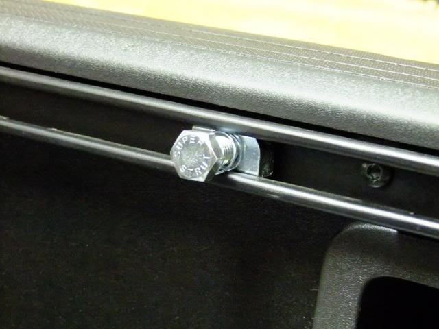

    No
    Like I post that My D-ring came today.

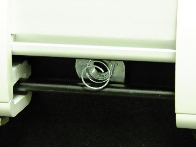

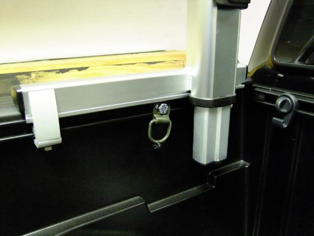

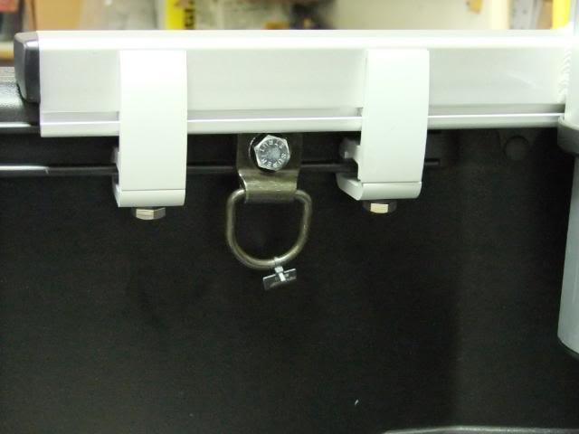

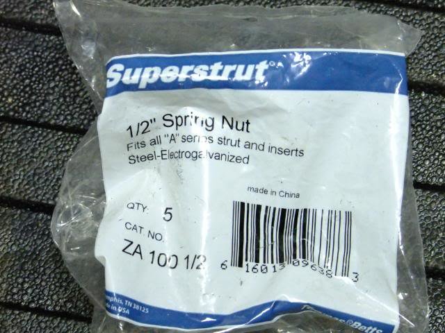

    Here a easy way to Install the D-ring on a Tacoma 2005- 2010 bed track
    You can get this from any Homedepot or some Lowe's and Eletice suppy place.

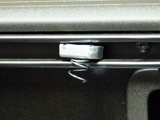

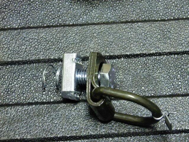

    I cut the spring shoter
    use spring to get in or out track.
    The D-ring work great.
    One thing I need buy washer to on top D-ring, to make easy to tied the bolts.
    No torque wrench to buy.

    I like that hook you have in the bed rail next to the cab.

    OEM Hook you can buy
