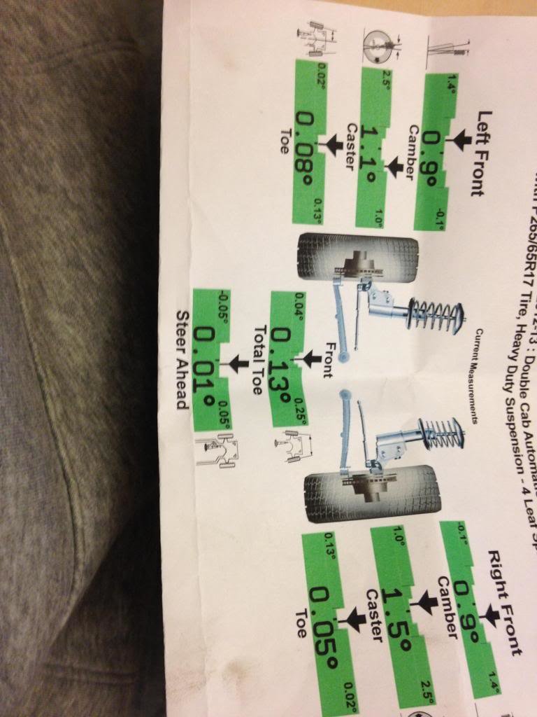

    I have a 3" lift with the stock UCA's and have no issues alignment is spot on. Unless your going to off road with it quite a bit I would go with all terrain's many have a great aggressive look to them such as the duratracs and you won't suffer with gas milage and road noise as bad.

    Same here, in fact im at the .85 clip on 8500 with the OME spring and 1/4 plate up top, stock uca and alignment is in spec.

    What are your alignment #'s ?

    3" Lift with UCA, Grillecraft grille, XD rims w/ 285/70r17 duratracs, leer xq cap,
    Within spec probably not optimal I know tho
