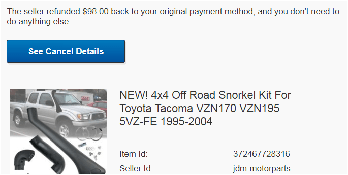

    The response I got was “the snorkel itself was crack and unable to use.” Guess I’ll wait till the next round

    says a lot about their QA - rare to see an overseas supplier reach out on a defective or damaged item. Impressive.

    yep, i told them I'm happy to wait for their next batch. :thumbsup:
