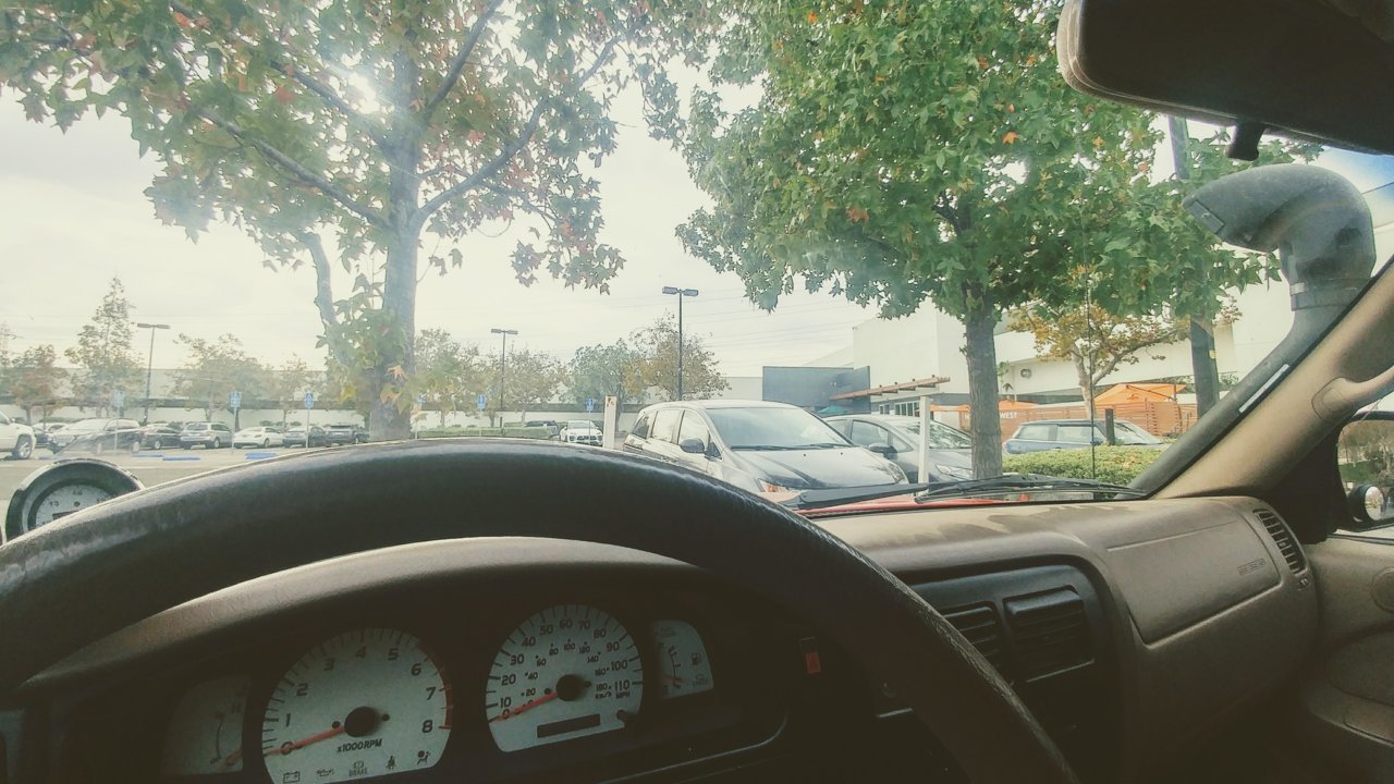

  16. Nov 13, 2018 at 1:07 PM
    #236
    tntacomaguy
    tntacomaguy Well-Known Member
    Feb 27, 2015
    #149703
    1,510
    Does the snorkel block much of the view out the corner of the windshield? Could one of you guys that has installed already take a pic from the drivers seat looking past it?

    It's a non-issue really...it hardly blocks much

    I didn’t notice any difference in view in real world use. I actually don’t even remember seeing it at all from the driver side, that’s how less it’s noticeable.
