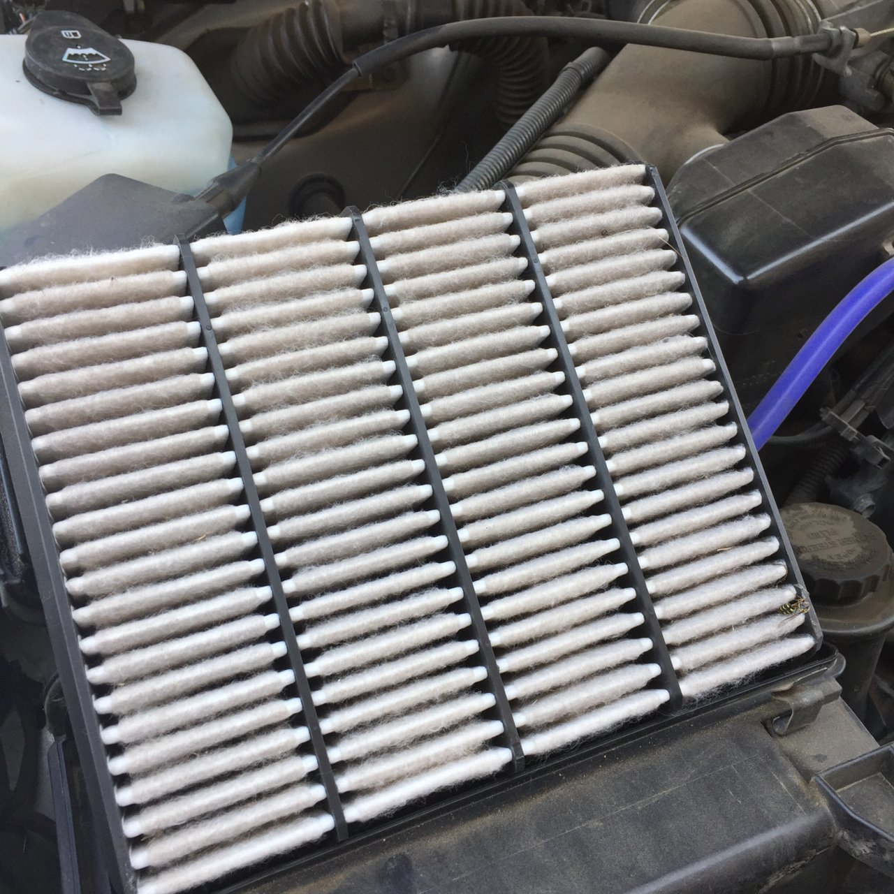

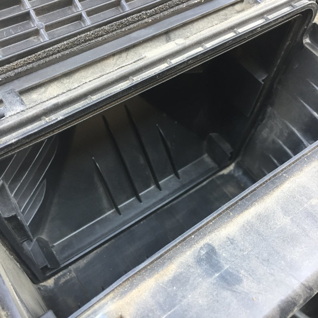

  18. Nov 14, 2018 at 1:37 PM
    #258
    TacoJohn4x4
    TacoJohn4x4 [OP] Captain Save-A-Ho
    Jul 10, 2018
    #258956
    1,028
    Central Valley
    2002 Tacoma DC 4x4
    Great for my wood floors but will mess up your pillar anyways :)
    So I had time to inspect my truck today after the trail run last week. Snorkel is on tight still. Wiggle and shook the whole truck with it. Keep in mind I still haven’t screw the top bolt in the fender. Also got a chance to put on the missing clips to the fender. While the fender was off I inspect the rubber and plastic intake tub. Nothing was sucked in or collapse. No screws were lose either. I inspected the air filter and it looks the same before last weeks trail run. Photo will show air filter with two trail runs, one run without the snorkel on and one with a snorkel. Very heavy dust on the last run because there was at least 10+ Tacos.
