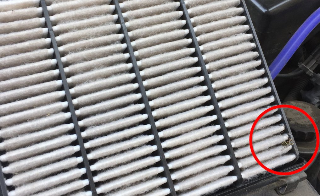

    Funny you pointed that out. I saw that but didn’t think much of it since all my other filters have some short of bugs in them as well :) I also did see a bug on the prefilter head too.
