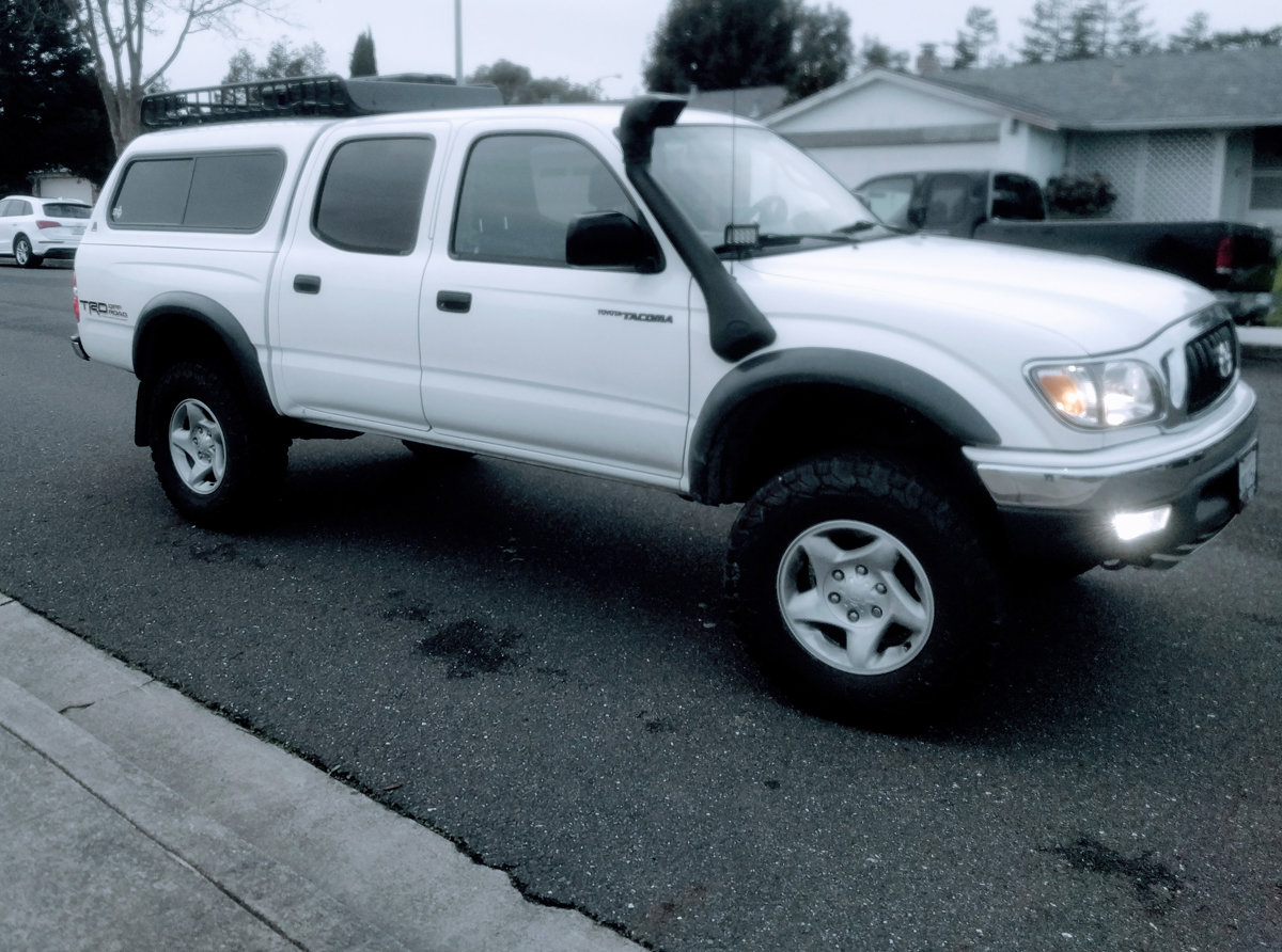

    Secured the snorkel bracket to the a pillar using nylon inserts (like the ARB snorkel - at least the ones I came across on youtube).
    As for that top nut on the snorkel itself, I GOT IT. So messing with it again, washer slipped off and dropped down where the fender connects to the cab. I could not get it out of that little space no matter what I tried. There are 2 bolts which secure the bottom of the fender to the cab. Removed those 2 bolts and was able to retrieve the washer. Removing those 2 bolts actually allowed the fender to pull away a couple of inches. Pulling it away was just enough to get that last bolt on!
    If the nylon inserts loosen or become an issue, I will pull them out and deal with riveting it in place but for now everything is together - finally.

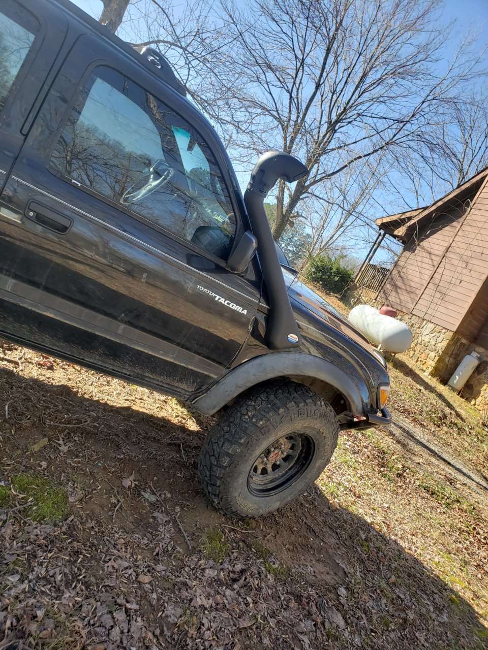

    Looks good! Finally got around to getting some pics of mine as well.20190112_150706.jpg 20190105_114732.jpg
    Dont mind the crushed fender. Haha.
