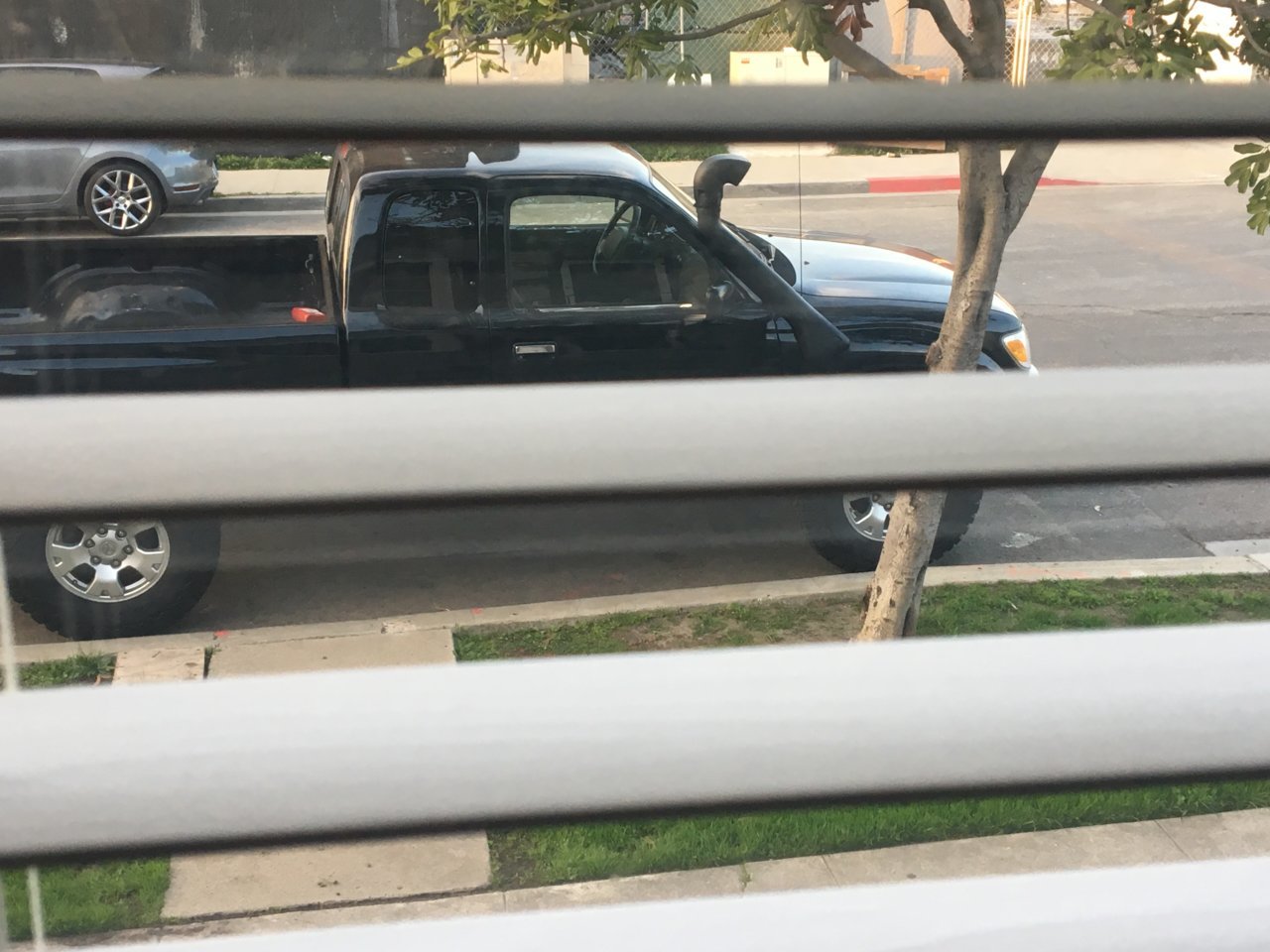

  6. Jan 29, 2019 at 2:48 PM

    1999 Tacoma 4x4
    I made a gasket to fit in between the snorkel and the fender and the spray is a adhesive to stick it to the snorkel

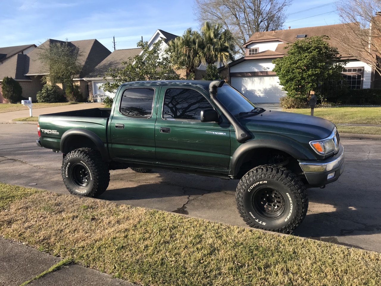

    Got it all installed today! Thanks everyone for your help! Getting the plumbing all worked up was a PITA, when the hose is smaller than the the pieces it’s supposed to go over :annoyed: I tried to do the snorkel test and seem to have an air exchange where I liberally applied the rtv. Will probably go back later and address that.

    Yea I knew going into this that the worm clamps weren't going to suffice because you can't really crank them down. I found two V-Band clamps locally here at a diesel shop, and used those instead of the worm clamps. The only place I am getting air exchange is where the two factory intake pieces "mate"

    you dont actually have to take the rubber hose off to replace the clamps, with the worm clamps just loosen them all the way and youll be able to separate them, and with the v-band clamps you can take the nylock nut off and open it up, then assemble it back onto the hose.

    Install went nice and easy! Got a spot right outside my house so I can just stare at now

    The v-bands are definitely enough, you can actually crank them down pretty tight where as the worm clamps will slip if you try to tighten them down too tight
