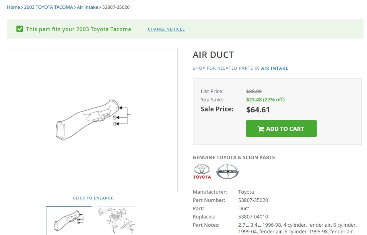

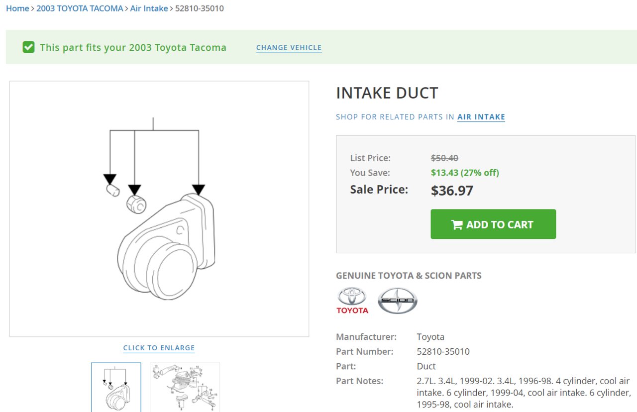

    Do you happen to know what OEM part # that is you’re holding? My truck had an aftermarket intake, which didn’t pass CA smog, so i got a factory box from another tw member, but I believe my box just goes into the fender hole from the inside & doesn’t have a curved part that runs inside the fender to get it to the rubber hose connecter that comes with these kits?

    Mine did the same thing, I didn't have the inner tube inside the fender. Ended up getting one off of a TW member on here that didn't need it. You can order it through most parts depts. I think I remember it being like $40. Or make a thread on here and see if anyone has one laying around that they don't need after installing a CAI

    below taken from camelback toyota -
    So the piece that attaches to the airbox and goes through the fender plugging into the stock intake duct (which then connects to the snorkel air tube/hose of course) is :
    the duct is:
    Trowbocop likes this.

    Thank you!
