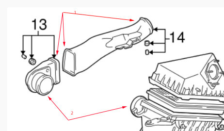

    @Area51Runner Do you have any other ideas on making the two factory intake pieces more air tight? :confused:

    Other than heavier duty clips you suggested and perhaps the fusion tape or a nice silicone bead around the tube openings, no. I thought about going with a heavier duty hose to replace the plastic duct but that would be excessive.

    You're talking about the duct that connects to the factory elbow right?

    Yes. I don't really want to mess with #2 (see image red arrows). If its leaking there, so be it. I have to smog the truck in a couple of months and dont want to mess with removing that elbow and putting in some type of flexible 1 piece air hose with a clamp to fit over the airbox side only to have the smog tech have some kind of freak out because I 'modified' the airbox o_O with an aftermarket connection instead of the OE elbow.
    For #1 and the hose to snorkel side, if air is escaping there because of that clamp, I think the fusion tape is going to be the answer. Worst case, if it needs to be removed its a simple slice (i hope lol)
    Will try to mess with it this weekend and report findings.
