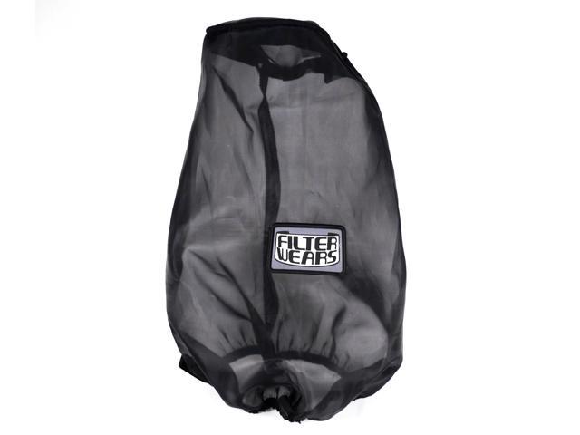

    Why not stick one of those pre-filters bags inside the top before the cap piece. Will help keep the debris out and also flicks away water.
    eon_blue[QUOTED] likes this.
  10. Feb 3, 2019 at 7:24 PM
    #770
    Trowbocop
    Trowbocop Adventurer
    Apr 3, 2012
    #76190
    1,781
    Nashville, TN
    03 Tacoma SR5 4x4
    Yeah, I loosened the fender, stacked some washers under the bracket & it still was in the way. Chopped it and left the washers cause I didn’t want to take it all off. Don’t be bother with the washers, just relocate your light & chop the dang thing.
    JKO1998[QUOTED] likes this.
  11. Feb 3, 2019 at 7:27 PM
    #771
    eon_blue
    Mar 4, 2016
    #180213
    69,806
    Azusa, CA
    I'd give it a try, just worried about air restriction especially with the extra demand via the supercharger...if the airflow isnt adequate it'll cause a lean condition under throttle which is bad news for boosted motors

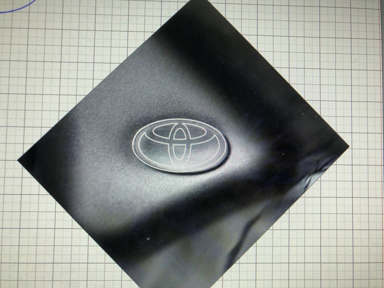

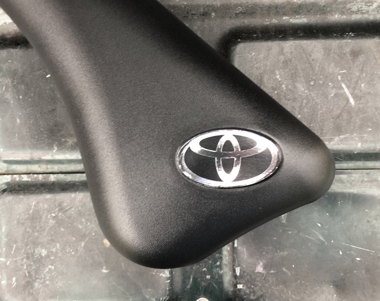

    What’s the general consensus for the oval recess for the ‘brand’ sticker? I scanned it and made an oval for the vinyl cutting machine my wife has. Not sure what to put there though. I can only do single colors at this time and I do not know how long a piece of vinyl would last on the black plastic.

    Annnnnnnd that’s the one I’m talking about.
  16. Feb 4, 2019 at 1:42 PM
    #776
    eon_blue
    Mar 4, 2016
    #180213
    69,806
    Azusa, CA
    I'd be interested in putting a different sticker in that "4x4" sticker spot, I left that sticker off intentionally since I don't really care for how it looks. A Toyota emblem would be cool

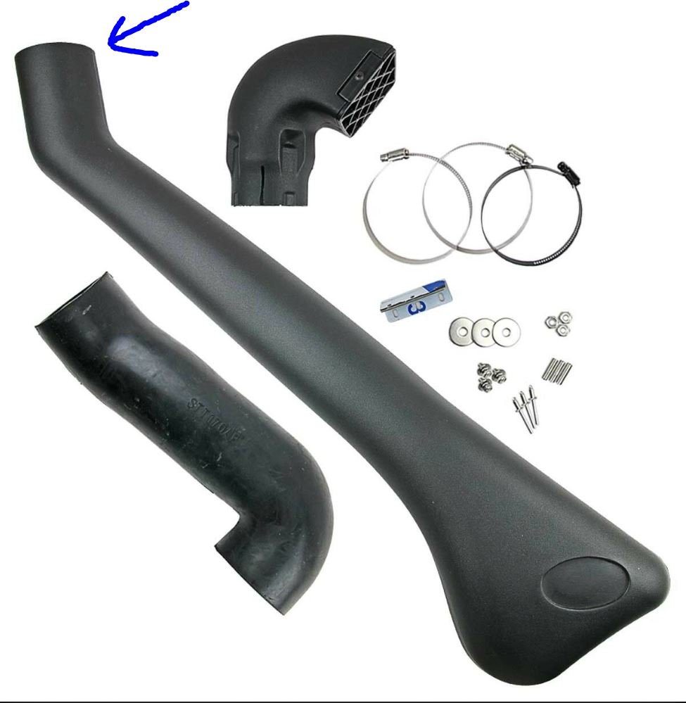

    Can I install it like this or do I have to take it off?
    Look like there was a bit of room on the template.
    Trowbocop likes this.
  18. Feb 4, 2019 at 2:00 PM
    #778
    eon_blue
    Mar 4, 2016
    #180213
    69,806
    Azusa, CA
    I doubt it...the 3.5" hole isn't very big, dunno if you'd be able to work the tubing through it with the two pieces together like that.
  19. Feb 4, 2019 at 2:03 PM
    #779
    JKO1998
    JKO1998 Well-Known Member
    Jun 2, 2015
    #156578
    53,024
    Utah
    Well I’m definitely gonna try, if not maybe having stretches of the tube will help me out a bit.

    Just something quick. I’ll give it some thought in the next week or so. I wish I could ‘wrap’ text to fit the oval but this program won’t do that.
    I’m not liking on it too much though.
