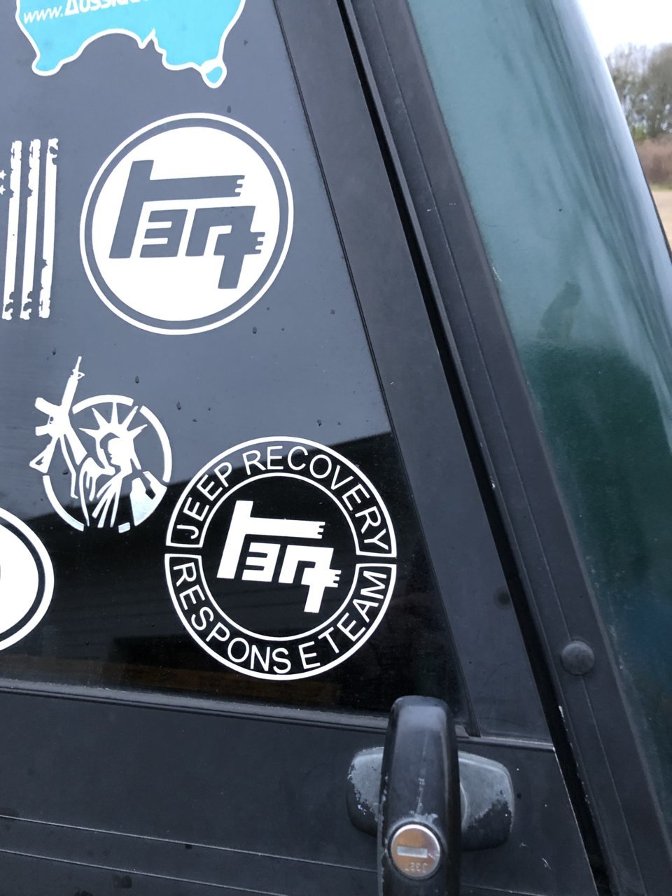

    What about the old Toyota letters? TeXX Or whatever? That might look decent. If you know what I’m talking about anyway.
    If I put anything there it’ll probably The the badge that came with it, cause it’s funny.

    I ordered a gel badge from wheelbadges.com

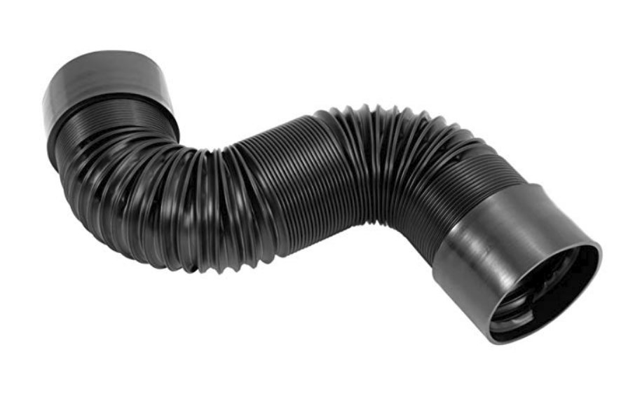

    I fed mine in and out multiple times assembled like that. Just squeeze the rubber and bend it around the antenna inside the fender, you’ll be alright.

    I’d try and see if in could slide the rubber part farther on as well. For what’s it worth, I even had my hose clamp on when I passed it through. Didn’t want it slipping around or off.

    This one? I just can’t make it ‘wrap’ into the oval with my program.
    Nice. I would rather have a gel badge than just a vinyl sticker/decal. I’ll be looking into those now.

    this... I really didn't have an issue either. With all the 'delays' this seller has had who knows how many suppliers they have used. @JKO1998 - maybe work that thing on there as best you can, heat it up and then leave it attached for a few days. Maybe the cold weather is playing a factor.

    I’ve got it on and clamped down, I’m gonna feet and install it with it on and see how it goes. Is the end that goes into the on the air box a bitch too?

    perhaps a matted out dark gray devil horns emblem?

    it shouldn't be at all. Not sure how that's going to work trying to install it with the hose on the snorkel end. Going to be a bitch fitting it into the fender i imagine. :fingerscrossed:

    Trowbo said he did it a couple time, unless I misunderstood.

    Can you take a full shot pic of the snorkel with the tube attached? That doesn't look right from the angle - maybe just me...

    Oh it might not be, I can spin it a little if I need to.

    Can you shove a large glass or can I to it then pour in some boiling water? Not sure if it’d keep the new shape after it’s cooled off though.
    If you have space enough in a freezer can you freeze it all put together. Then remove the snorkel after it’s good and cold while keeping the rubber piece in the freezer until the last minute for install?

    I boiled it to get it on, seemed like it help. Was hot as fuck though and I’m too stubborn/lazy/dumb to get gloves.

    You sure can! That's how got mine in. It'd be impossible to put the rubber hose on after the snorkel was bolted on.
