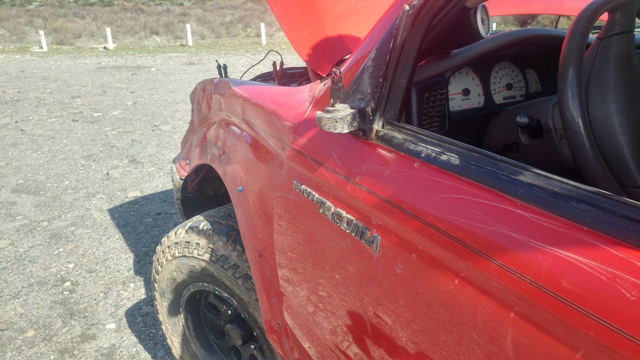

    On the other hand, if you were to hit a tree or wall on a narrow trail (like I did recently) and destroy your fender, if the snorkel isnt attached to a-pillar then you'd have way less damage than if it was.
    If I had hit the snorkel side of my truck last weekend I'd be looking at WAY more damage. Fenders are cheap and easy to replace, if you rip the snorkel off the a pillar or push the snorkel into it that's gonna suck

    What happened to me last weekend was I got pulled into a rut and slid sideways into a wall of dirt...
    If that had happened on the snorkel side it would have smashed the snorkel into the a pillar and I shudder to think of what kind of damage that might have done
    Fortunately this incident only resulted in a new fender and mirror...and a lot of touch up paint

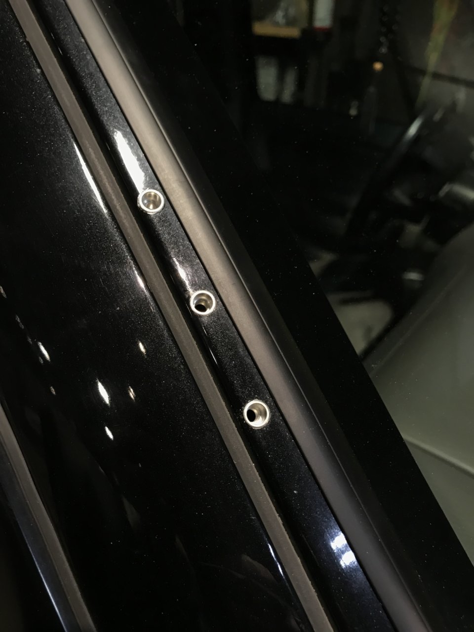

    Yep, totally agree. Its a definite risk given how flimsy that a pillar really is. I posted this way back in the thread but check this out - this guy uses inserts on the a pillar to screw the snorkel in .vs rivets or self tapping screws/bolts. Notice how it appears he kind of dents the a pillar as he's smacking that insert into place... check it -
    https://youtu.be/ifPYNaoddsI?t=266
    So a before snippet (from the video) -
    After a couple of smacks -
    I know this because it happened to me as well :facepalm: on the middle insert. Not that bad and once the bracket is in place, not visible at all but just knowing there is a tiny dent there.... :annoyed:
    I went with the inserts because I wanted the bracket off of the a pillar and not sitting on it directly. Oh well, lesson learned. At least I siliconed those holes before putting in the inserts.
    Point to putting this out there again - yeah, that a pillar is so pliable its scary. Not saying that the tube shouldn't be secured to it - personally, I think its a good idea to do so. It is how it was designed so there's that... hahaha

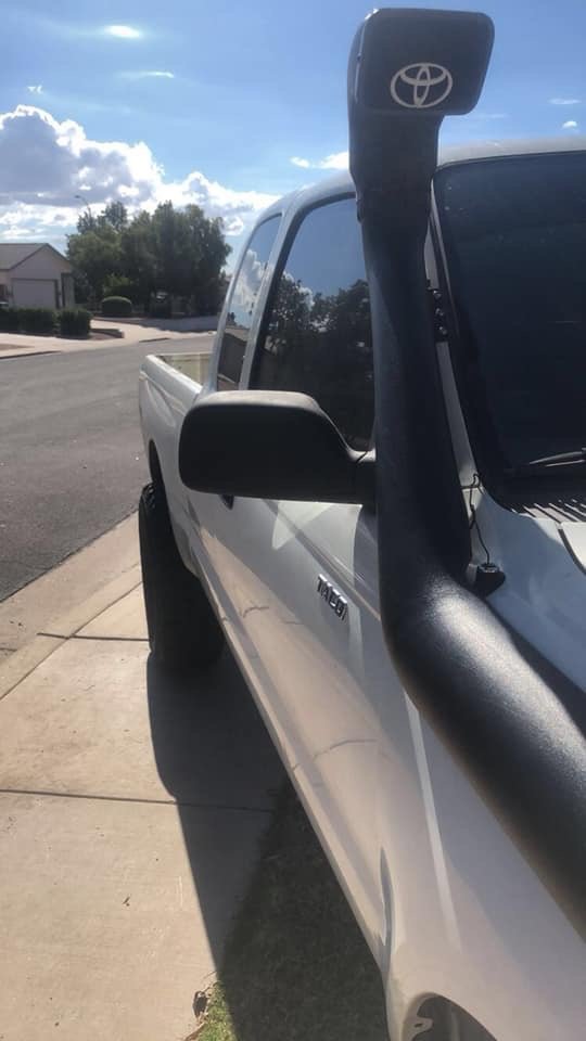

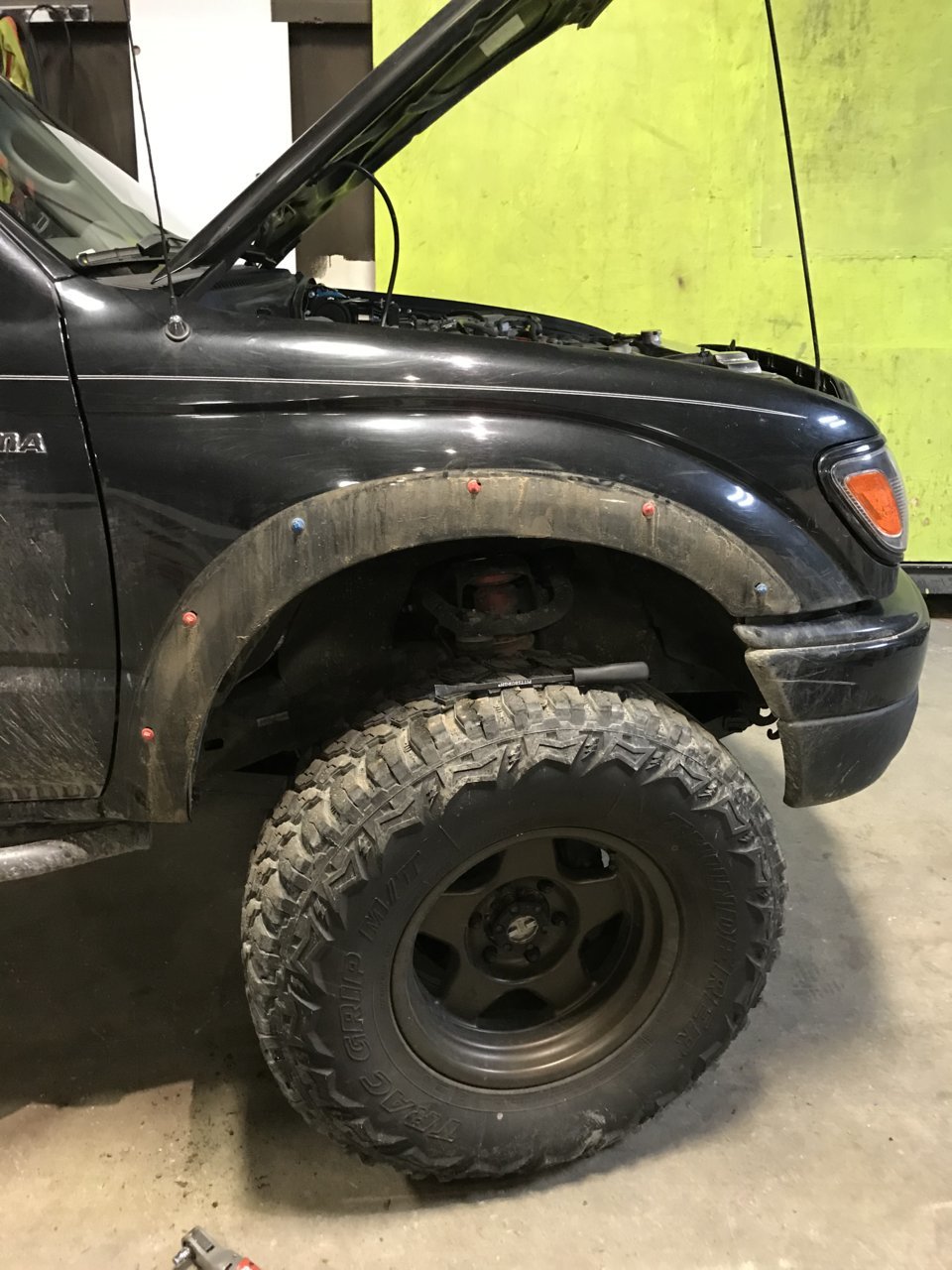

    Got mine installed 80%. Still need to hook up the tube inside and install the fender liner back with the fender trim. Here are a few pics.
