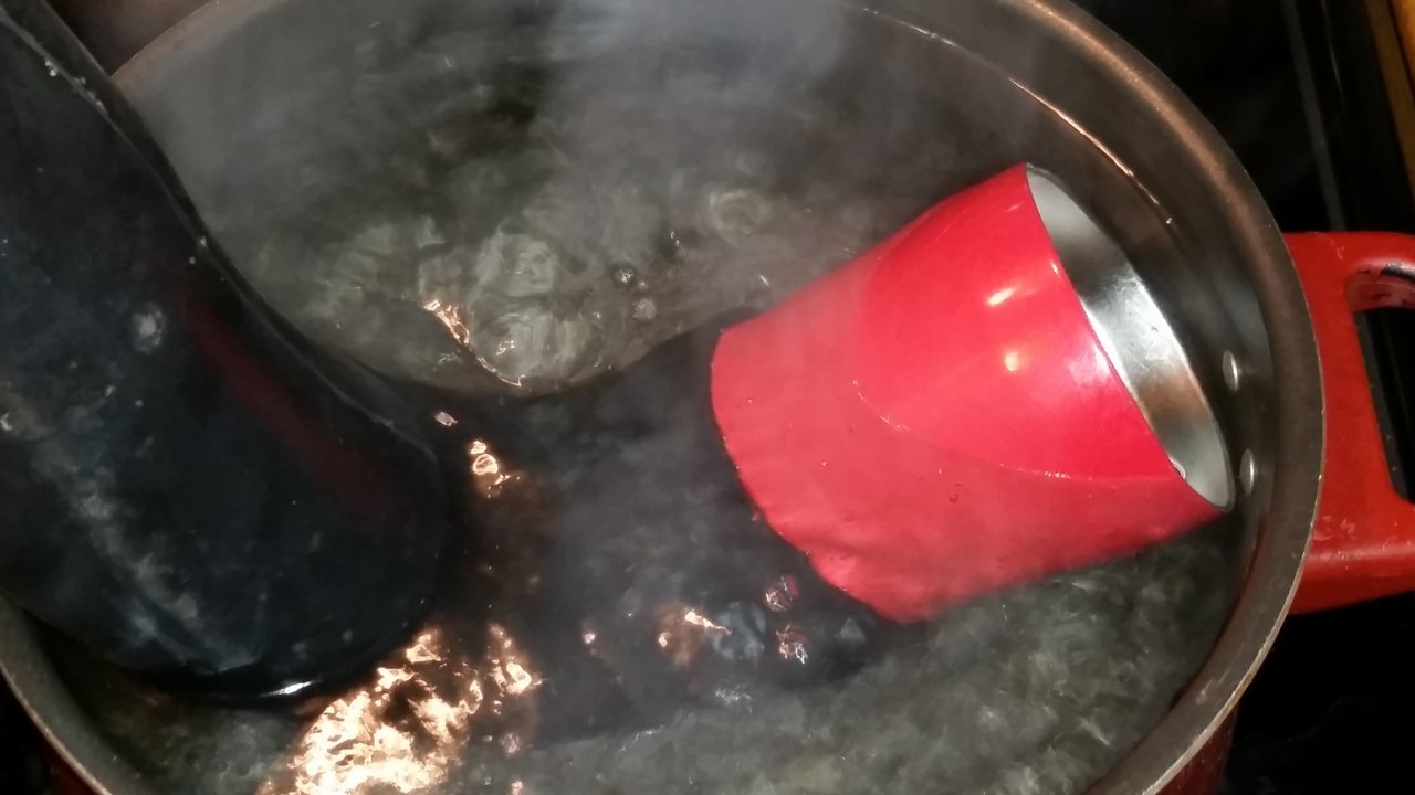

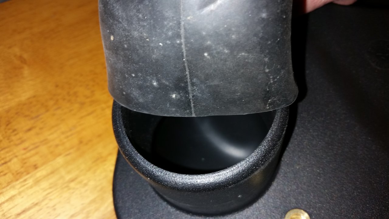

    Okay, so I'm a new member of Tacoma World and I guess this is as good a place as any to make my first post. There is going to be a learning curve for me here so let me apologize in advance.
    I've been following this thread for quite a while now. I've always wanted a snorkel for my truck but the ARB has always been out of my reach. Actually not so much out of reach, just not wanting to spend that kind of ridiculous money for a piece of plastic. I've heard all the arguments that it's the "engineering" and the "Grade" of plastic being used and of course the classic "You get what you pay for". In a lot of cases you do get what you pay for but this is not one of them. In this case you get much more "in my opinion".
    I ordered my snorkel last Wednesday 2-27 and it was at my door this morning 3-4. This kind of shipping has to be some sort of world record. I've ordered stuff from that area before and it take months sometimes. The shipping was crazy fast.
    My snorkel arrived in great condition. Best I can tell all the parts are there. The snorkel and cap look great. All the mold marks are neat and clean. Everything lines up well.
    I have experienced the one issue that a few others have experienced. The rubber hose that goes on the snorkel is stupid tight at the snorkel end. However I did get it on.
    I did what I saw someone else had done and that was boil a big pot of water. I've used this technique in the past with other projects and its pretty effective. To add a little more to it I used a Walmart YETI knockoff cup to expand it as I boiled it. Twice I took it out of the boiling water and stuck it in the freezer to help the rubber take a set or a form if you will. The last time I took it out I slid it onto the snorkel. I put a good layer of Vaseline on both and also on the cup when I was using it to expand the tube. I also used a really dull butter knife to get it that last little bit. I started to use my radiator hose tool but was concerned that I might poke a hole in it so I opted for the butter knife method another member mentioned. It went on like butter.:thumbsup:
    Going to try and upload a few pictures to give you a better idea of how it all worked.
    Should have joined Tacoma World a long time ago. I own a 96 and I'm the original owner.:)
    It will be at least a week or more before I'm able to finish but I'll post up when I do.:fingerscrossed:

    I used same method as you "coffee cup expansion mod" lol

    That's awesome. Just seemed to be the way to go for me. I had the tube installed and the kitchen cleaned up from all the boiling before the wife got home:) She doesn't have a clue that I used one of her good pots. Now I'm waiting on a hole saw that I'll probably only use this one time. Still cheaper than the ARB:thumbsup:
