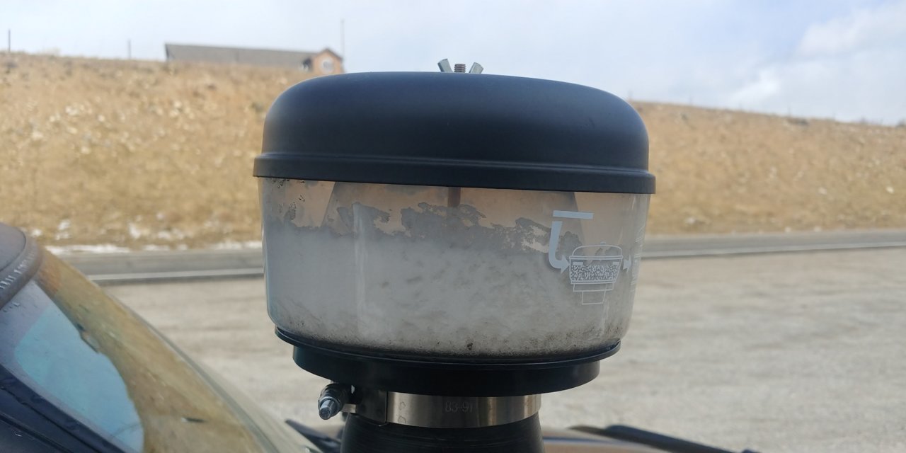

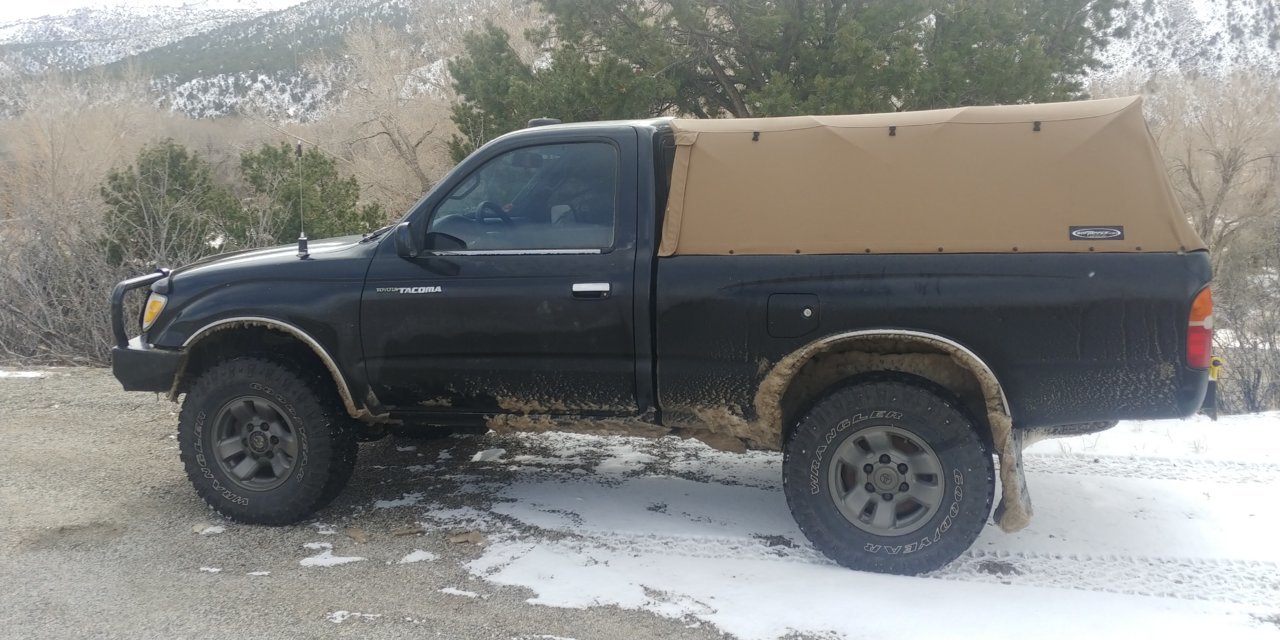

    So I said I was going to update this tread on how well the prefilter does in filtering snow out of the snorkel.
    This was a solid 75 miles of my drive today, cruising around 50mph. It got to the point of white out a few times. Blowing snow, following trucks, climbing passes at 3k rpm for 15 miles, and so on.
    With the old snorkel head it would have sucked up a ton of snow and eventually clogged the tube or flooded the air box.

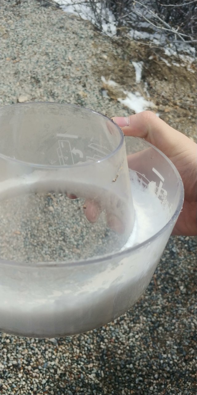

    Here is the amount of snow the prefilter collected during the drive. Keep in mind because it sucks in air from the bottom it already reduces the amount of snow significantly. 1114201121_HDR.jpg
    It easily was tapped out and even if it melted it would have just remained in the containment area.
    To me it appears to be a win! At least for those who drive through snow storms on the regular.
    And here is Burt after all that driving.
    Mud flaps for the win! Too bad I'm missing the most important one... If anyone had a front driver side mudflap they don't want, let me know.

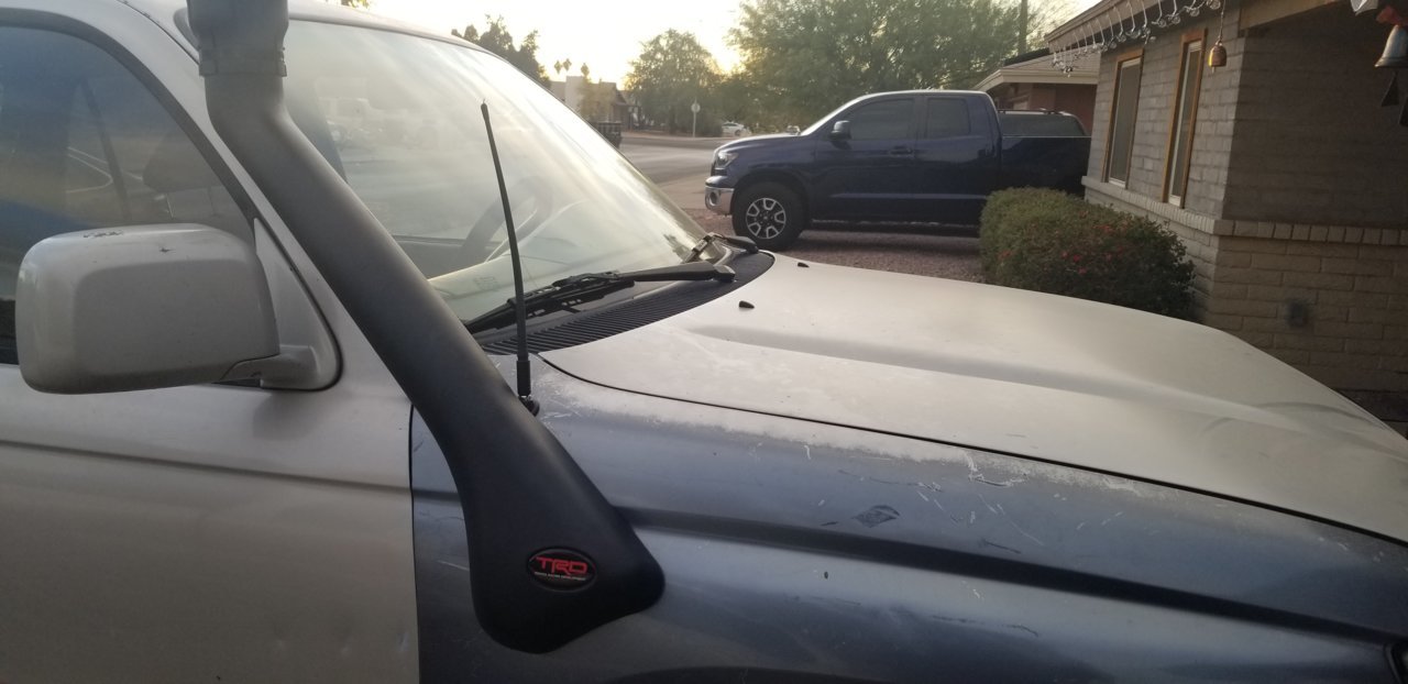

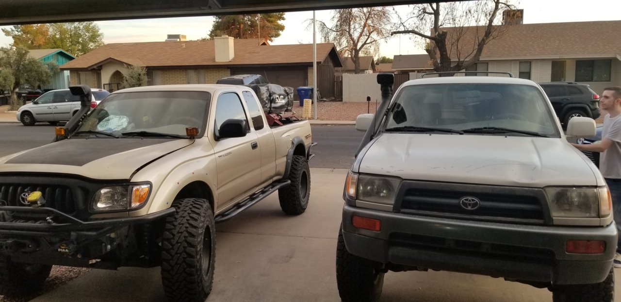

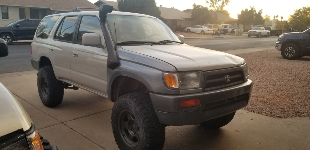

    We finally got around to putting one on my sons T4R been hoarding if for a few months. His came with stickers for the head too which is cool otherwise it was exactly the same. I think i got his for 120 .

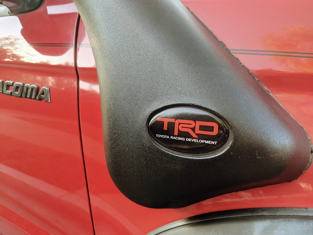

    FYI guys who are just getting these or perhaps didnt see this before, I have all 3 designs back in stock for the snorkel badge.
    Gray TRD
    Red TRD
    Stripes TRD
    its still $14 shipped in the US for the badge, they are 3D domed with clear resin so its an actual badge.
    <-Start a conversation with me if you need one!
    Kens04Taco - Got my gel sticker from @CBoy808. Looks great thanks again bud!
    Photo from SafetyDang
    Photo from chrslefty
