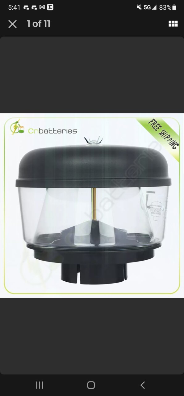

    Anyone use a prefilter with there snorkel? Any recommendations?
    Taco_Sam_96 likes this.

    I've seen a few of the foam style that just slip on. Seems like it was on eBay but its been a while. They were kinda pricey.

    Installed this past week 70 for snorkel, 20 pre-filter
    SwampYota, Brake Weight and chrslefty like this.

    Dose anyone know the measurement of the upper tube. I was going to order a new precleaner but im like 400 miles from home. Could anyone help thanks.

    chrslefty[QUOTED] likes this.

    Awesome thanks!!
