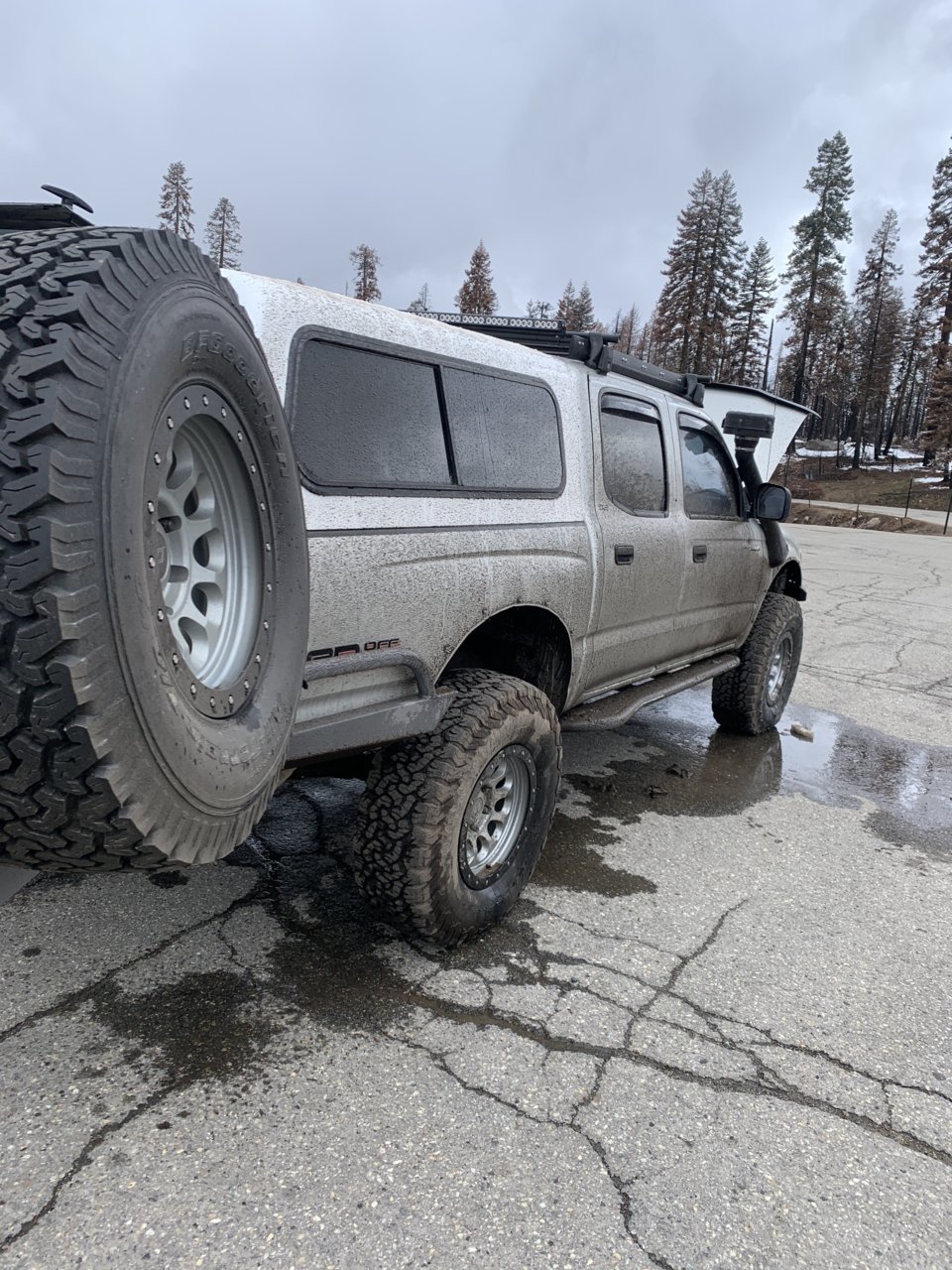

    An update of over 2 years and still holding tight considering I don’t have one of the three nuts in place at the base. Still water resistant with snow, rain, low water crossing, and mud.

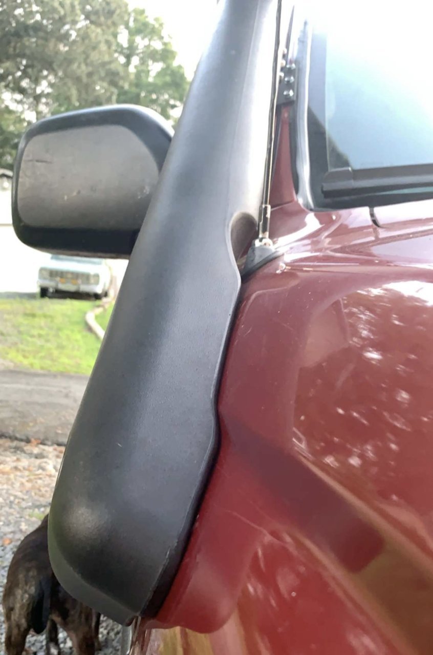

    I've got to say this exact ebay snorkel has worked for me and done what it needs to do. I've had it on for about a year now and it shows zero signs of fade in the plastic, it also has no cracks or defects, ect.
    Area51Runner and SwampYota like this.

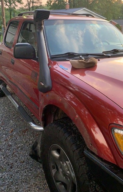

    2003 Toyota Tacoma DCSB 4x4
    Here is another picture of the lines matching up on the vehicle.

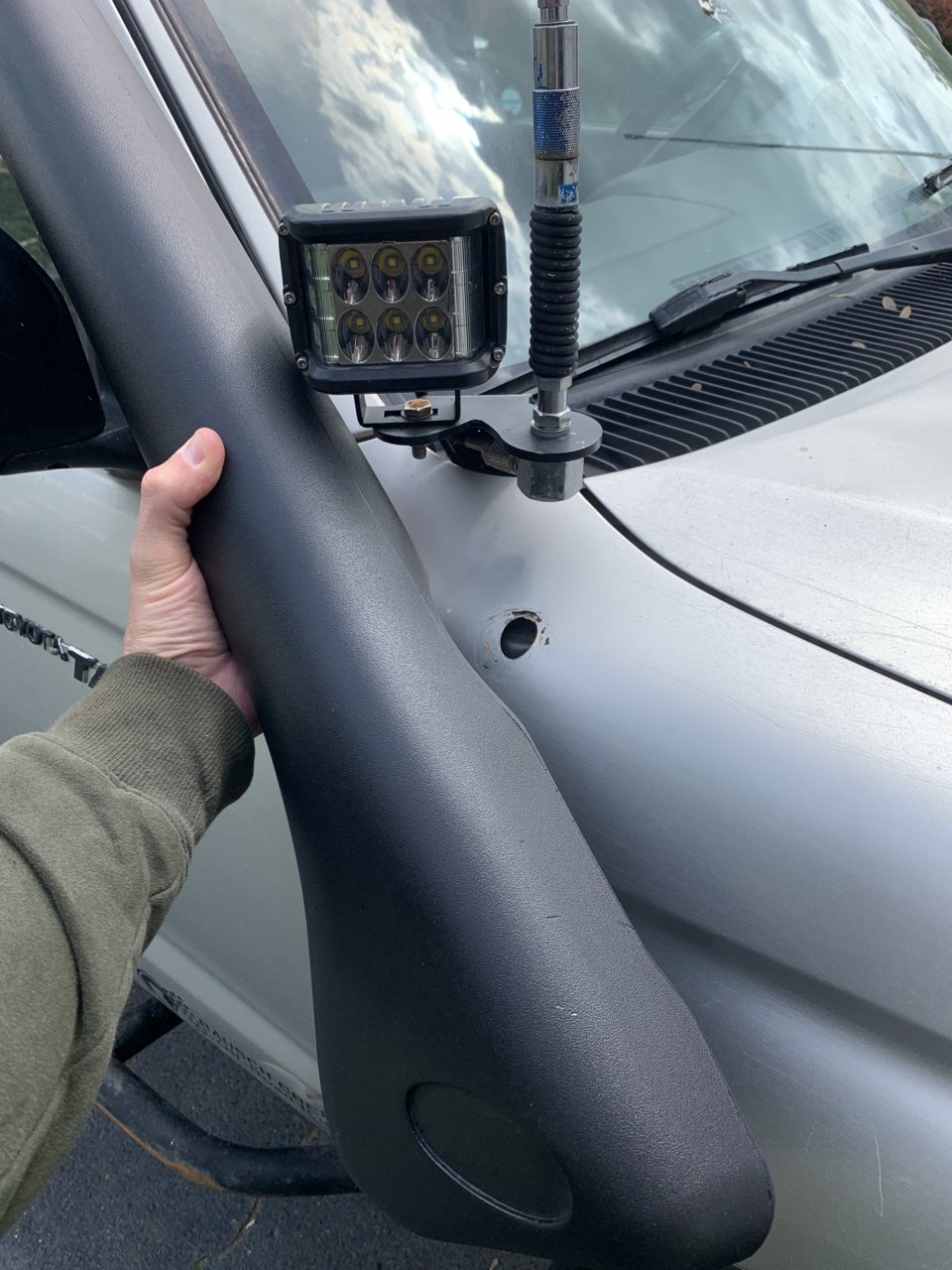

    Drop bracket lift and booger welds
    Son approves.

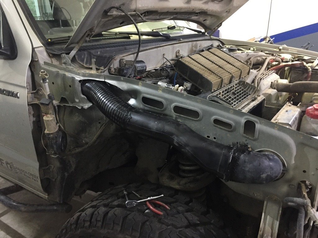

    So it looks like I’ll need to potentially grind the cbi bracket and redrill the hole like you guys mentioned.
    I also might need to pull the fender off to get this old setup out:
    Area51Runner likes this.

    You may be able to snake that old stuff out if you remove the wheel, too. If you're running 10 or 11m radio have you looked into the Wilson Trucker base load series? Not near as intrusive and has a small whip on top of the base. That heavy one will get to flopping around and beat up the snorkel.
  14. May 7, 2021 at 4:32 PM
    #1394
    cynicalrider
    cynicalrider #NFG
    Jul 25, 2012
    #83399
    17,154
    Jersey
    01 SR5 TRD 4x4, '23 Bronco Wildtrak, 2017 HSQV FE350
    the radio won’t be an issue, it doesn’t even hit the ditch light. The ditch light location is though.
