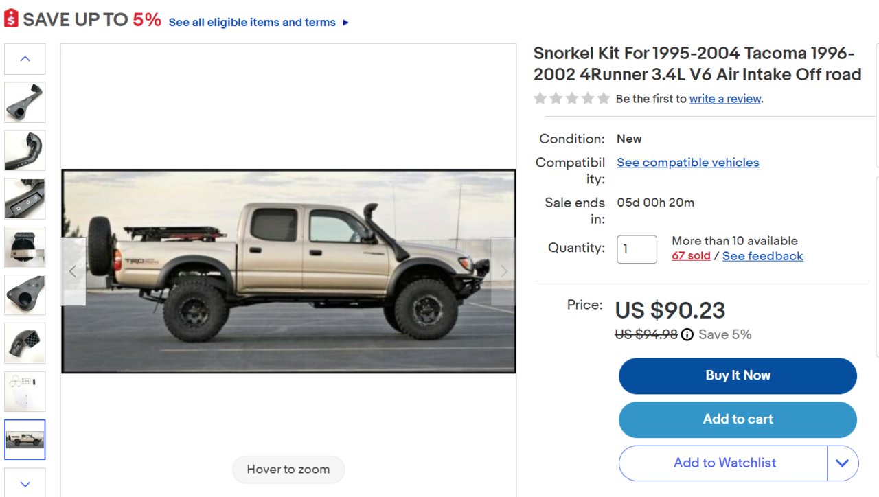

    Seems like a lot of inexpensive snorkels back on the market, looking at the other links in those Ebay ads. Weird how it seems to come in surges, then prices go up, then they get cheap again. I've had zero complaints with mine (I assume they're all relatively the same) going on 4 years now. Had to replace some of the screws with new ones that don't rust over so easily but that was it.

    Dang it. You guys are a bad influence on me. I'm gonna order one of these ebay snorkels now.

    Well, I was watching the snorkel on ebay, and the seller sent me an offer to sell it for $65. Can't say no to that. I'll try to get it installed this weekend.

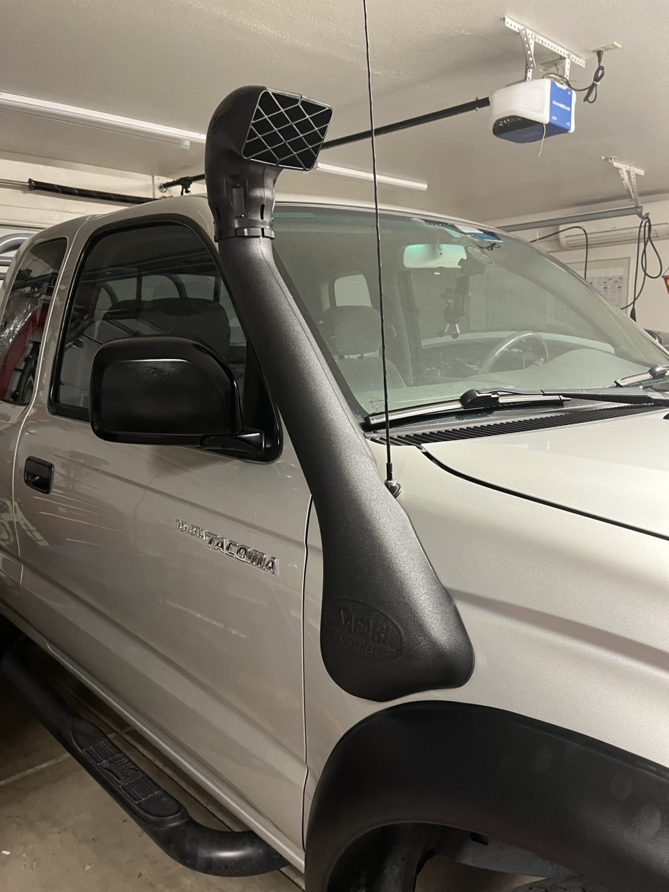

  20. Nov 21, 2022 at 7:16 PM
    #1440
    koenbro
    koenbro Well-Known Member
    Feb 7, 2017
    #209951
    285
    Phoenix, AZ
    2001 Tacoma SR5 Xtended cab 3.4L 5Spd
    Brake Weight likes this.
