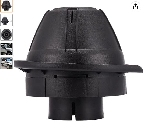

    Been looking at pre filters and wondering if anyone has tried this cheap ebay/zon design?
    @TacoJohn4x4 - noticed the pre filter you went with, do you have a link to it? Also looks like you used a reducer (?)

    So I did try the first one listed above. Not 100% confident on it's side drain holes - it doesn't leave as much gap as the snorkel head which comes with the snorkel.
    For reference, anyone looking to put a pre-filter on this snorkel, you need to find one with a 3.5" id inlet. Anything else and you'll have to use an adapter sleeve.

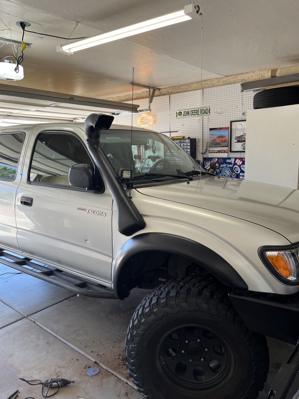

    Another successful Chinesium snorkel installation: 45F135DE-13E6-437F-9687-799A4EB28871.jpg

    Dang the price sure came down on these.

    yeah they did! I think I paid almost double that when I got mine. Still better $120 than like $400 for arb.
