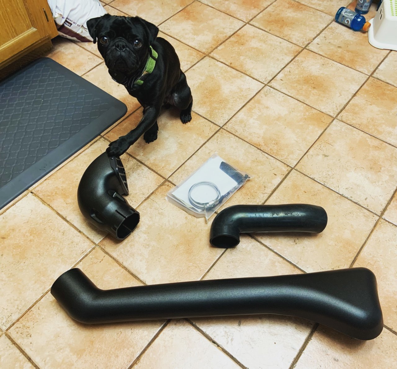

    Just received my ebay Snorkel in the mail today.
    1st impressions: dang. this thing is pretty well made. the plastic is decently thick, the rubber hose fits smoothly on the snorkel attachment, and comes with template and necessary hw. i used @jacobrippey's ebay link.
    this version of the tube does NOT have the oval logo area, the exterior is smoothed out.
    my dog decided to model it for you all.
    now I need to see if i can borrow the appropriate hole saw from my mechanic friend... :)

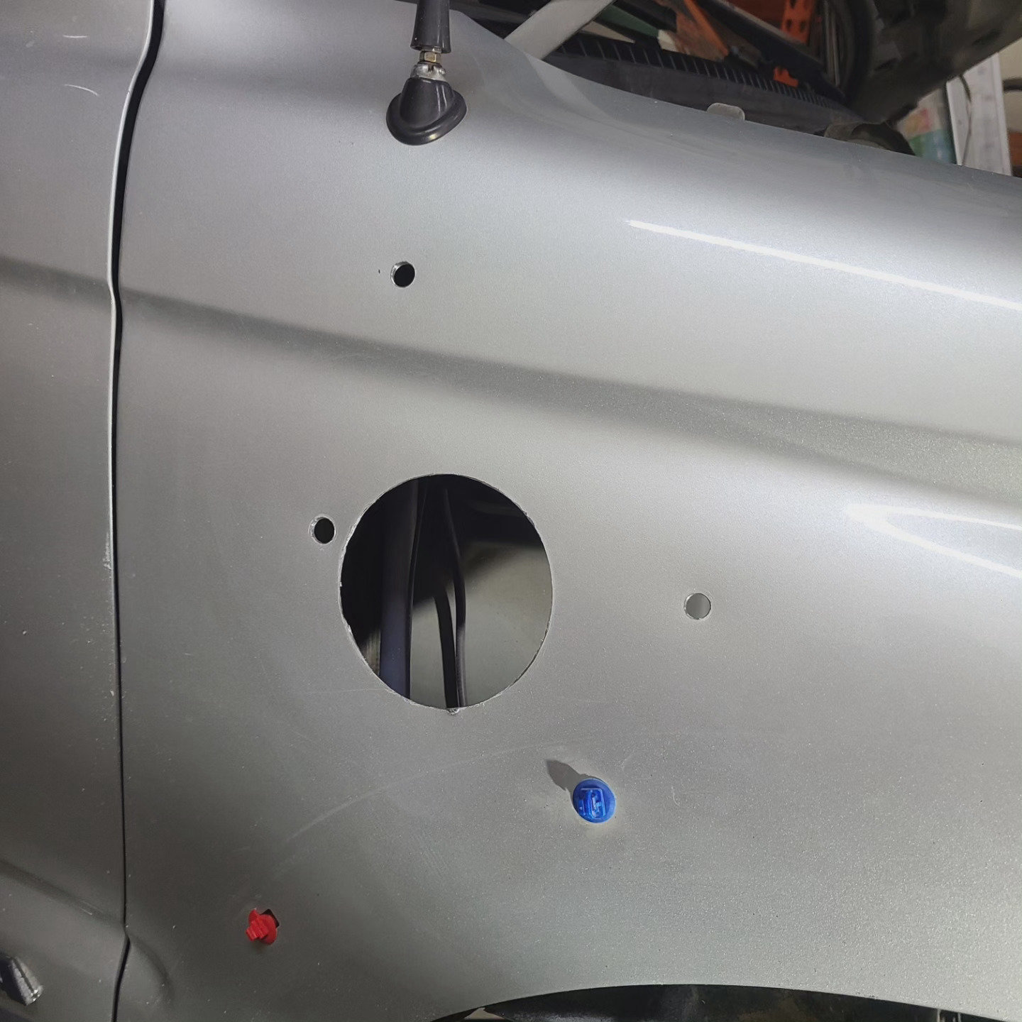

    I cut the hole for mine with a Harbor Fright stepper bit and tin snips. Was close to perfect but is completely covered up by the snorkel itself. Don’t forget to spray a little paint on the bare metal before final installation.

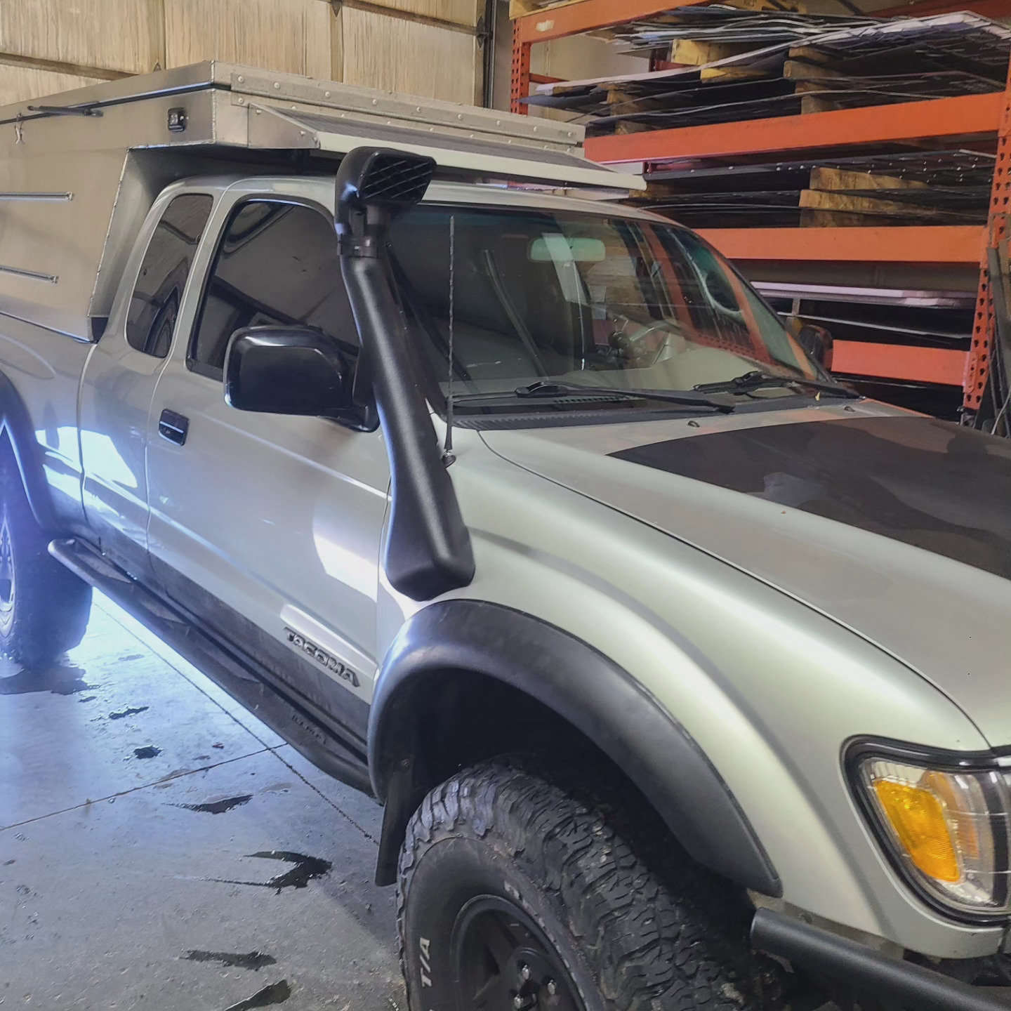

    Another happy customer.
