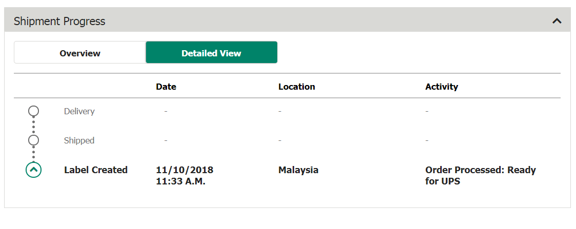

    Initially, it told me it would take over a month to get here...then a couple days later I got a tracking number saying it would arrive here less than a week after I ordered it. I think I ended up getting it in 6 days and it says on the packaging that it came from Malaysia, crazy.

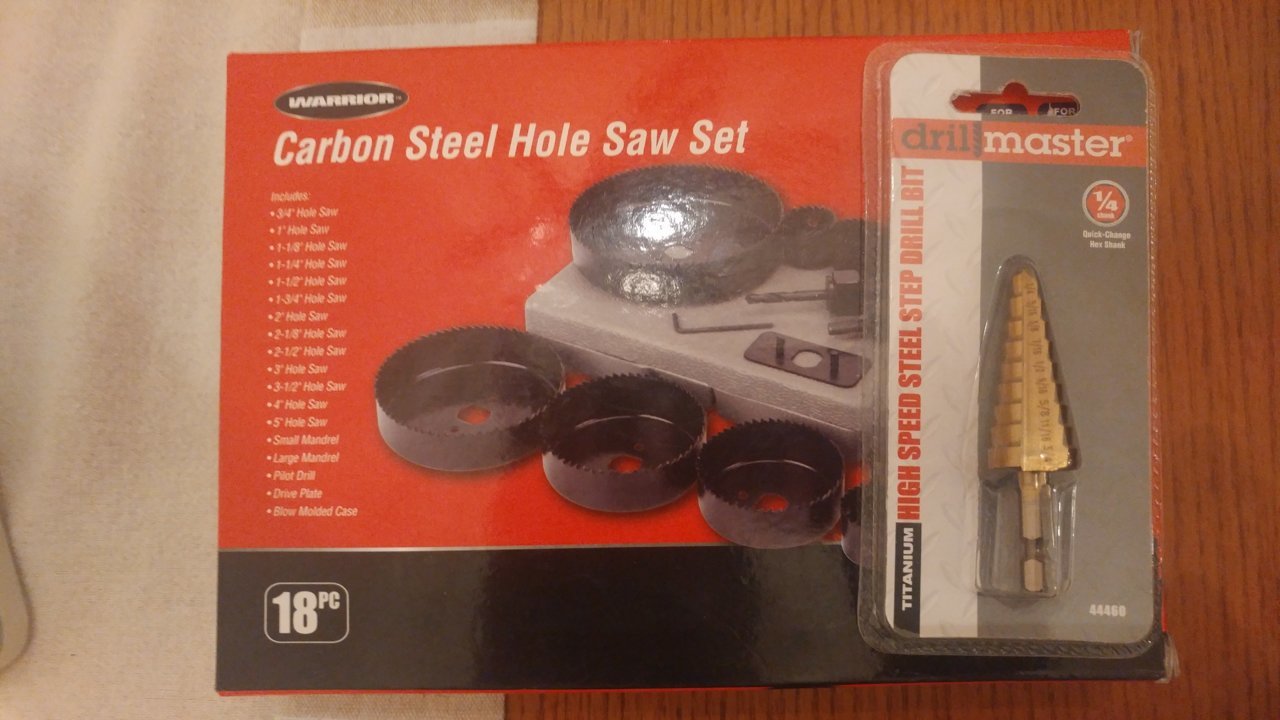

    Yeah I submitted black when I first joined TW but quickly learned it isn't worth the time or effort.
    Anyway, picked up a couple things from Harbor Freight tonight...ready for surgery/install tomorrow I hope.
    Wish they had a single 3.5" hole saw but only had one with this kit...at $15 though not a bad deal

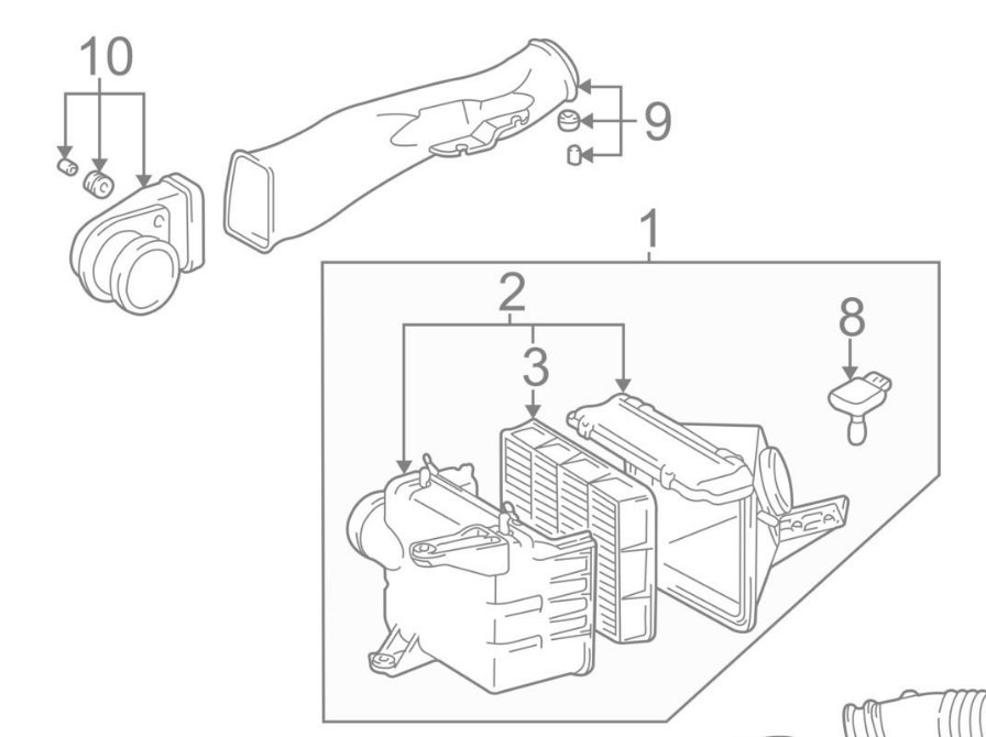

    Soo I appear to be missing the OEM air intake hose that connects to the air intake box inside the fender...
  19. Nov 11, 2018 at 11:41 AM
    #159
    eon_blue
    Mar 4, 2016
    #180213
    69,768
    Azusa, CA
    I'm missing parts 9 & 10 in this diagram...
    anybody know the actual part names?
  20. Nov 11, 2018 at 12:04 PM
    #160
    eon_blue
    Mar 4, 2016
    #180213
    69,768
    Azusa, CA
    Nevermind I figured out what the names are...missing the intake duct and the air duct. Fuck me...lol. That's odd.
    Can't get them from Toyota Parts dept. until Tuesday due to Veteran's Day.
    Any one else run into this? Wondering why the hell this is missing...
