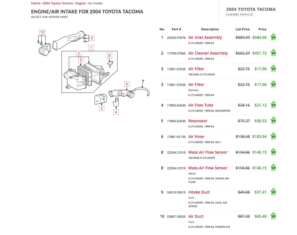

    yeah I'm thinking the PO did it when the supercharger was put on thinking it would make some kind of difference

    whatever the reason for it, it fucked up my plans to put my snorkel on today so I'm peeved, lol. Was thinking I'd just install the snorkel anyway and hook it up to the air box later, but now that I think about it I don't think I can do that...cause the fender has to come off to install the OEM air tube. I guess I could but having the snorkel bolted to the A pillar will make it more of a hassle.

    If I remember correctly, you shouldn't have to remove the fender to put those parts back in.

    cool thanks, yeah someone in another thread just told me the same thing so I'll go ahead and try to get the snorkel on today and hook it up later.

    Yes, fender doesn’t need to come off. Even in instructions we don’t mention or show the fender off for the install. You will however need to unbolt and possibly take out your airbox for the curve tube install. Don’t forget to get the hardware for those two missing tubes too. Should be two bolts for each piece. How long have you had the truck for?
    You can still do the majority of the install if you don’t mind taking off the snorkel again later.

    The air box has to come out to install the air tube? In another thread they mentioned it could be done just by reaching up into the fender and bolting the curve tube in place.
    I don't mind having to take it off again just trying to minimize the extra work due to these missing oem parts

    I said possibly since I’ve never done it. If anything unbolting the airbox would be required.

    Well at the very least, today I'm going to attempt to accomplish getting the damn snorkel on, lol. I'll count that as a victory, one win at a time...hopefully by next weekend I'll have the missing airbox parts.

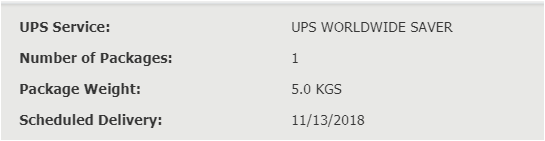

    Received UPS notification email on the 9th, tracking still shows 'shipment ready for UPS - label created'. email notification had this info:
    Not sure how it's supposed to be delivered on the 13th when it still hasn't technically been picked up yet... lol
