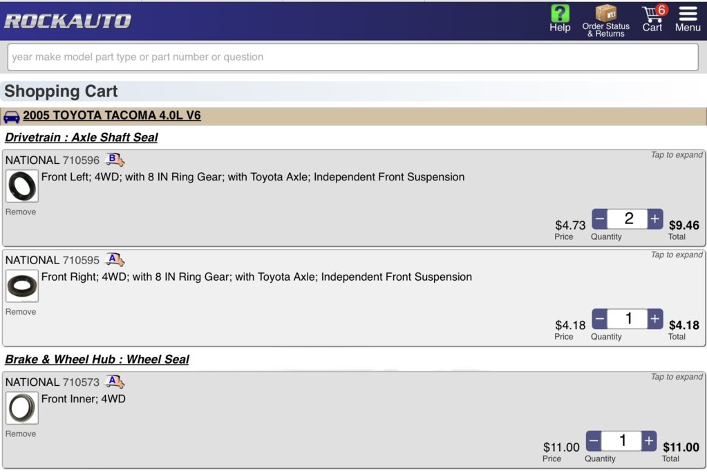

    For when it leaks:
    National P/N 710596 LH https://www.rockauto.com/en/moreinfo.php?pk=1927202&jsn=266
    National P/N 710595 RH https://www.rockauto.com/en/moreinfo.php?pk=2480322&cc=3441741&pt=1860&jsn=11
    On older trucks, rust jacking may develop between the diff case and seal OD. Before installing new seal, be sure to sand the bore smooth. Optionally put some sealant on the seal OD before installing.

  14. Aug 29, 2025 at 7:24 PM
    Subway4X4
    Subway4X4 Shameless Copy Cat
    Nov 10, 2015
    #169260
    11,668
    Lloyd
    NY/NJ
    05 Speedway Blue DCSB OR TRD
    Everything TW members recommend
