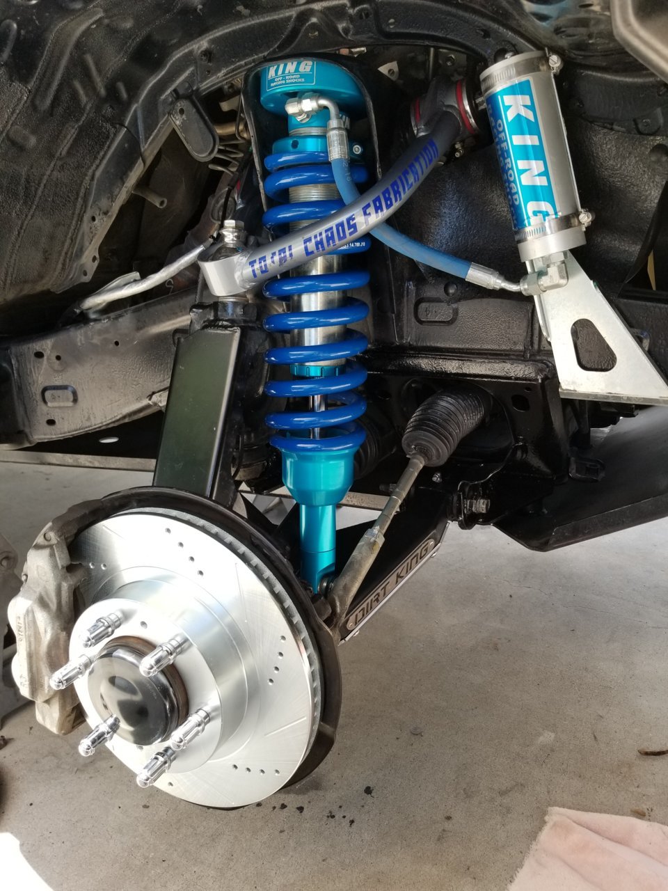

    Got new DK lca’s for my tacoma and they require red loctite. I only have blue and I can’t find any loctite 271. Would blue work? If not I found 2701. I’m in the Middle East so this stuff is hard to find.
    So would 2701 work? Thanks.

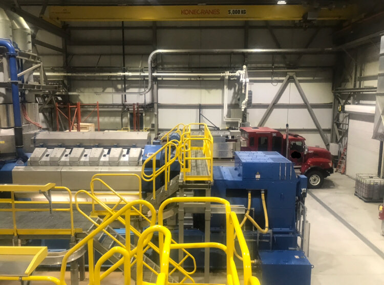

    My guess would be aircraft construction or very high vibration machinery. Even more vibration than my Babies cause I have yet to see it on them in use lol.

    MTU genset? I used to tend to a set of PC2.5 gensets.
