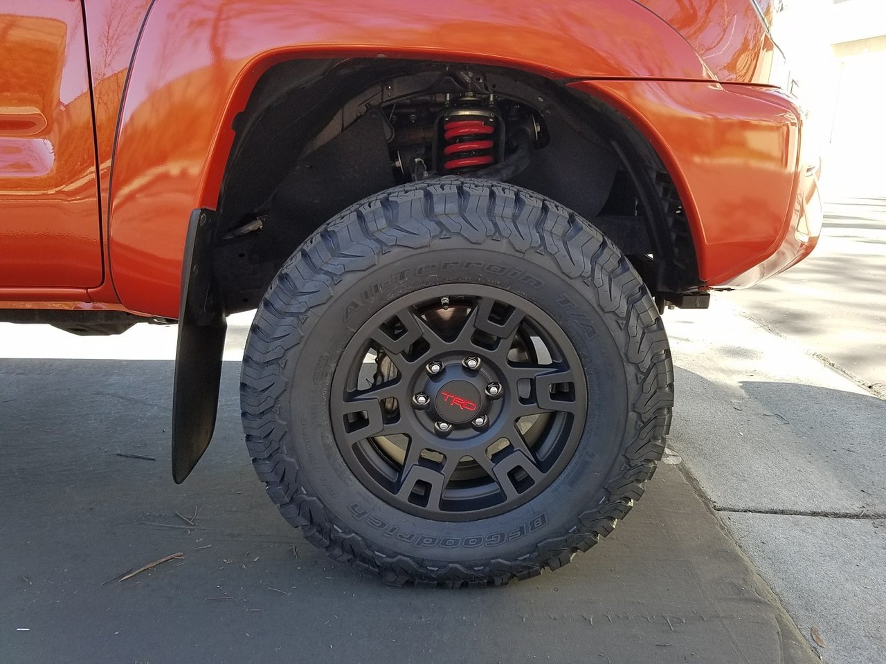

    2004TacoBill
    2004TacoBill Well-Known Member
    Aug 5, 2017
    #226019
    176
    Here's a couple updated photos with new Pro 17" rims and LT265/70/17 BFG AT TKO2 load range "C" tires.......

  12. Feb 18, 2018 at 11:12 PM
    #352
    2004TacoBill
    Aug 5, 2017
    #226019
    176
    I think it's almost perfectly level......maybe it appears nose high in the photo. I haven't measured it but it's close enough for me!..>LOL.......the set-up is perfect for me....not too harsh and not too soft......good all around feel for a mall crawler!......look how clean the wheel well is.....this thing hasn't even see a dirt road!

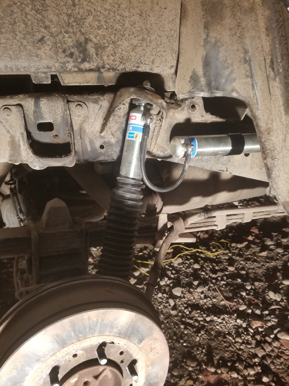

  20. Feb 19, 2018 at 6:31 AM
    #360
    Crgrey42
    Crgrey42 Well-Known Member
    Oct 29, 2015
    #168033
    396
    Cory
    CNY
