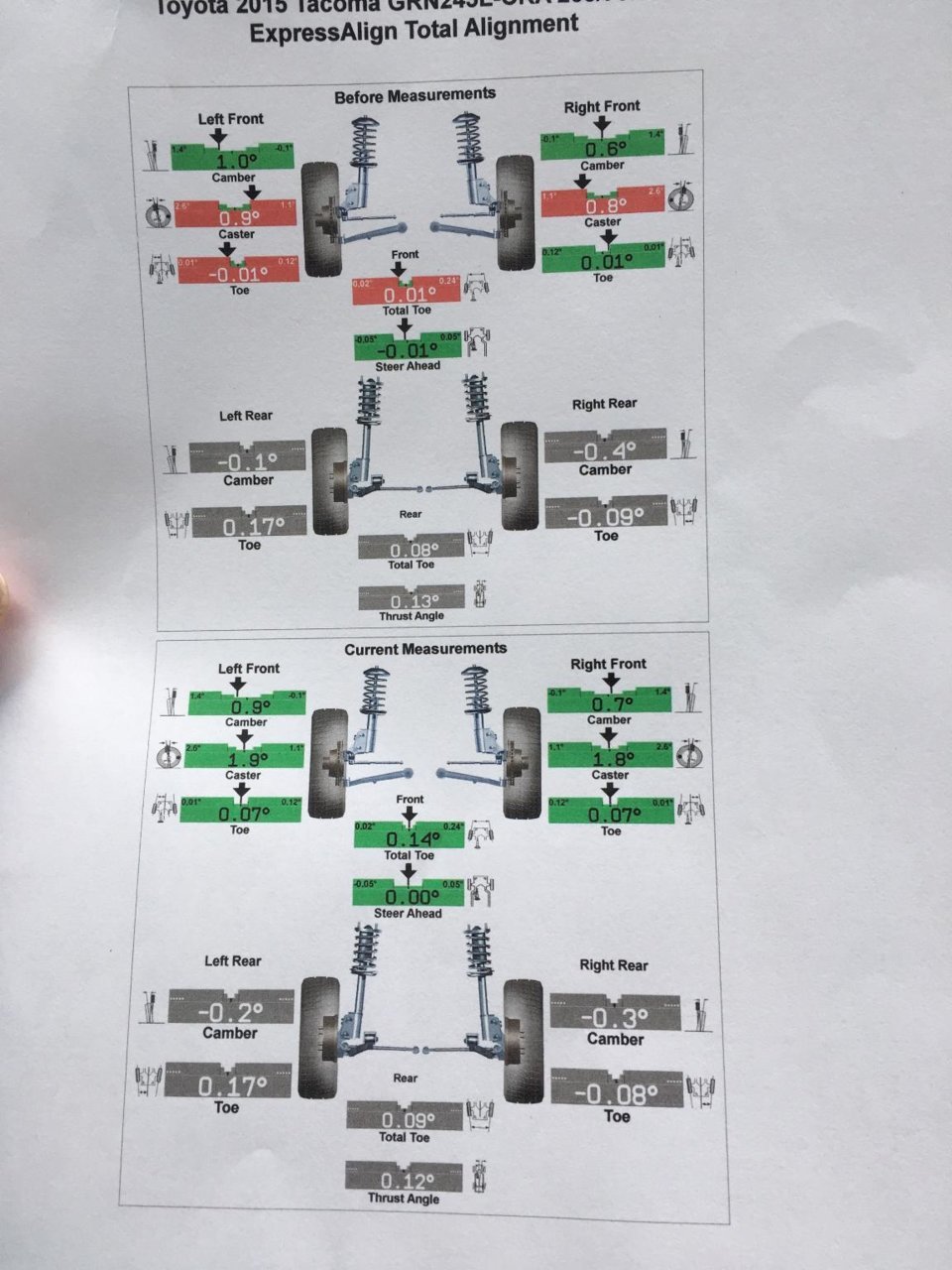

    Thought on these alignment numbers ?? Installed TRD Pro Suspension with HS 1/4 inch top plate spacer and Wheelers Offroad 2 inch add a leaf. The truck is a 2015 Access cab v6 manual

    Toe looks good, but to me, your camber needs to be 0. Your caster is low for my liking as well, but you're gonna lose even more caster to fix the camber. Based on what I'm seeing you're gonna get some accelerated outside tire wear, so keep up with rotations. If it drives nice to you, that's what matters. Just know it may be a little twitchy at times due to kinda low caster for a lifted truck, and that outside tire wear may be accelerated to some degree by the camber. Other than that, it's good that everything is relatively symmetrical.

    That looks pretty good! Tough to get any more caster out of stock UCA with this lift. I got 2.0 and 2.33 caster with similar camber .. i like how the truck drives. no bump steer and tracks straight on the highway. I rotate my tires often so no worries about tire wear, they always get destroyed before they get bald anyways.

    Thank you both !! The lift only has 25 miles on it so once it settles there will be another alignment !! Time for wheel and tires

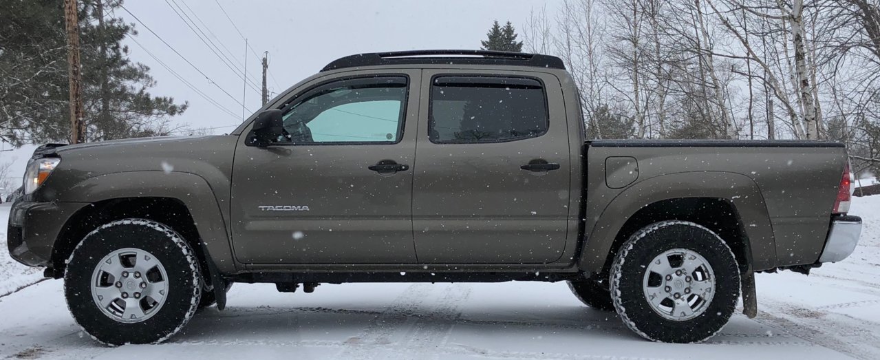

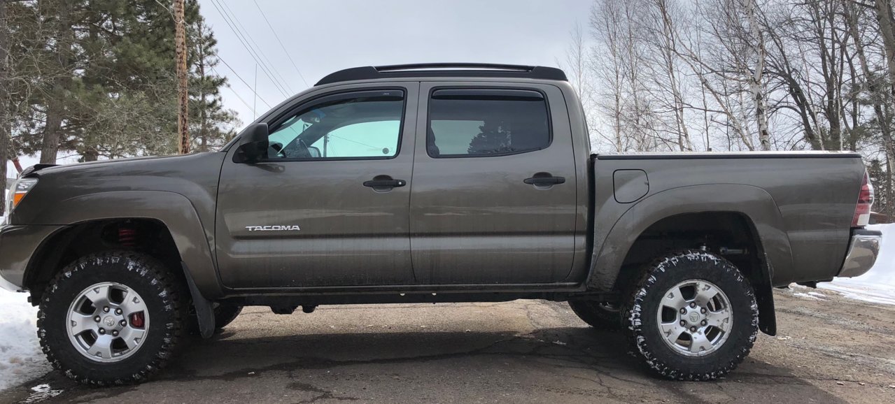

    Just emptied my bed today so now there's no weight. After a couple weeks and a few hundred miles, I'm still measuring:
    DF - 22.25
    PR - 22.25
    But gained 1/4 inch in the rear:
    DR - 24.25
    PR - 24.25

    Good looking stance @sioux
