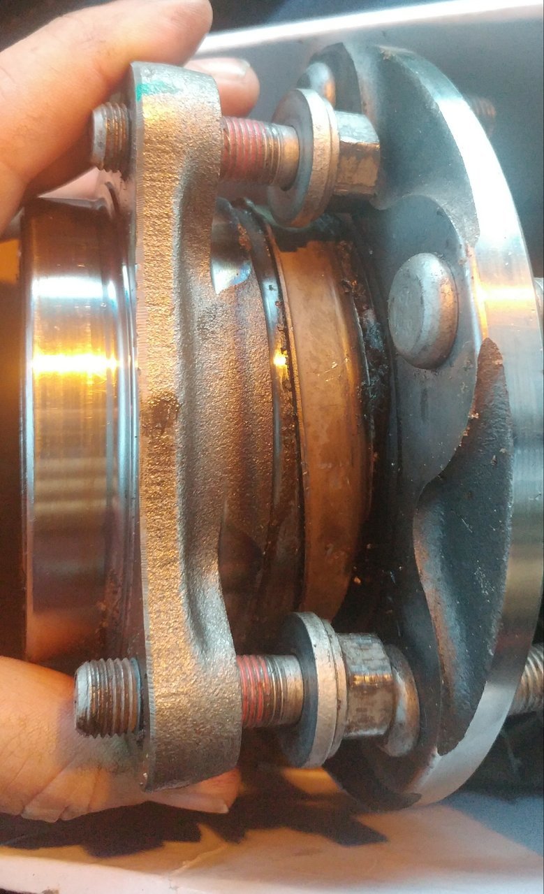

    I also has to replace the Caliper, Pads & Rotor since the bearing failure caused rotor to dig into Caliper & ate the Brake Pads. The new Bearing easily fit back in, Life was good.... Not so much. The Traction Control & ABS lights stayed on, thinking that they should go off in a couple miles, I drove it to work, by end of day it felt & sounded like the Wheel Bearing was going out? Impossible, it's brand new.... I made it 300 miles total on 2nd day before it rapidly got worse until I finally determined the BRAND NEW Wheel Bearing had failed....another Tow Truck to get me home. Tear it down again....

    Thinking that this has to be a fluke & I just have bad luck....I ordered another ($197) and installed this 1....luckily they have a 1 year warranty. But....Traction Control & ABS Lights are still on....this worries me.

    Those bolt heads on your replacement hub look chewed...what are you using to tighten/loosen them, vise grips??

    The ABS sensor is likely damaged.
    Those assemblies are cheap, and built cheap as well. I wouldn’t trust the lock nut is torqued properly.
