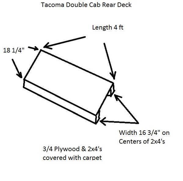

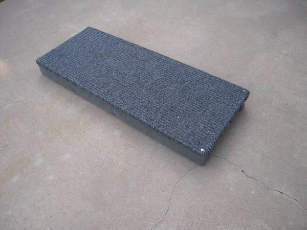

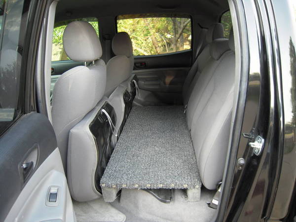

    Figured I'd make my 1st post a productive one so I've added photos & plans for A Removeable Rear Seat Deck I Custom made for my 05 Double Cab. Needed a better way for my Hound Dog to ride with me & works great for gear I don't want on the rear seats. Enjoy!

    Cool project! I can't tell from the picture but do the front legs rest flush on re floor? They look like they are hovering a few inches above the floor.

    The front 2x4 rests in the hinge of the seats & cradles the carpeted 2x4 perfectly. It easily supports my 70+lb hound jumping around in the back & stays securely in place...and it's easily removed If I need to carry passengers in the back. I've been using it almost daily since I got the truck new in 05. BTW the carpet is cheep outdoor carpet runner from Lowes and was adhered to the deck with carpet cement & stainless screws around the edges.
