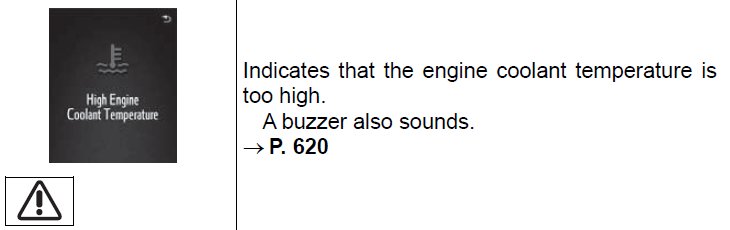

    Im surprised the truck doesn’t chime or flash a light when it reaches near dangerous temps.

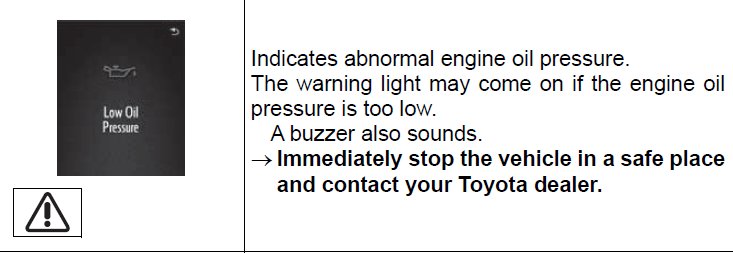

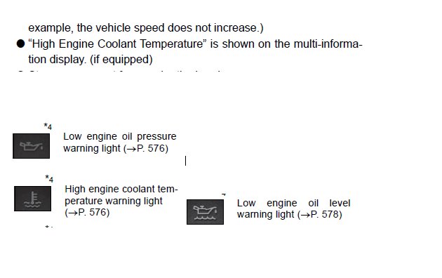

    I an addition to the coolant temp needle gauge, with a red zone, there are these indicators, that I believe also have a chime.
    I am only guessing here, but I would think many overheating situations are exacerbated by some thinking they can make it home/to the shop,,,, or not wanting the expense and inconvenience of the tow. I know I know, there are times people hit something, causing a sudden oil or coolant leak and it is not safe to pull over. That is not who I am talking about though, I am referring to the ones that acknowledge the lights and sounds, and take the gamble, truly don’t understand,,,, that any engine cannot make it seconds without oil, or minutes with excessive temps.
