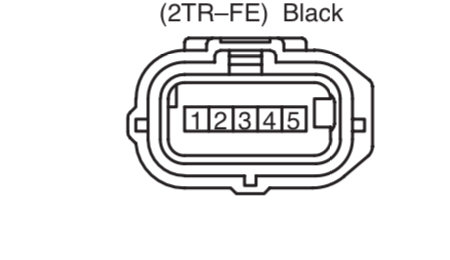

    You likely have a wiring issue.
    The p0102 is for low voltage at the MAF.
    Check pin #1 for battery voltage.
    It should be a blue/white wire

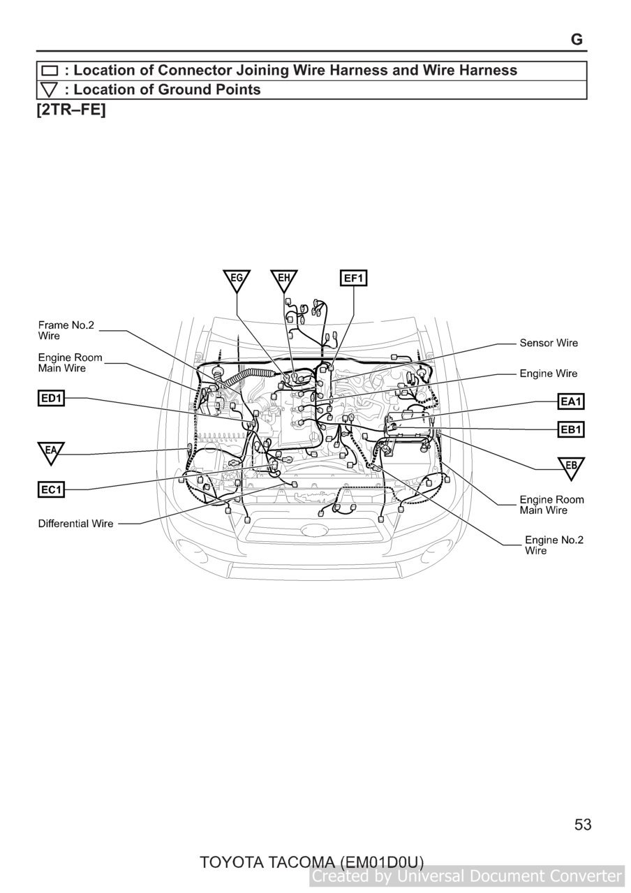

    Since your getting a MAF code along with an IAT code I'd suspect a bad ground at the MAF sensor (Pin 5 Brown), have you double checked that all the ground wires (the ground wires at the attachment points are White/Black) are reattached?

    I’ll double check tomorrow, I’ll use that diagram and double check all the grounds are solid and connected pretty sure but I’ll check, thanks for diagram,
