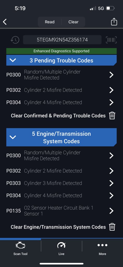

    Hey guys. I just rebuilt the engine in my 04 prerunner with the 2.7 (Long story on that). Well I finally got everything hooked up ready to start today. Bear in mind, this truck hasn’t been ran in close to 2 years if I had to guess. I used all the old electrical parts that the other mechanic left with it.
    Let me preface this with I’m confident this thing is timed right. Tried to crank it, it will crank and go dead. Hold your foot on the throttle and she will run but it’s very rough. And you can forget idling. Put the computer on it and several codes popped up. I’ll put up a screenshot and you can see. Have a look and tell me what you think. I hope I haven’t screwed up. Thanks again everyone

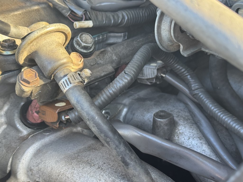

    I know the coil wires are in the right order. However, I’m not sure about the injector plugs. There’s two gray connectors and two red connectors. I was guessing when I plugged them up

    Ensure that your fuel injectors are hooked up correctly. The back 2 are relatively easy to get correct but very easy to mix up the front 2.

    My front two are right. #3 has a red plug and #4 has a gray plug? Could you check yours please?

    O3 Tacoma. Manual hubs Bilstein 5100 in OME 885 springs. Rear Wheeler off road 5 leaf springs. Northwest trails innovation winch bumper & 10k winch. TRD rear elocker and front 7.5 truetrac limiter slip. Built 2.7 3rz, balanced, 1mm bored, 9.75-1 compression, LC cam, 1mm oversized valves, LC 35 lb flywheel & LC clutch, ported head, balance shaft delete, bored throttle body, header & 2.5” exhaust.
    Staggered brown gray brown gray
    #1 brown
    #2 gray
    #3 brown
    #4 gray

    Same here. Atleast that’s right. I just looked at the cam sensor when I had the cover off verifying the timing. It looked good. I haven’t looked at the crank sensor though
