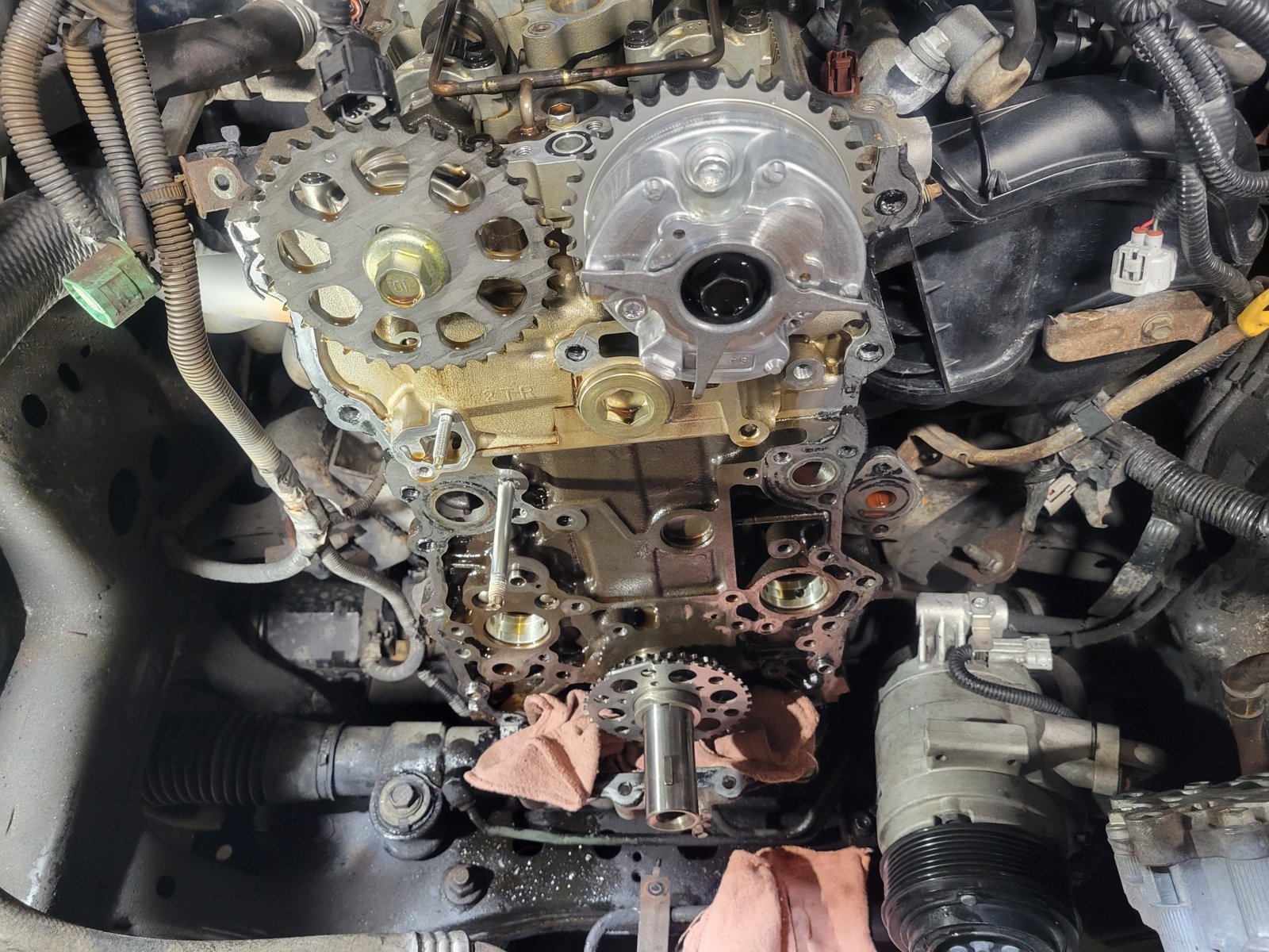

    Well that was a fun second time around:
    I just replaced the timing chain and balance shaft chain, since the balance shaft chain was making noise under load (the chain ended up being stretched, causing the noise). Well when I got everything back together, it sounded like my truck had a supercharger! There was a whine at any RPM.
    Now that I had to go back in there again to solve the noise (which ended up being the gears that drove one of the balance shafts), I bought LCE's balance shaft delete kit. I wish I did this the first time around! So much simpler under the timing cover!

    How's the idle? Seem like more vibration?

    Idle is roughly the same, driving I can feel something in the pedals and steering wheel, but it is very minor (I only have about 5 minutes of seat time, as I was at work for 12 hours wanting to finish this in one day). Honestly, without driving it more, I am not sure why Toyota put balance shafts in the first place, the truck feels exactly the same!

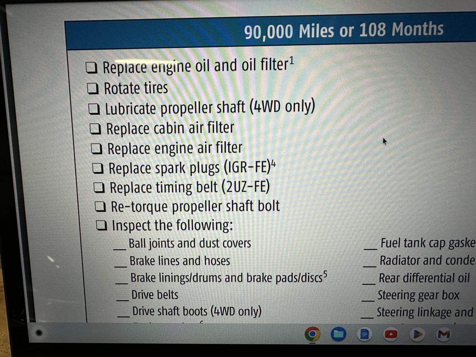

    Has anybody done the timing belt & wp on a 4.7? My brother just bought a 2007 Tundra and theres no record of it being done within the last 100k

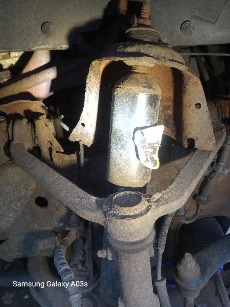

    This was the death of the danger ranger

    The belt should be done at 90k.

    WHYYYYYYYYY is he 4 linking a trailer.
    I would make a new mount but all the other mounts are crusty so its not worth it. I wouldnt be able to axle swap it for a few years so I dont think I could get away with a ugly white yard ornament for a few years. Oh well.
