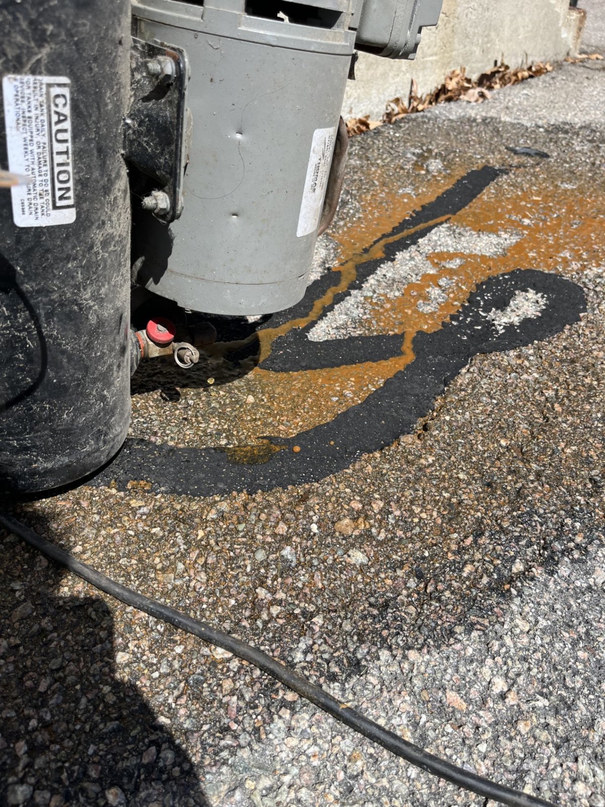

    Hey,
    Seems like the compressor is not working right...can you take a look?
    Umm....when is the last time you guys drained the moisture?
    The what?
    Literally 5 gallons of water in a 5 gallon compressor...
    Already procured a new compressor and show people how to drain it...

    I'm sure that was also great for whatever the compressor was powering

    It's only used for compressed air to clean out thing and dry things off.....industrial canned air...

    Yeah, let's use wet air.
    People.
    Edit...just to be clear, I didn't mean you Brian

    Wet air flows in the hose better cuz it's self lubricating.

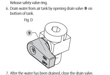

    New Dewalt has them
